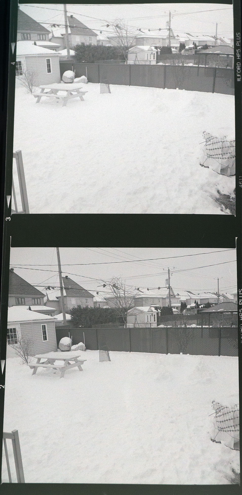

Today's a pretty dull day in the Montréal region, so I went out in the backyard and shot a test roll. Here's my logic:
- In 120, I really like HP5+ in DK-50 1+1. The developer gives me sharp images with brilliant highlights, while the film maintains good shadow details.
- My normal regimen in to expose at EI 250, and develop for 5:45. I have a couple of images of this combo in my gallery.
- Today, I set my spot meter at EI 400 so that the shadows would receive less exposure.
- I am also going to develop for 7 mins, which is 20% more time than my usual 5:45.
- When I metered, I tried to place snow as high as I could (Zone VI or VII). That's one to two stops above the meter's reading when pointed at the snow. I also checked my exposure by measuring other items in the yard (fence, table, etc.)
- I bracketed exposures, and made two series: one without a filter, and one with an orange filter (3x factor).
That's about as much as I can do in-camera. In the darkroom, I should have latitude to dodge and burn specific areas to get the detail and the tones where I want them.
Another idea that popped into my mind as I wrote this, is: if possible, why not just use flash? Of course, it doesn't work for a wide expanse of landscape, but if you're shooting something at close range, adding some fill-in flash (especially if it's offset from your camera) could give you better texture detail.

I'm just upstairs in the 'burbs, but it's still the MTL area! So I processed the film, and while I haven't printed yet, I had a good look at it on the light table. I would say that the orange filter seems to have been the most effective tool.
Looking at the bracketed exposures, even pushing the snow higher up on the film curve doesn't seem to change much. However, the filter will deepen the small shadows that make up texture and help with the impression of volume.

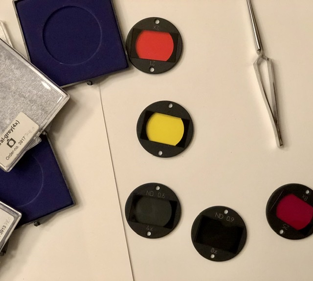

Yep, quite a lot of snow to test, and the light is nicer than the previous days. It's brighter, less grey.
Nice! I didn't have any spare small yellow filters l but I had a look on eBay and found one of those Noblex gel filter holders.
We have lots of snow today so perfect conditions for testing the tmax film :smile:

I think I'm losing my mind. I found this in my parts box today - yellow AND orange
:pinch:
Negatives on a light box would be really helpful :smile:

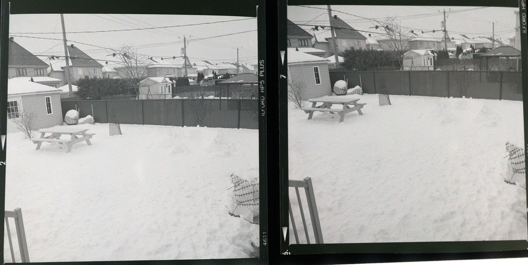

D'oh indeed. Here's a quick shot of the negatives. On the left, no filter; on the right, orange filter.
The difference I see is with the texture of the snow, lower-right of the image.
On the left one it's near-featureless; on the right one, you can see a bit better the little pellets of snow on the ground. My picnic table is blue, so it appears a bit darker with the orange filter. Otherwise, the exposure is the same between the two (i.e. I compensated for the orange filter by 1.5 stop relative to the first one).
All the usual caveats about reproduction apply, but I can confirm on the light table that there is better tone separation with the filter.

As a cross-examination, here's the first negative (no filter) with base exposure (below) and 1 stop more exposure (above). Same amount of detail.

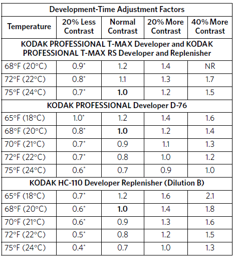

Interesting comparisons, thanks for posting those. So you think the difference is entirely due to the yellow filter and not a variation of the exposure ? The entire scene looks darker and I wonder if the filter factor might not be exact for that particular film and developer. When I was trying to figure out the filter factor yesterday, I noticed that both my yellow #8 and orange #21 indicate a factor of 2x (1-stop), but that the TMAX100 datasheet recommends only a factor of 1.5 (2/3 stop) - the Kodak datasheet also mentions that the filter factor value varies depending on the film. If you reduced by a full 1.5 stops could you have underexposed it by ~1/2 stop making the negative a little thinner and the image just a bit darker ? Or do you see more tonal separation and detail on the light table with a loupe? Regardless, your film and developer combination seems to produce much better tonal separation in the highlights than with my Xtol/Delta100.
I went out yesterday and shot 4 test rolls; 3 using TMAX100: 1 at box speed + normal processing, another at box speed but with the yellow filter, and one underexposed at 160 that I will develop with expansion, all 3 using tmax developer 1:4. I also included a roll of my Delta 100 processed at 80 in xtol for comparison. I'll try to develop them over the next day or two.

So if I understand the chart correctly, if i want a 40% boost in contrast, I need to use at least a development temp of 72F and multiply the base time at 1.0 at 75F by 1.7 ? So roughly 10½ minutes at 72F ?
