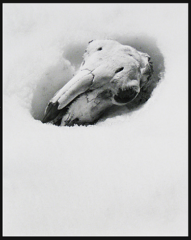

Here, the sun was out, but I had a full range of tonalities to play with. 4x5, no filter, 16x20 silver gelatin print. Nice texture in the snow that may not come out in this reproduction.

Nice job printing that. The high lights can easily go gray and can be hard to keep white.
Thanks Sirius. It took a lot of effort to get detail in the footprints and shadows in the curves in the snow banks, and the snow is very grainy - the final print is far from satisfactory. I really need better negatives in the future.

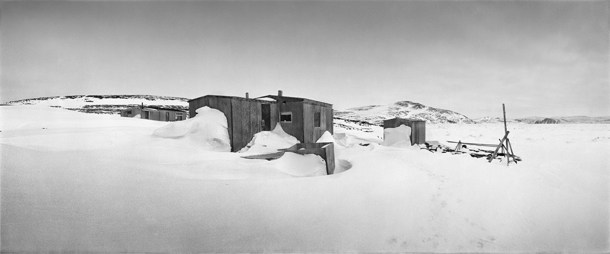

I'd do a roll at +2 process - and probably bracket in the direction of less exposure from your current working EI. Hopefully that'll outflank your needs & any refinements should be simpler from there.
Are you using a Noblex 150 or something like that?
Great eye - yes that was taken with a Noblex 150UX :smile:

Where was that taken? Are those fishing homes by a lake?
