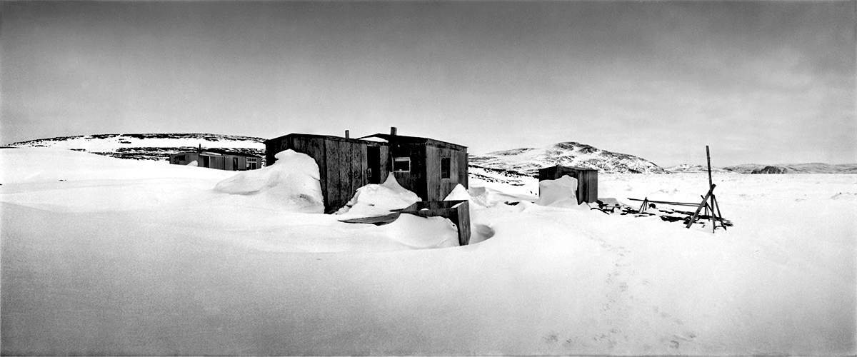

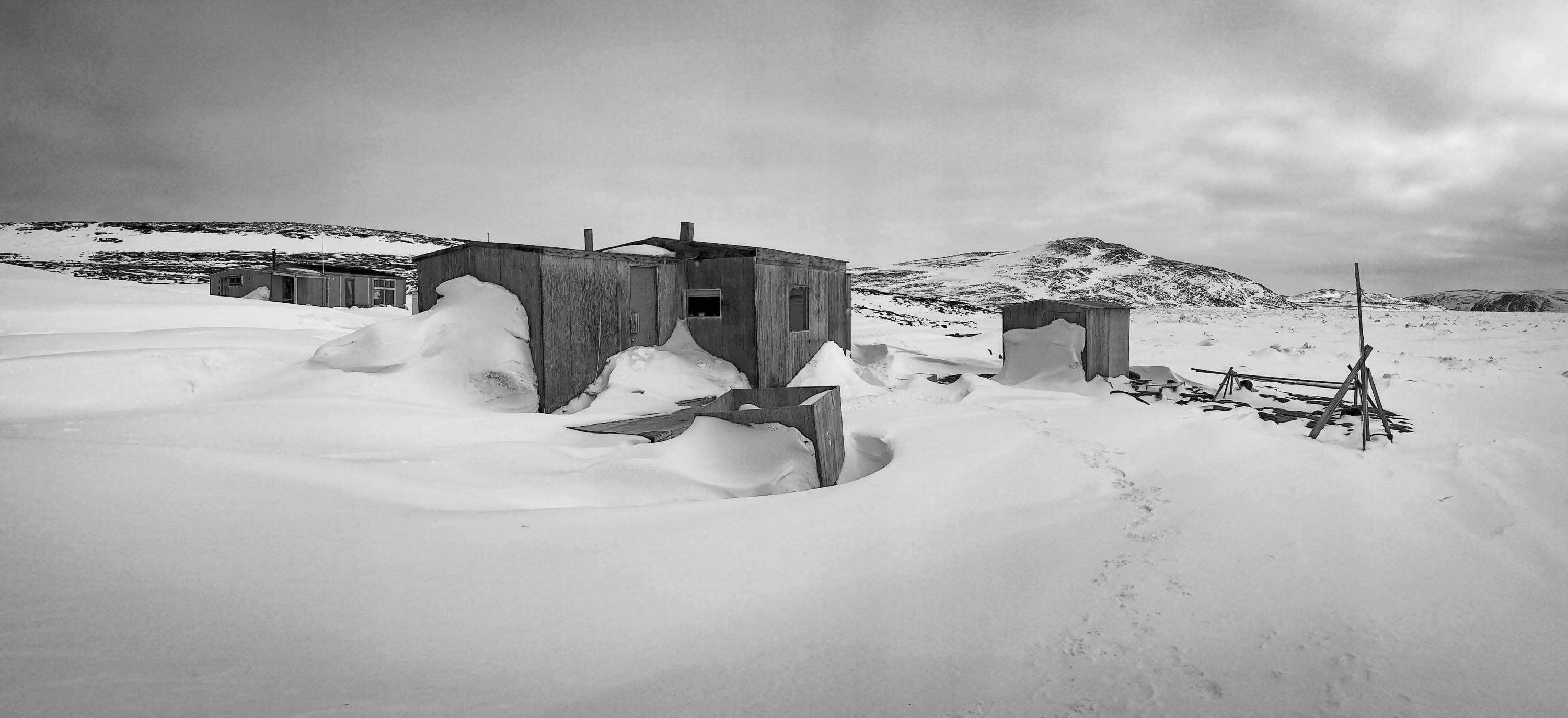

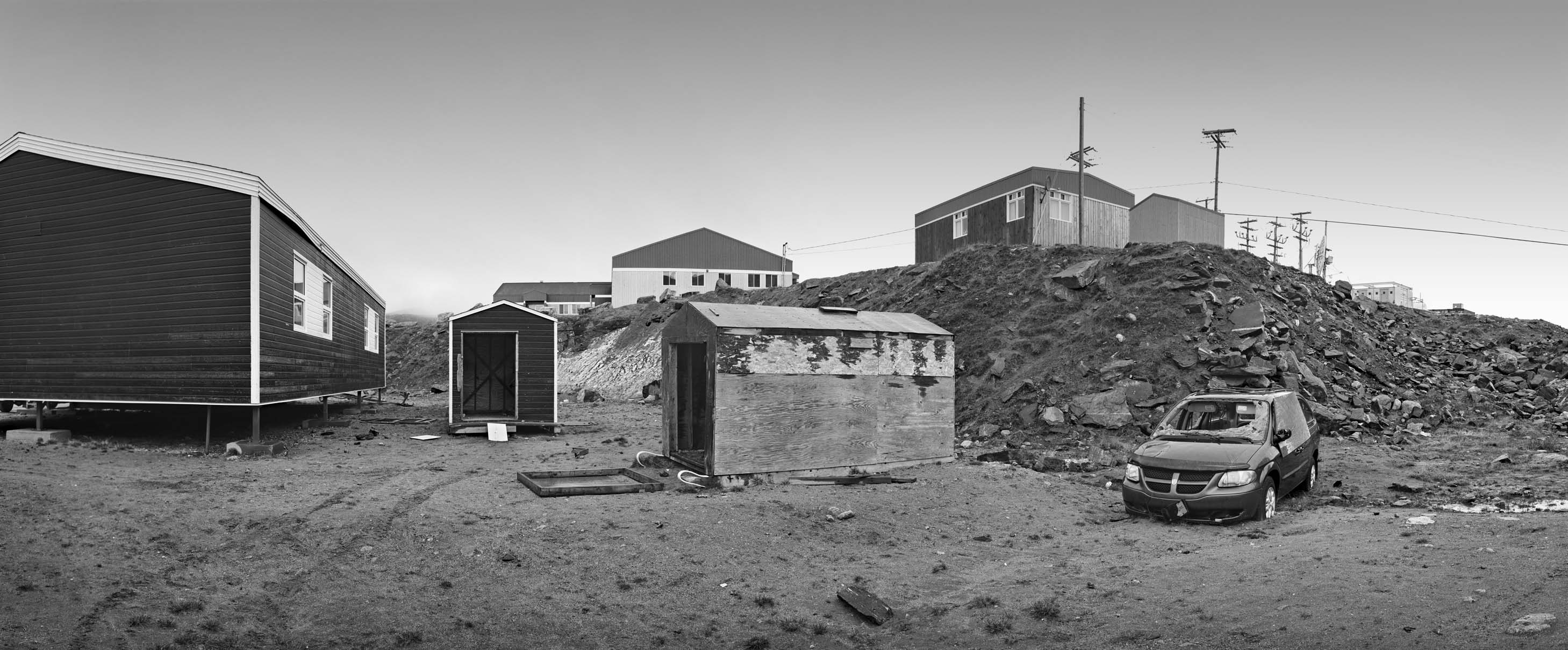

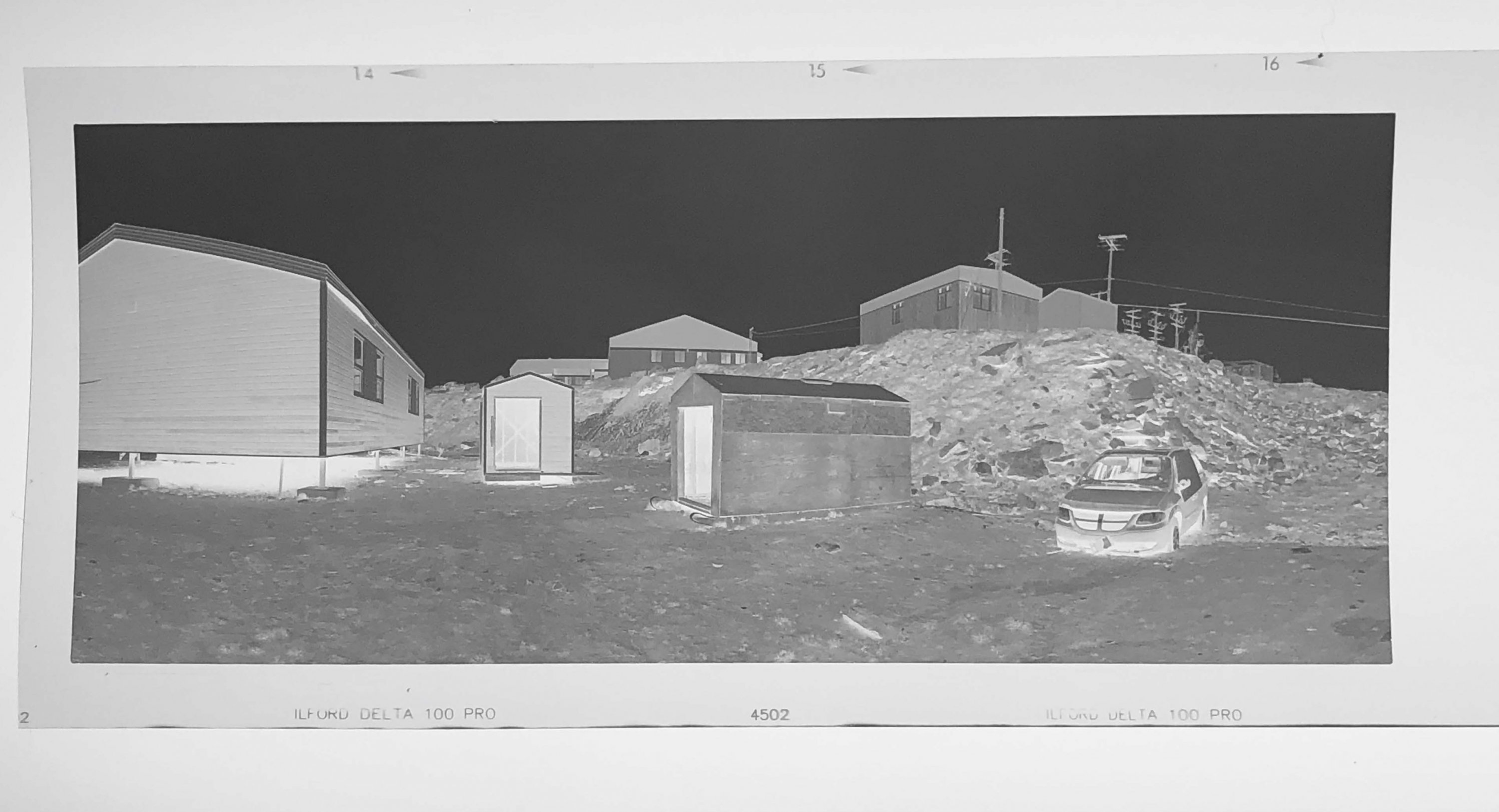

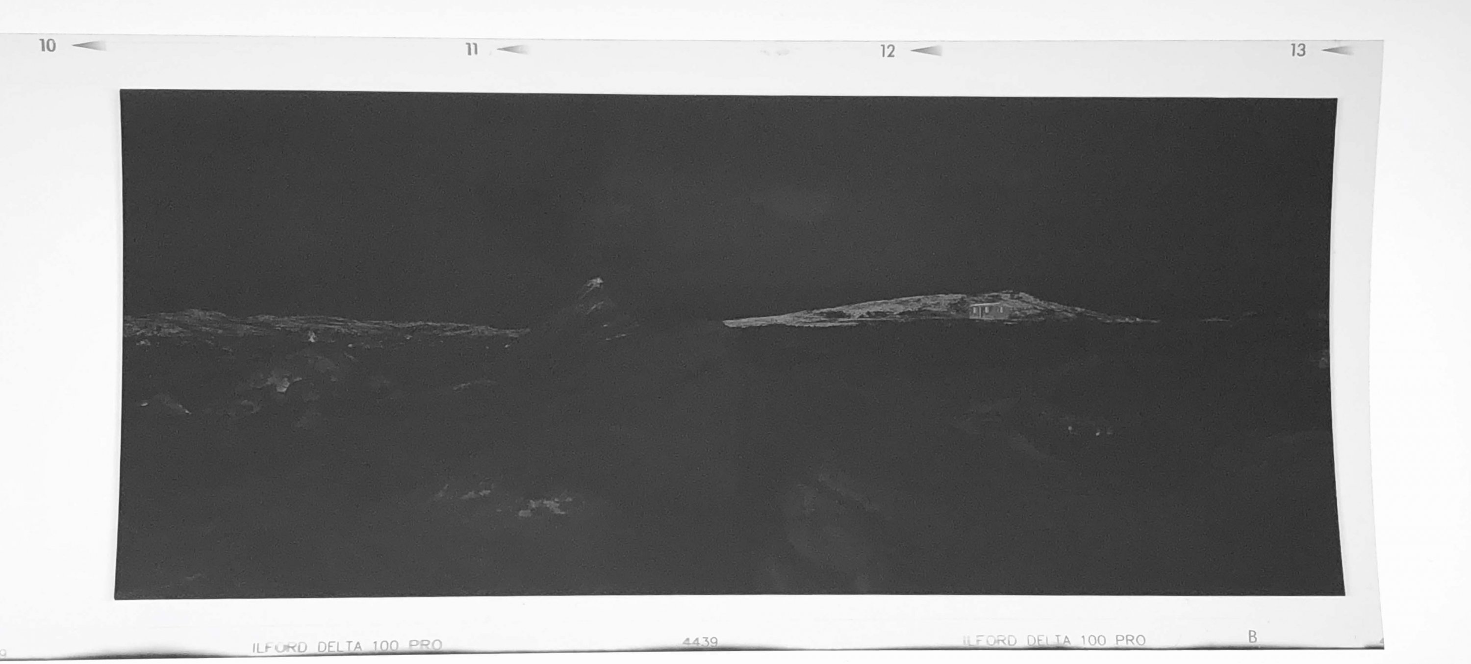

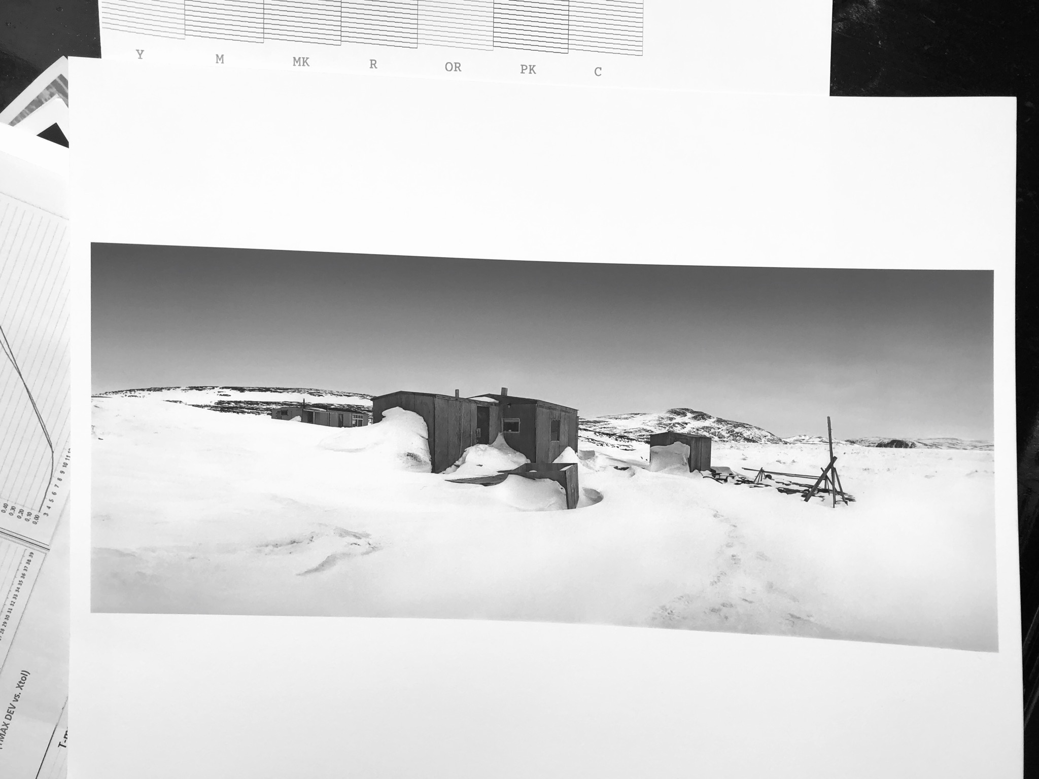

I'm attaching some sample images of my negatives (1 good and 2 bad) with their corresponding prints, along with mock ups i originally took with my iphone.
This is a well exposed/processed negative (ei 80, xtol)
And the processed image :

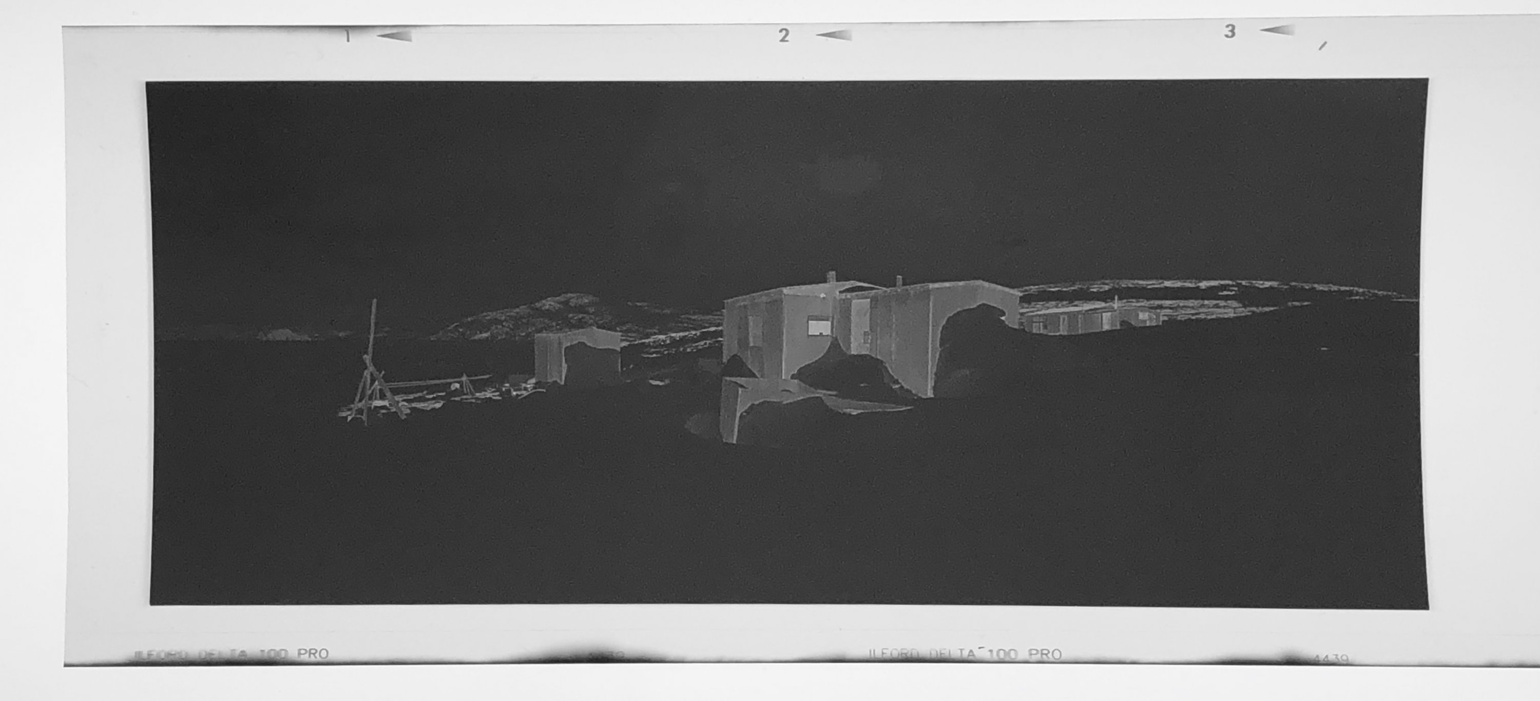

This is one of the PROBLEM negatives, lots of snow, clouds, very little contrast.
The Processed image after scanning
The iPhone mock up - which has much more detail and contrast in the snow

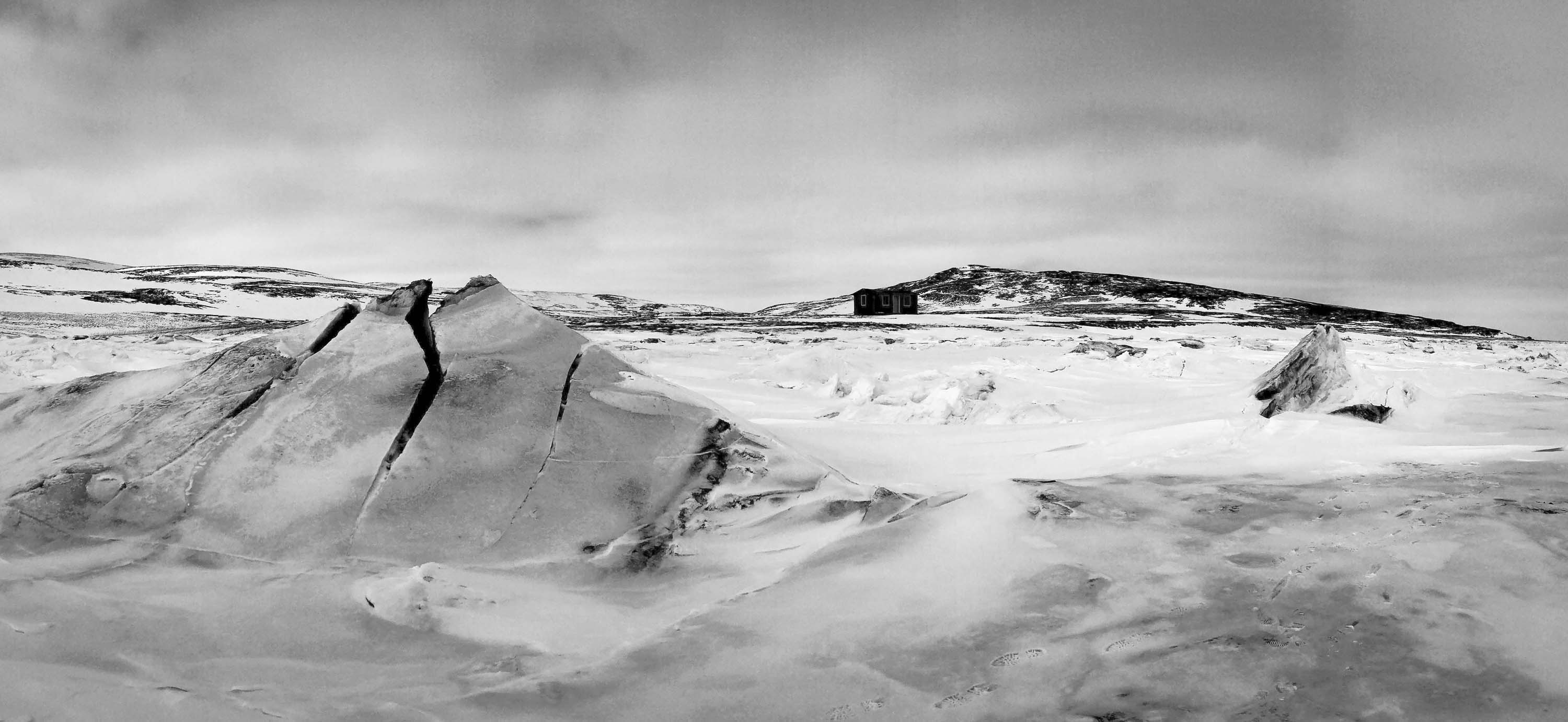

Second problem negative of frozen bay with large ice structures, cloudy sky lots of snow.
The scan is so flat I just don't have anything to work with. Here is the iPhone mockup
So despite the very flat lighting conditions, the iphone is still capable of capturing a fair amount of texture in the snow that I can barely capture on film...
The densities of the bad negatives look darker than they acutally are, the density of the skies are about the same as the good negative.
This tells me that you are over-exposing. The highlights in the skies are in the shoulder, and the mid-tones and shadows are crowding up against them.
Yep, the lowest shadow densities are way above base + fog.
So definitely overexposed and not overdeveloped ? Is my first negative also overexposed ?
First neg is fine - deepest/ black shadows & film base+fog are same density. Other two negs are maybe stop + over. I wouldn't necessarily go trying the contrast expansion processing if the first neg is close to what you are wanting tonally. The only immediate thing I can suggest (if everything else is the same) is that the cold is making the voltage from the batteries drop in the Noblex, the drum runs slower & thus overexposes - or something atypical like that
Looks like some overdevelopment too, it can be a tricky balance between exposure and development when trying to expand contrast on really flat scenes.
