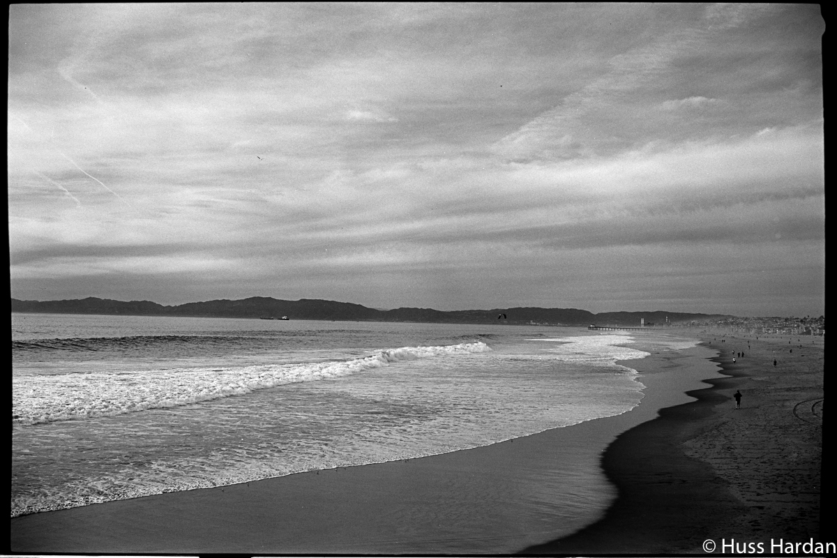

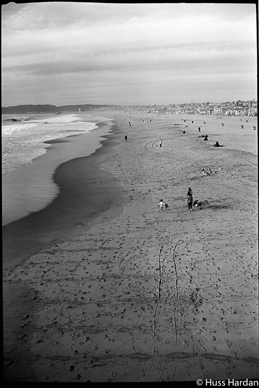

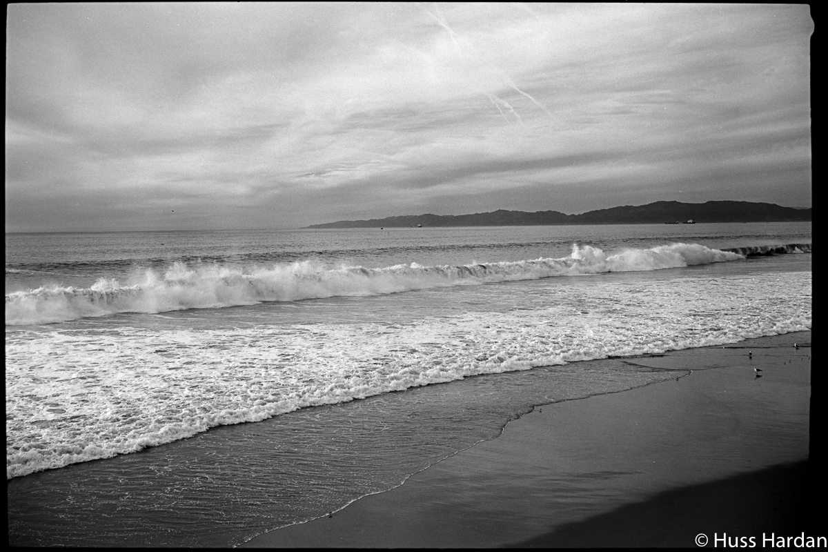

Ok. So my film is back. Result? This is a wonderful film with gorgeous tones that SHOULD NOT BE DEVELOPED IN MONOBATH!
Highly recommended, congratulations Shanghai!
This pic was taken with no filters. Did not need any to pick up the details on a cloudy day. What you are seeing is the remnants of a tsunami coming ashore, from the underground volcanic blast off the coast of Tonga.

Glad you like the results! It was worth it for me to waste 2 rolls to figure out what works!

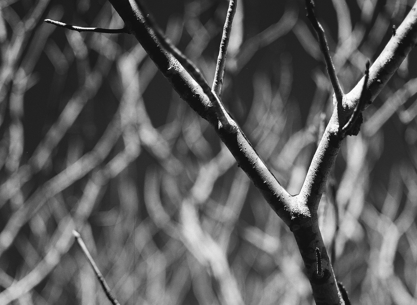

I got my scans back from the lab, and I'm really happy.
Negs haven't yet arrived by snail mail, so I can't comment on scratches, but there appears to be one at bottom left.
Shanghai 100, 220. Lab processed in D-76.

I see the scratch. You can easily fix that in PS.
True.
However, I am a (mostly) analog printer.
The main premise of this thread is QC of Shanghai 220 film, so this was presented for objectivity purposes.
I look forward to receiving the actual negatives for closer inspection...the scans are probably not the whole story.
