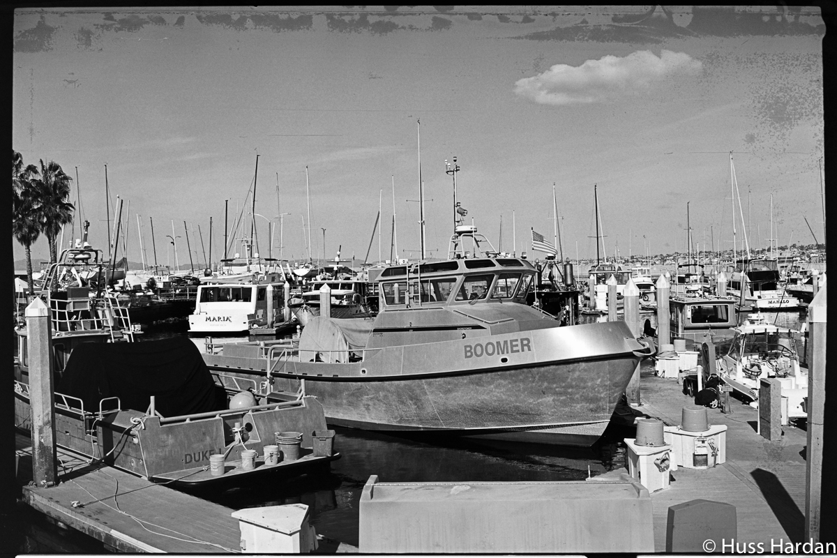

Well no, because as I mentioned I also shot a roll of Ilford at the same time through the same camera as a control. And also posted those pics in this thread.
But at the risk of being repetitive, you used a development regime that is non-standard.
And you revealed the cardinal sin :angel: of finger squeegeeing your film.
There is a significant possibility that the difference between the Shanghai film and other more modern competitors is that the Shanghai film benefits from little or no pre-hardening!

I'm being fully transparent as to my process, and earlier when I mentioned that I ran the film between my two delicately soft fingers, I did also mention the possibility that even though 'normal' films like those made by Ilford, Kodak, Foma etc are not effected by such a tender touch.. there is a possibility that the Shanghai film is extremely soft. Which is why I then said that the next roll will just be air dried with zero physical contact.
That of course still does not address those parallel scratches.

My experience and the community experience is that touching the film with fingers or squeegee runs a risk of emulsion damage. Many of us have learned that touching the emulsion is just asking for problems.
i would change only your developer, keep everything else the same and check your results then. I also ran a finger squeegee with my gp3 and didn't get the emulsion damage that you did. the only time I dont do any squeegee is when I reversal process as the bleach leaves the emulsion very soft. I expect that a mono-bath is hard on GP3 and is having a impact on your results. just because it works for most films does not mean it works for all films.
I understand that which is why in the monobath thread I list films that it is not good with. For example, with Silberra Orto 80 it totally strips the emulsion off the film base!
Think of this as an educational tool. I am providing research to the film community by demonstrating my experience with the film and DF96. I have four rolls left. The next one will be developed in DF96 again, this time with me not touching the film surface at all to remove the final water rinse.
Of note, Shanghai themselves acknowledged the flaws in the GP3 400 220 film that I had revealed. You can see it in their marketing blurb where they say issues with the emulsion have been addressed.
I am putting that to the test and so far t doesn't look that great BUT I'm not done testing. One more roll in DF96, then depending on the results, the next in a standard developer.
I want to stick with the DF because to my eye the results - outside the damage - are stunning. There is a gorgeous richness to the film with DF96.
I'm gonna take the Hussters side on this one. Those marks are not from squeegee fingers. The lines are most defiantly not either. I have two rolls sitting on a shelf waiting for a few nice days and I'll try it myself in a traditional developer.

A fair test would be one using a process recommended by the film's manufacturer.
While I've seen enough of Huss' work to be confident you know what you're doing, and I do not see how a monobath could cause all the issues seen, I would also like to see conventionally processed GP3 220.

one thing I didn't see mentioned is the weird splotchy stuff is almost always concentrated at the top of the image (there is one with a line down the side.) If I thought Huss was a beginner at this, my first thought would be not enough developer. Since its almost certainly not that, I wonder what else would likely cause issues primarily on one side of the roll?
There is a possibility it is because the emulsion is very soft, and my squeegeeing it w my fingers caused that. Which is why I'm going to test again and not touch it at all.
But, it would seem the damage would be everywhere then. Anyway, we'll see.
