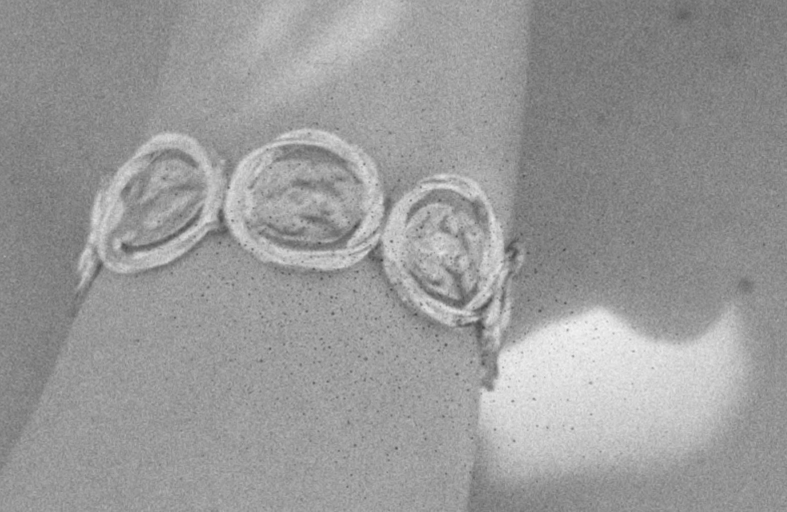

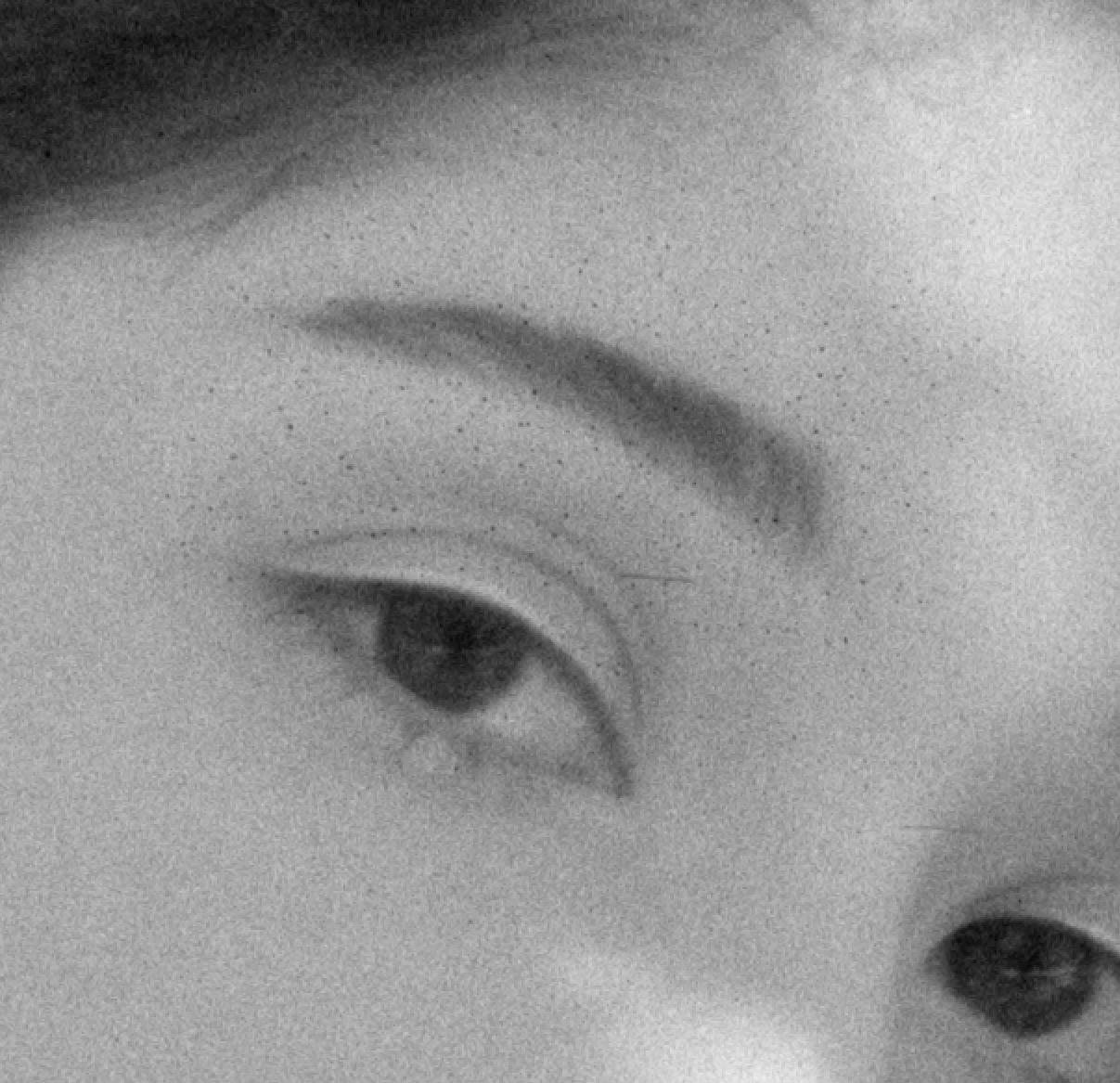

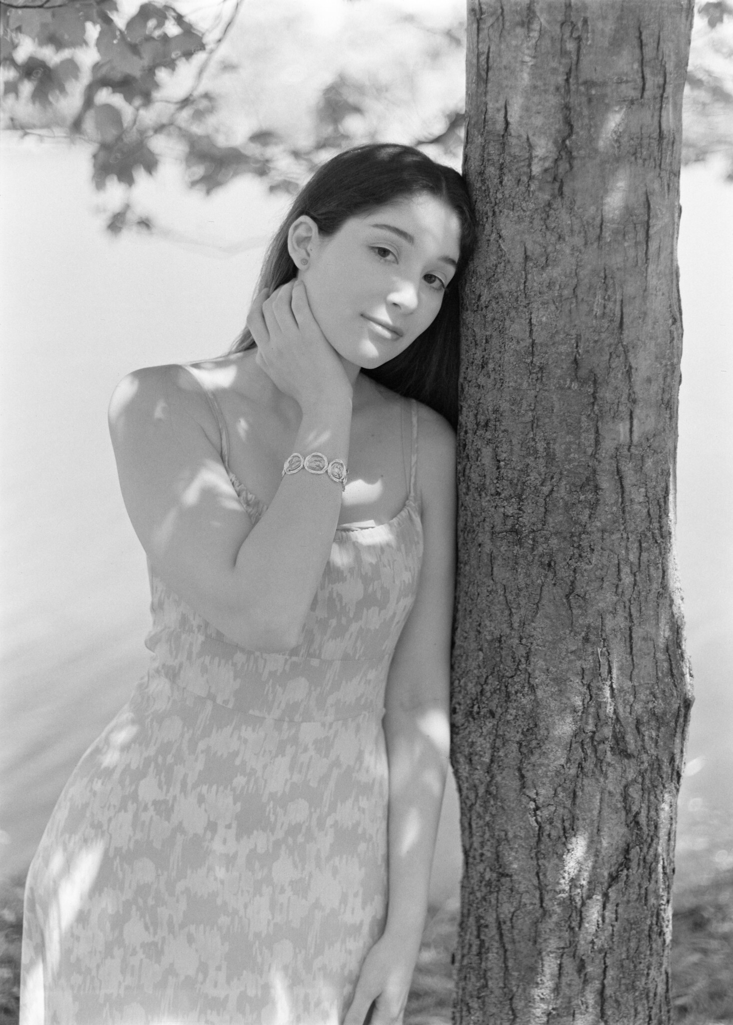

Okay, I had the chance to shoot another roll of 220. I used a yellow filter and the Volna-3 80mm f/2.8 on the M645J. Development was 1+31 HC-110 9 minutes 20C.
By and large I loved the images produced, but I wanted to highlight one where the emulsion defects seemed almost strategically placed on the worst spots that could be picked:
At least so far I have not had any dreaded film jams in camera. These defects are not enough to stop me from using the film, they are pretty much on par with Fomapan. But I can see why some would avoid it. I actually have to blow this image up to about 3 feet before I can really see them.

I hate to say/admit it but I almost certainly would never have noticed those, and I don't think any viewer would either if viewing a print, say, 11x14 or smaller from that entire uncropped frame, and maybe not at 16x20.
Agreed. It's not that bad to me, but it is more than you typically find on Ilford, so I don't blame people for shying away.

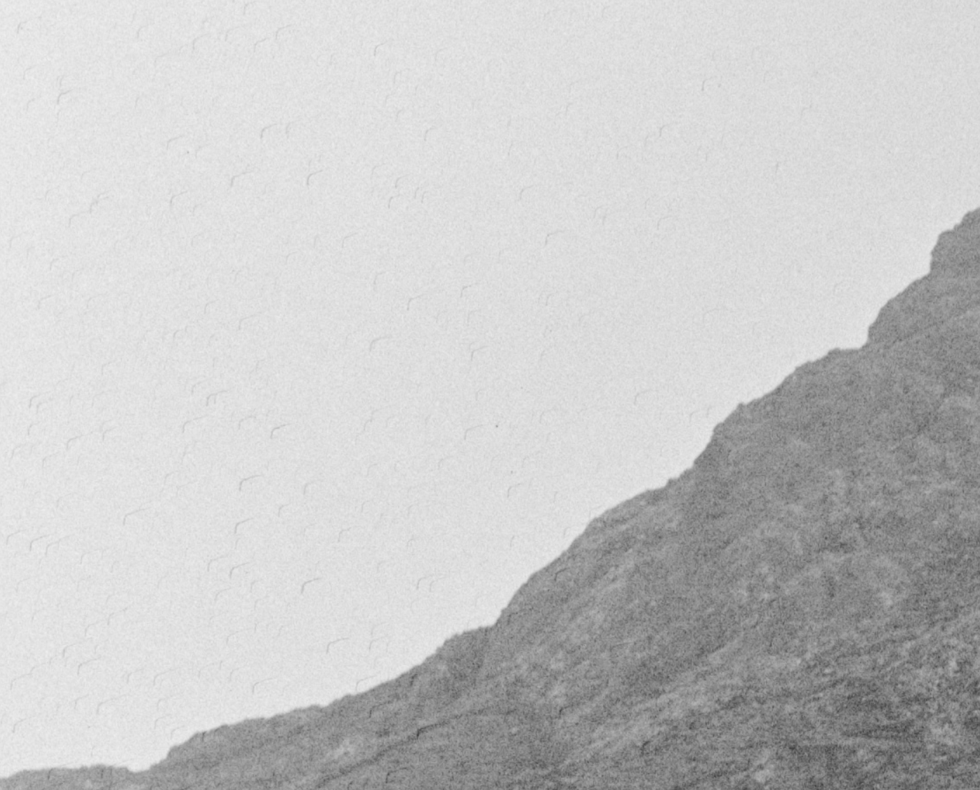

I'm still processing GP3 220 shot this year and discovering new emulsion defects. Here's the latest I found. Looks like a flock of seagulls! It takes up about 1/3 of one of the 6x4.5 frames.
