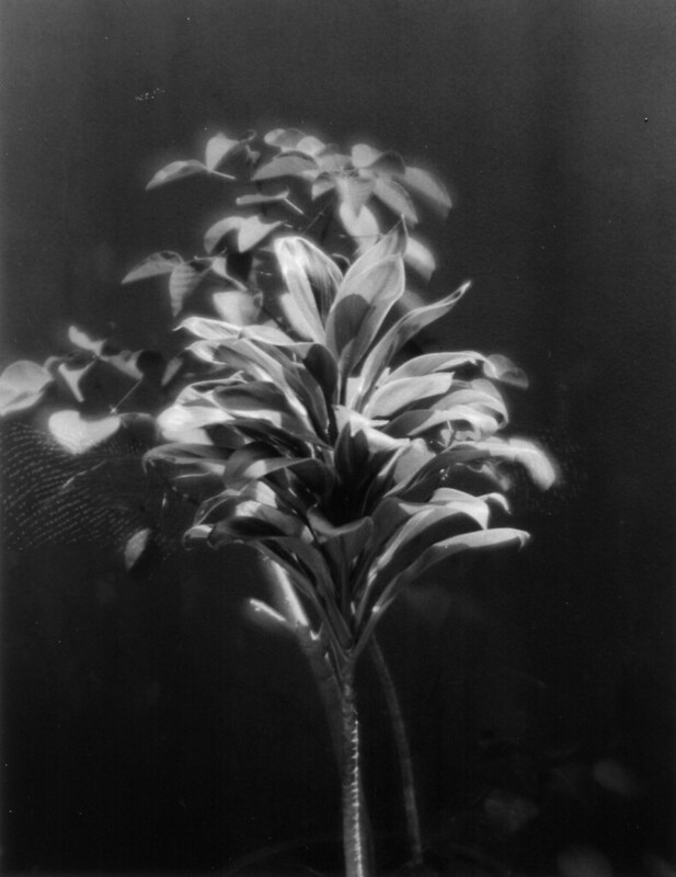

Soft Focus on Shanghai 220​
Gelatin-silver photograph on Ilford Classic VC FB photographic paper, image size 21.5cm X 16.3cm,
from a Shanghai GP3 220 format film exposed in a Mamiya RB67 camera fitted with a single meniscus lens and a #25 red filter.
Note the fingerprint halfway down the left edge. Not mine. This was the last frame on what I reckon was a hand-assembled roll.

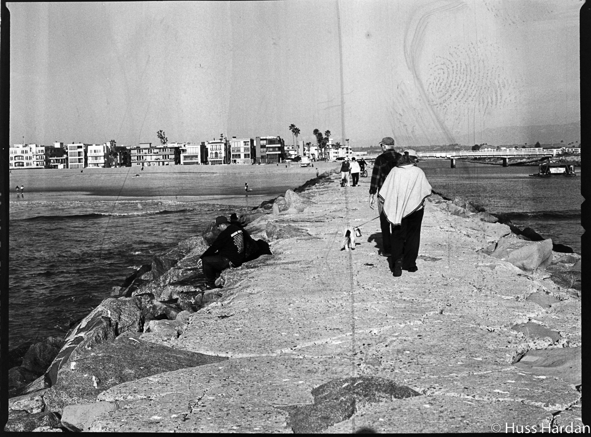

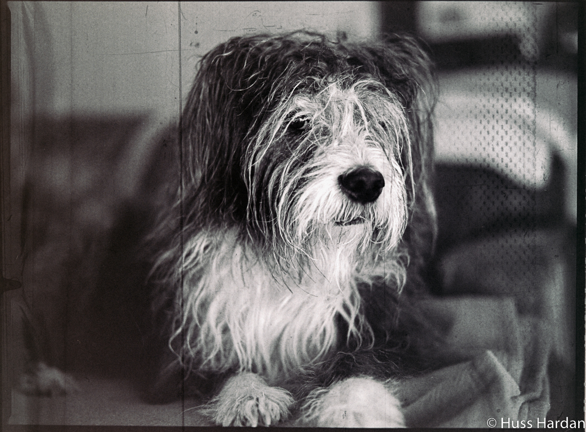

Blah my latest roll has marks on it. I’m tapping out of this one.
220 is only worth it if the quality is consistent.
... and there is a wide selection of film emulsions. I second that emulsion.
Make a 400, or even a "real 200," with decent QC and I might be interested. Until then it's of pretty limited interest to me but I can see it might be for others.
And I get a finger print too! In the sky - top middle left. As well as all the other defects.(I made the sky darker so it is easier to see)
Well with the finger prints, we can track down the offenders now.
I don't want to give them any ideas but could they call it a "film for the adventurous artist photographer" and charge extra?
That's the angle I'm going to use when I sell off the 15 rolls I have left. Lomo-style.

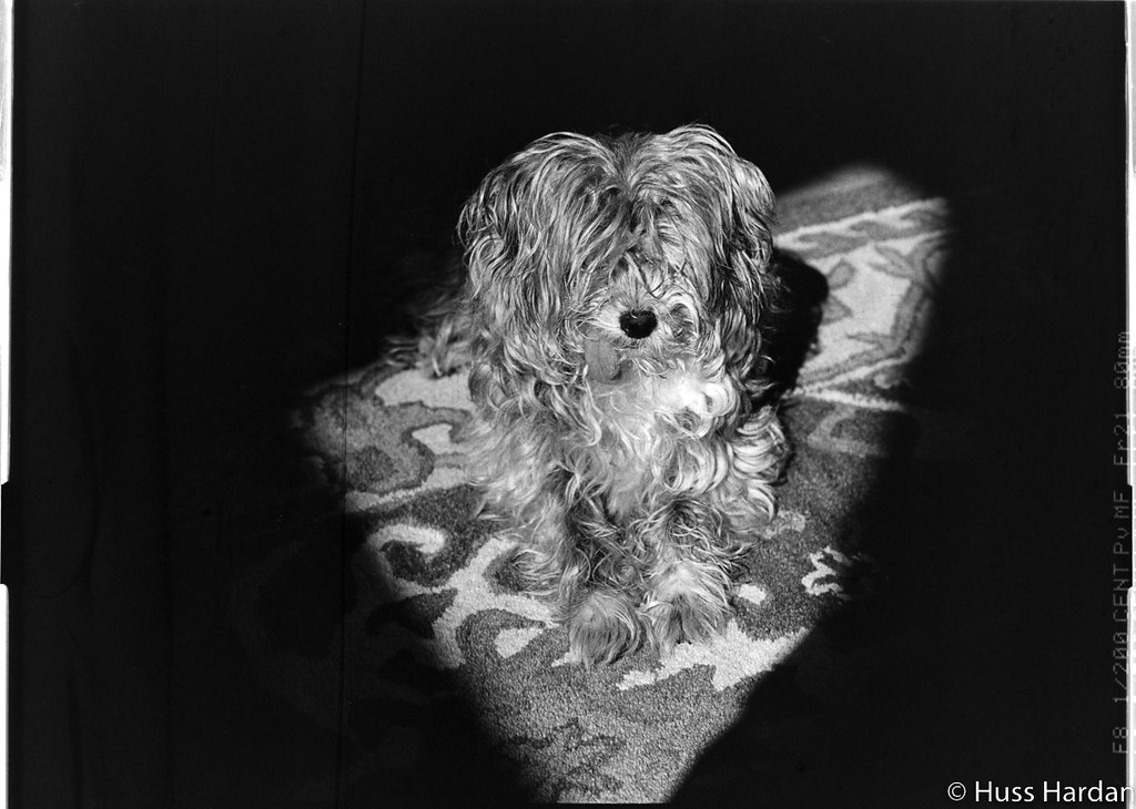

It's a bummer, because the tones of the film are really nice.
Also - I never noticed that my H1 prints exposure info on the rebate! Cool.

Do they not wear gloves while rolling the film? I wear tight fitting vinyl gloves while making mine, and also attempt to only touch the edges as much as possible.
I bet they will after watching their sales drop from threads like this one. The sad part is that I'm pretty sure they were testing the "220" film waters. If the water felt even remotely warm, they would then invest in a mechanical device of some sorts to roll their 220. This thread alone could make or break them when it comes to 220 film. It won't have any direct bearing on my photography, but it might on some folks.
I recall seeing reports of similar defects on the first batch or two of their film -- they even sold some with 120 leader and tails. I've gotten the impression we're past that; I wonder if the roll Huss had problems with was one of the early ones?
