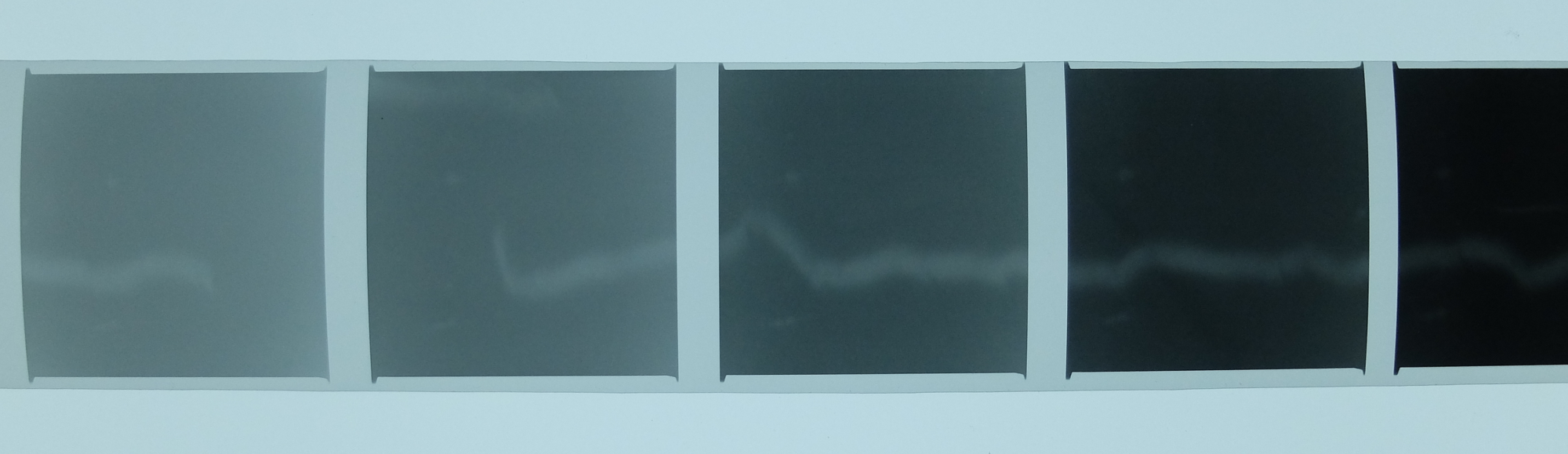

Shanghai GP3 100 (220) is like a grab bag.
I purchased 10 GP3 220 in November 2022 and 10 GP3 220 in December 2022.
All 20 films have the same data on the boxes (Emulsion number: 3101 - Develop before: 2024-02).
The first 8 films (November delivery) I used behaved like FOMApan 100 ( see my post #236 in this thread ).
But ...
Yesterday I developed film the 9th film and it was total different to the 8 other films.
The color of the water used to pre-soak had been light green for the fist 8 films. The color was dark gray-blue on film #9.
The film requieres different developing times than the first 8 films.
And ... The film had a bright, looped stripe in the middle of the film over its entire length.
Since I was uncertain, I performed another test. I exposed a film from the December delivery with a gray card (Zone I to Zone X at 100 ASA). I split the film in half and developed both halves in separate tanks. One film with ATOMAL 49 and one film with FX39. The results were exactly the same as with film 9. There was no FOMApan 100 like film and the error in the emulsion was also present.
I think I will dispose of the remaining films.
As much as I like 220 format films, I will not be using "exotic" films in the future.
Farewell Shanghai GP3 !

Whatever is in the GP3 box, las long as the boxes have the same emulsion number printed on, ist must be the same material.
I did receive 2 different films with same emulsion number on the box.
Was it an oversight, or is it a business model? Who knows ....

It looks like it was x-rayed or run through a CT scanner at the airport.
How could Foma 100 get into Shanghai GP3 boxes?
Maybe just on the 'official way', John: Shanghai bought the film from Foma for own confectioning and rebranding.
At least it is well-known for years that Foma is delivering their films to rebranding companies: Arista EDU is Fomapan, Lomography Earl Grey and Lady Grey film is Fomapan, Kosmo Foto Mono is Fomapan......
All I know is that if I want Foma 100, I'll buy Foma 100. If I want Shanghai GP3, I'll buy Shanghai GP3.
