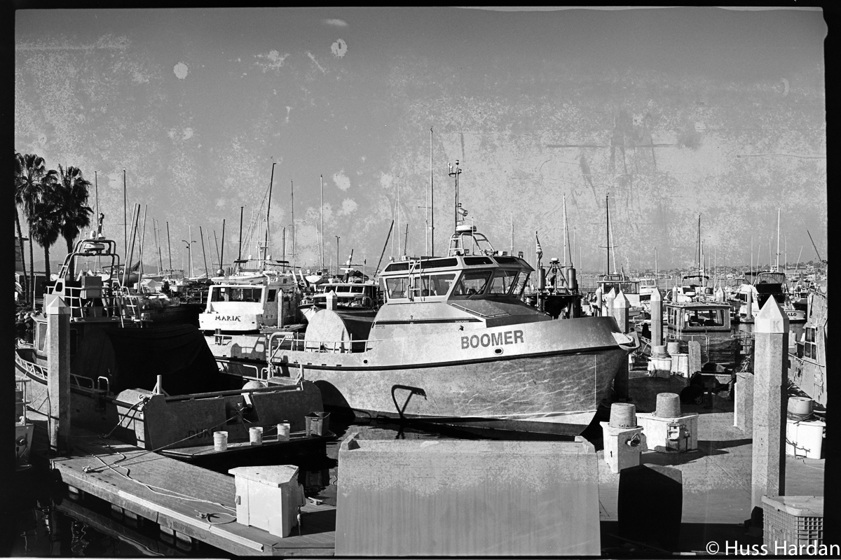

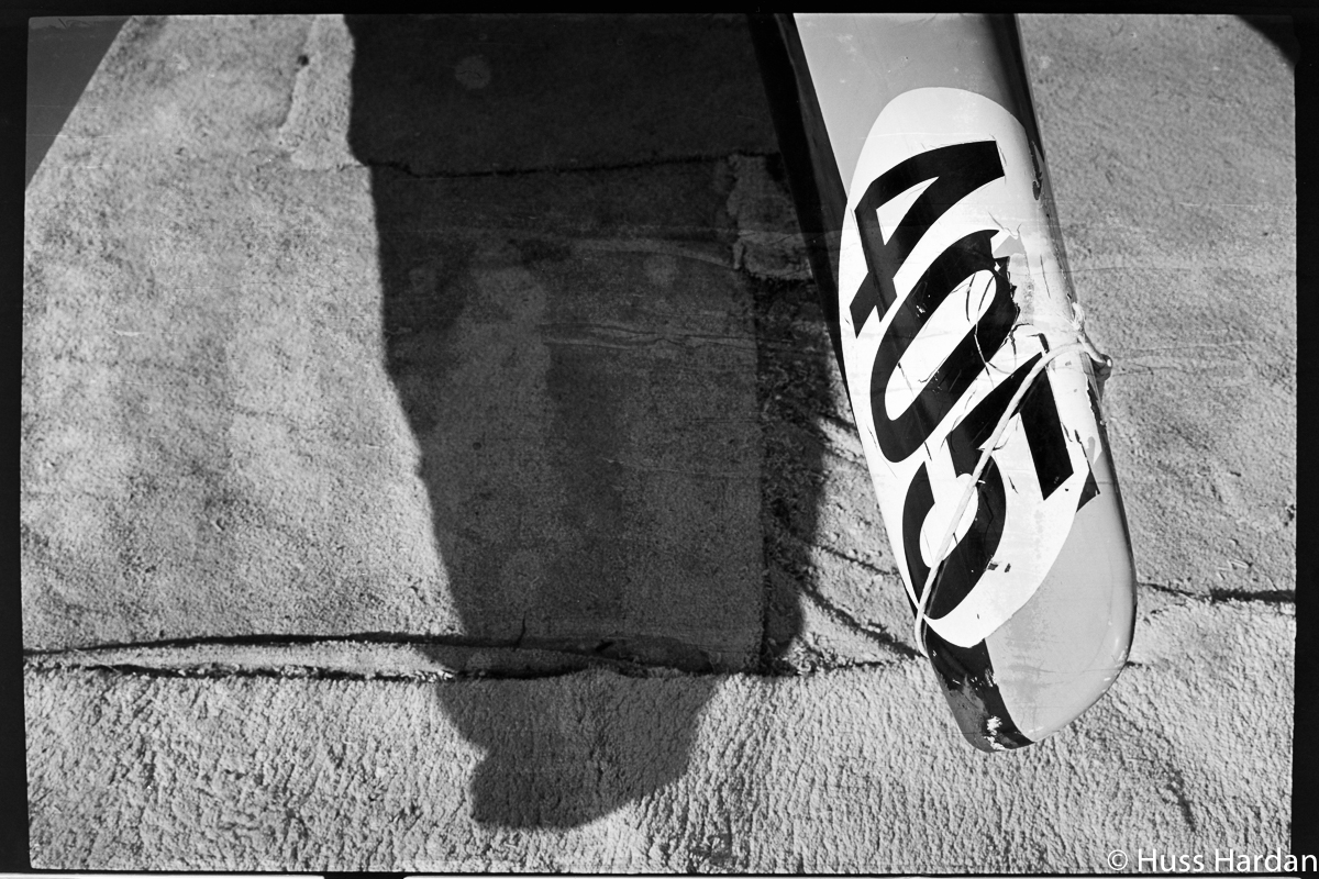

Well, round 2 was a failure unless you are going for the WabiSabi look. This time I did not touch the film - no gentle finger squeegeing, nothing. Just air dry.
Terrible emulsion marks, bad scratches everywhere. So, because this was a 'no touch' dev, the scratches are 100% on Shanghai. But the dev? Perhaps the DF96 somehow is caustic to this emulsion. I have never seen this behaviour developing other emulsions - and I've developed hundreds of rolls in the last couple of years with DF96! The one absolute failure was the Soviet Orto 80 which just completely lost the emulsion. But this would be a runner up.
Shanghai does seem to make it's own stock - as pretty everything else I've developed in DF96 monobath has been fine - Ilford, Kodak, Fuji, Lomo Babylon 13 and Fantome 8 etc.

From round 2:
Textured backgrounds can hide the defects!:
But there you have it:

From round 2:
The film is the same.
The development chemicals different but not controversial.
The film surfaces were not touched by fingers or a squeegee.
The film was hung to dry.
So who is the bad guy. Not the developer. Not the technique. That leaves the film as the direct cause of the problem. Shanghai has a long way to go before bringing this film to market.
