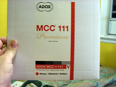

My sample arrived today, Canada is ready!
