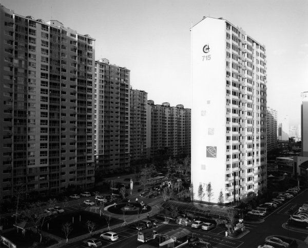

I have attached scans of the two prints that I made to test this paper. In the one with the buildings there are two important areas for the highlights. The sunlit building needs to be separated from the sky immediately to its left and the buildings on the distant horizon to the right also need to be well differentiated. At the same time the main face of sunlit building needs just the tiniest bit of tone. I chose this neg because I knew it would be a good test of highlight response. It is usually printed on Gallerie grade 3, I used a no.2 filter here. You can see that I probably did need a pre-exposure to get what I wanted from this print. That's no big deal and not unecpected with many papers. My memory is that I did not need one when I first made a print on Agfa MCC111 about 3 years ago which is why I mentioed it in the first place.

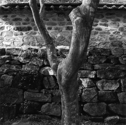

The other neg (of the wall and tree) was selected to test shadow response, which I thought was the real strength of this new paper. In this case I found the highlight response an advantage in keeping the sunlight rocks light and increasing the overall effect of contrast. This was printed with a no. 2.5 filter. I didn't ever achieve as good a print as this from this neg on Agfa MCC111.

Dear Matt,
I see what you mean, however I still think that what you're saying is that this paper has HIGHER highlight contrast and not the contrary. You see, when a paper cannot render fine detail in the highlights (the tones seem to blend to a uniform white) that means that the local contrast is high, not low.
Anyway, your point is now clear. I have to suggest that if you have printed on the new paper using a different enlarger head, this could very easily lead to a change in highlight (or shadow) contrast - I am not sure about which of the two it would be...
