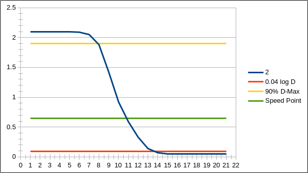

Here's an example of what went into my notebook after doing a lot of step wedge exposures for my last round of contrast calibration for my RH Analyser:
I then had to graph these numbers in a spreadsheet and try to figure out where their graphs crossed certain points for each grade:
I'd love to go straight from the densitometer into my device, then let my device crunch all the numbers internally to find those crossing points.
