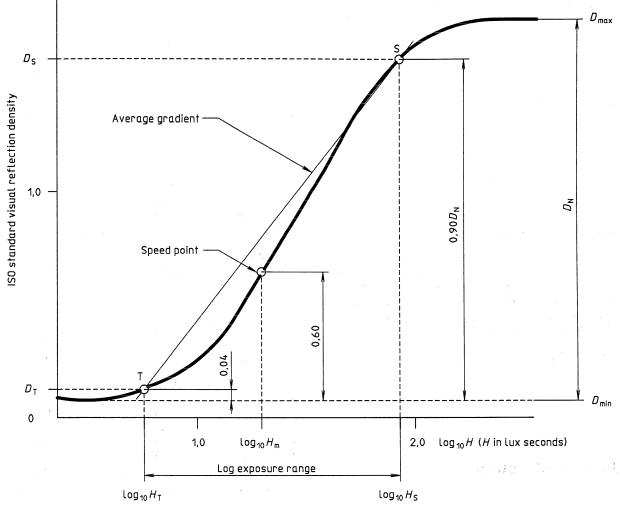

Now on to the more important topic... paper profiling for print metering. Since I've completed the "required features of an f-stop timer" (aside from some polish), I'm now thinking very seriously about my next big step. The first thing I need to do is come up with a system for managing printing paper profiles. I've already done a lot of research and brainstorming, and figured I might as well share my ideas. I should also mention that I have a copy of ISO 6846:1992, which has helped enormously with coming up with the best way of quantifying the problem.
For starters, everything really focuses around this graph of the sensitometric curve for printing paper:
The goal of a paper profile is to be able to reproduce the graph from the "T" point up to the "S" point. To put these points in a more familiar context, the paper's "ISO(R)" (contrast range) is based on the difference between "T" and "S" and the paper's "ISO(P)" (speed/sensitivity) is based on the "Speed point". (Both the ISO(R) and ISO(P) are commonly published in a paper's datasheet.)
Whether this can be done with sufficient accuracy with two points or three points seems to vary. I was looking at some curves I measured from testing Ilford MGV RC, and this seemed to vary by contrast grade. At some grades this line was straight (matching the "average gradient" shown above) and at other grades it did bend a little bit. Whether or not this bend matters enough for my purposes remains to be seen, but I do want to be able to handle profiles with two or three points just to be safe.
From looking at the existing products, there appear to be two approaches to how others handle this:
  • RH Designs - Enter the "T" point as an offset (in 1/12th stop units) to a baked in profile (that we're not sharing), alongside the ISO(R) value.
  • Heiland Splitgrade - Pick a completely baked-in profile we gave you (and aren't sharing the numbers from), and maybe nudge it with a simple offset to make it more correct for your setup.
I personally really do not like any sort of profile that depends on baked-in magic numbers, because those numbers are now unchangeable and its harder to convert this profile between systems. Therefore, my system is going to do profiles in terms of absolute exposure numbers that are easy to process and convert between different representations.
The base unit for my profiles is something I'm going to most likely refer to as a "Paper Exposure Value" or simply PEV (I want to avoid confusing it with the "EV" we're all more familiar with. Its similar in what it represents, but the units/scale are different.) This value is defined as:
PEV = (log10 H) * 100
where H is the exposure in lux-seconds​
This works well because light sensor measurements are directly convertable to lux, and can be calibrated against calibrated lux meters. Furthermore, this is actually the unit a paper's ISO(R) is specified in terms of. It also gives nice round numbers that are easy to copy/enter. (I did attempt to quantify the RH "default" profile against my calibrated lux meter, and it gave numbers in the range of 14-95 for the lower "T" point in this unit.)
So my plan is to store actual paper profiles in terms of 3 entered values, which are all going to be represented in these units:
  • "T" - exposure to achieve D=0.04 above Dmin
  • "M" - exposure to achieve D=0.60 above Dmin
  • "S" - exposure to achieve 90% of Dmax, based on the difference between Dmin and Dmax
Of course actually getting these numbers, in the right units, isn't something I can really expect a user to just "figure out". Nor do I really want them to have to whip out a calculator and do a bunch of logarithms. Therefore, I have some ideas for "easy" ways to actually enter them.
First, I'm going to make my device capable of actually displaying the "PEV" value for a meter reading (and subsequent test strip patches) so someone can write this down when doing calibration tests. (since the goal of calibration is to essentially find the "T", or D=0.04 point, and everything else is based on that).
Then, I can provide a couple different ways of actually building a profile based on this information:
  • Enter the PEV for the "base exposure" (T point), alongside the paper's ISO(R) (from the datasheet or your own tests), and it calculates the rest
  • Enter an RH-style offset which I convert to a PEV value, alongside the paper's ISO(R). (Not sure if I'll include this on the device, or just document it in the manual.)
  • Enter the PEV for a "reference exposure", alongside a bunch of densitometer measurements from exposing a Stouffer-style step wedge, and let it internally do all the math to figure out the "T", "M", and "S" points.
To make the step-wedge/densitometer approach easier, I'm even considering making it possible to plug a densitometer directly into my device's USB port so you don't need to type the numbers in manually. (Heiland TRD-2 has a USB option, and the X-Rite 810 has a serial port for which you can get a USB-to-serial adapter.)
I may even find something user-facing to do with the ISO(P), such as using it to help recommend a starting point for doing exposure tests. It does appear to be approximately 30% of the way between "T" and "S", but that actual relationship is not specified or reported anywhere so I can only treat it as a suggestion.
I'll also likely come up with a way of adjusting an existing profile in more familiar units, to make fine tuning easier. (And this part is not that hard to even do manually. On the PEV scale, "1-stop" is approximately 30 units and a "half-stop" is approximately 15.)
I really hope this rambling made sense to someone :smile: I also hope I can explain it a bit better once its time to write a manual discussing how one builds a paper profile.

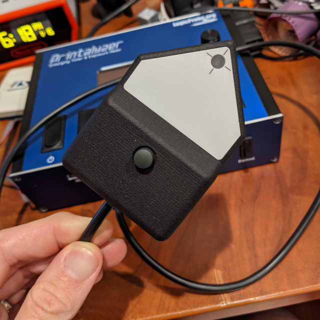

Your Printalyzer needs a densitometer. With an integrated densitometer, you would have a very compelling product.
I think you can make a tiny inexpensive hand-held densitometer having a 3-conductor wire that will plug into the Printalyzer. You need two LEDs illuminating the paper at 45 degrees, with the sensor between them. The densitometer probe would be a plastic triangle about 30mm in both directions, and about 6mm thick. Drill three holes through it the long way, with all three holes converging and exiting at a corner. When that corner is placed on paper, with the middle hole vertical, the LEDs in the two angled holes would illuminate the paper, and the sensor in the vertical (middle) hole would see the paper's density without seeing a reflection. I can sketch this idea to clarify this description. The wires would be: Common, LEDs, phototransistor/diode. You would not need to calibrate this densitometer because you can have the user measure paper-white (Dmin) and Dmax on the test-strip, which is all you need.
Edit: You could integrate this densitometer into the tip of your present probe. But that tip would be crowded with nearby photodiodes and LEDs, so you would probably need to glue-in both photodiodes and LEDs by hand, and hand-solder them to the circuit board.
Mark Overton
A light source that can clamp on top of your sensor could turn it into a transmission densitometer.
This is a little crazy but I have used a transmission densitometer to test the transmission of a step wedge exposure on printing paper. If that would work (that is the transmission values of the paper similar to the reflection values curve shape), you customer could make their own paper curves with your device.
You can include a calibrated step wedge with your device. Supply an inexpensive non-calibrated step wedge and calibrate it yourself to your densitometer for the customer.
Another option is to have an "Expert" menu to tweak all the numbers, but a "Standard" interface with the very straight forward baked in profiles. I'll bet in beta-testing with average darkroom workers that will satisfy most conditions.
In other words, those that want to use the "Expert" menu would be expected to have their own reflection and transmission densitometers and a sensitometer already.
Again, I really don't want to get side-tracked in that direction right now. Its not a bad idea for a future iteration, but for the time being I'm going to take advantage of densitometers that already exist. However, experimenting with a small reflection densitometer "puck" isn't a bad idea in and of itself.
The idea of actually making a reflection and transmission densitometer does keep occurring to me. A big motivator is the fact that "modern" color-capable densitometers simply don't seem to meaningfully exist. Thus, its kinda tempting to build something similar to the Heiland TRD-2 albeit with a color sensor. Of course even if I did build such a thing, calibration materials wouldn't be all that easy to come by. I'd basically need to make sure I had up-to-date and reliable calibration on an X-Rite 810, and use that to generate numbers for a Stouffer wedge of some sort. (The Heiland device seems to rely more on baked-in calibration, but it also is better for taking relative measurements. Meanwhile, the X-Rite does better with absolute measurements.)
Therefore, I suggest that your probe use an RGB photodiode or phototransistor so you can detect and compensate for such a color cast.
As I've mentioned in previous posts, I am planning to use a color sensor for this. All my research has told me that color sensors actually work better for measuring "lux" because of how it maps to the color spectrum. (Lux measurements are actually biased in favor of green, which is why the RH and Heiland meter probes have a green filter over their sensors.)
I took a close look at how the TRD-2 is designed. Its similar, but not identical, to this description. It basically has a plastic "triangle" shell with a vertical black tube that likely leads up to a sensor. It then has a single LED installed at a 45 degree angle to this. It also has a bottom illumination source behind an aperture, but that's only needed for transmission measurements. If I were to make an "accessory puck" for my device, I could skip that part and simply rely on a pre-calibrated step wedge (even an uncalibrated one might be close enough).
But again, maybe a side-project to experiment with using the same components I'm already becoming familiar with, but not what I really want to focus on until I'm basically "done" with the existing design and functionality.

The main purpose of these "PEV numbers" is simply to have something that's easy to type in and write down for reference. There are enough variables that I'm not sure I want to provide existing baked-in profiles (that would be a lot of work too, where my conditions may not match other peoples' conditions). However, there is an "easy" way to calibrate with this system:
  • Put the device in "calibration mode"
  • Take a meter reading
  • Make a test strip, and write down the PEV numbers associated with each strip patch (it'll display those)
  • Find the patch that most closely matches the tone on the D=0.04 "reference strip" (RH includes something like this)
  • Enter that number, and the ISO(R) from the paper's datasheet
Anyways, I've been crunching more numbers (based on data I collected when doing past paper calibrations for my RH Analyser and when trying to characterize its "base" profile), and have come to an interesting discovery. Maybe this is something obvious to everyone, but I have not seen it explicitly written anywhere. Essentially, when Ilford (et al) say a paper has an ISO(P) of 500 unfiltered or 250 when filtered, I don't think they're claiming that the paper is less sensitive to filtered light than to unfiltered light. Rather, they're saying that the filter itself cuts the light in half. In other words, I think they're measuring the "speed point" light without the filter, then exposing the paper with the filter. Either that, or something else about the filtered measurement process is unsaid. Regardless, my takeaway from this is simply that I shouldn't ever show the user the "speed point" converted to an equivalent ISO(P) value, because it'll just be confusing.
So, while I still plan to represent a profile internally in terms of HT, HM, and HS, I think I'll just display them one (slightly different) way to the user:
  • Base exposure (Dmin + 0.04)
  • Speed point (Dmin + 0.60)
  • ISO(R)
All three values will be in the "PEV" units I described previously, with the speed point being optional. The main change is simply showing the user ISO(R) directly, rather than having it be on a screen with a "simplified representation". This way I can have one screen for setting the calibration numbers, and only need additional menu options for "fancy" features (such as calculating them from step wedge measurements).
You can get the "Base exposure" from a simple comparison test (as described in my last post), and you can get the "ISO(R)" straight from the paper manufacturer's datasheet. (HS is just "HT + ISO(R)" )
And speaking of ISO(R), here's something interesting I did find when I tested Ilford MG V RC for my RH Analyser... The ISO(R) numbers I got from measuring step wedge exposures (as described in the RH calibration manual) were actually very close to what Ilford published. So while doing your own tests to get this number will certainly give a more "refined" profile, simply using the datasheet value* will be fairly close to the mark.
(* Assuming, of course, you're using a diffusion enlarger with a tungsten light source, which is what those numbers are based on.)
Here's an idea to future-proof the Printalyzer by making it easy to add the densitometer function to it:
1. Mechanically, design the probe so that a triangular densitometer adapter could be attached to the top of it.
2. Electronically, make it easy to accommodate the LED(s) in the adapter, perhaps by having a 3.3v or 5v plug on the probe. This adapter would contain LED(s) but no sensor because it would use the probe's photodiode.​
With this approach, you can work on the adapter later (if at all). But at least you won't regret being locked out of this option later.
Technically speaking, there's absolutely no reason why I couldn't just make a densitometer probe that plugged into the exact same port I'm currently using for the meter probe. I designed that interface to be flexible and somewhat future-proof.
The parts you'd avoid duplicating with an "add-on accessory" really aren't as expensive as you think they are, and it would make the meter probe a fair bit more mechanically complex (and more annoying to use as a densitometer than a dedicated densitometer widget).

So, this week I feel like I've been perpetually on the verge of actually implementing the print metering part of the project. (First I built the first round of actually inputting and storing paper profiles, then I added some helper modes to the device's home screen for assisting with making those profiles.)
In any case, as I continue to characterize how my RH Analyser behaves (versus measurements I've taken with other instruments), I think 3 possible approaches towards print metering have emerged. Fundamentally, all 3 approaches involve taking a series of readings, finding the "center" (mean, median, geometric mean, something like that), finding the ideal exposure for that center point, and plotting all the readings on a user-visible tone scale. Where these approaches differ, is in how I quantify that scale and what exposure I use for that center point.
These 3 approaches are based on what profile data I have to work from, and they are:
  • Base exposure + ISO(R)
    • Center on the midpoint of the contrast range
    • Place tones on an exposure (PEV) based scale
    • Maybe have some extra headroom on the dense end
    • (I think this is how the RH Analyser is behaving, and it is the simplest approach)
  • Base exposure + Speed point + ISO(R)
    • Center on the speed point
    • Otherwise the same as the previous approach, and may give similar (but not identical) results
  • Base exposure + Speed point + ISO(R) + Dmax
    • Place tones on a density scale (from D=0.04 to 90% of net density)
    • Starting exposure may look similar to the previous approach, but the tone graph could look different
I would not be the least bit surprised if all 3 approaches yield very similar results, but that will vary depending on where the "speed point" is located on a particular paper curve, and how linear the important part of that curve happens to be.
Of course once a "center exposure" is chosen, the process of adjusting it will likely always be done in time-stops to keep things simple and consistent.
