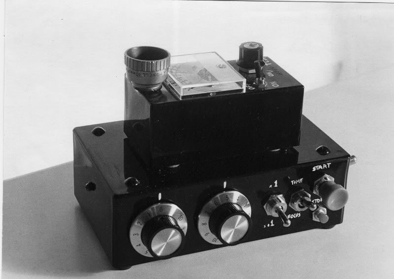

I built my own timer with a raspberrypi zero with no box, indeed a bit of a wire mess, you are working on a very nice solution!

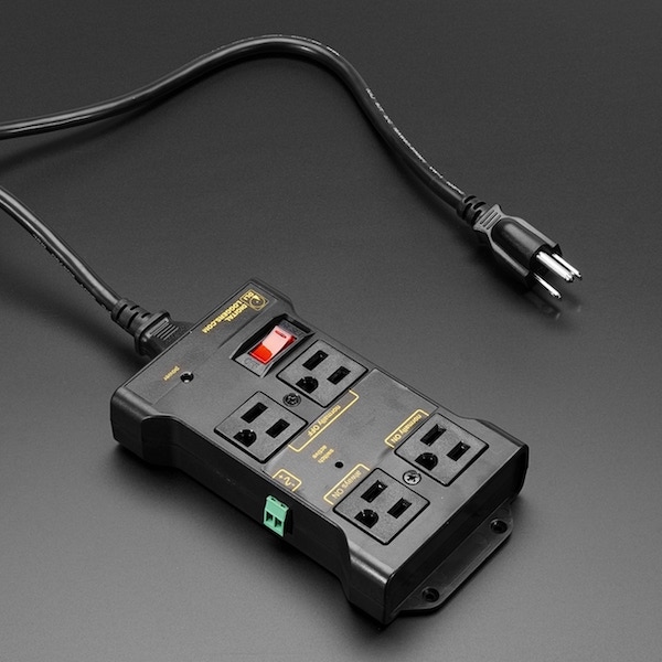

After looking at electronic relay components, I went with this https://www.buyapi.ca/product/iot-power-relay/ to do the power switching for the enlarger (bulb) and safe light. It has 4 power sockets, 1 always on (powers the raspberrypi, via usb charger), 1 normally on (safe light), 2 normally off (enlarger, spare), and 1 signal line to reverse the on/off sockets. It's more limited than generic banks of relays but my electronic skills are minimal so I was happy I found this product.

I'm well aware of this product. The problem is that its the only product I can find anywhere (unless you include expensive industrial PDUs) that could let me "outsource" enlarger power control. Also, it has a few shortcomings that are probably showstoppers for my use case:
  • It only has one independently controllable outlet (I really need to control the enlarger and safelight separately), so I'd need two of them.
  • It is kinda big and clunky, so having two of them dangling off the back of my device wouldn't be so nice.
  • Its completely useless for anyone who doesn't use US power plugs.
