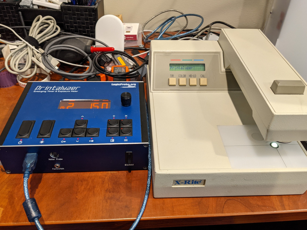

Just a little taste of what I've been working on this past week, in the form of a picture of my cluttered desk...
Basically, I've decided to go ahead and start working on my densitometer interface, as the first step of improving my paper profile generation process.
Of course before I can do that, I need to actually be able to interface my device with densitometers. For older units, like the X-Rite 810, that means using a USB<->Serial adapter to connect to the serial port on the back of it. For newer units, like the Heiland TRD-2, its a direct USB connection. However, internally, the TRD-2 does this using a USB<->Serial chipset, so its really the same from the perspective of my device.
But wait, there's more!
In order to do this, I first needed to actually make my microcontroller capable of talking to these USB<->Serial adapters. Support for that was actually not built into the platform's USB host stack. And obviously, there are many kinds of such adapters out there. So I spent the better part of this past week figuring out how to get the FTDI FT232R working (most common chipset, also used internally by the Heiland TRD-2). I then spent the last day or two working on the PL2302, and next after that is the CP2102. Hopefully this covers enough of the bases for now.
With any luck, it won't be long before I'm actually writing real code to speak the protocols of these densitometers (that's actually the easiest part of this whole project). Once that's wrapped up, maybe in another week or so, I'll finally be able to start working on densitometer-assisted paper profile creation.
For now, I'm going to focus on the Heiland TRD-2 and the X-Rite 810 (and similar models) as that's what I have to work with. If there are any other popular densitometers out there with serial or USB ports on them, and they're worth adding support for, please let me know.
But until then, here's a picture of using that serial interface to make my X-Rite 810 display custom text on its LCD!

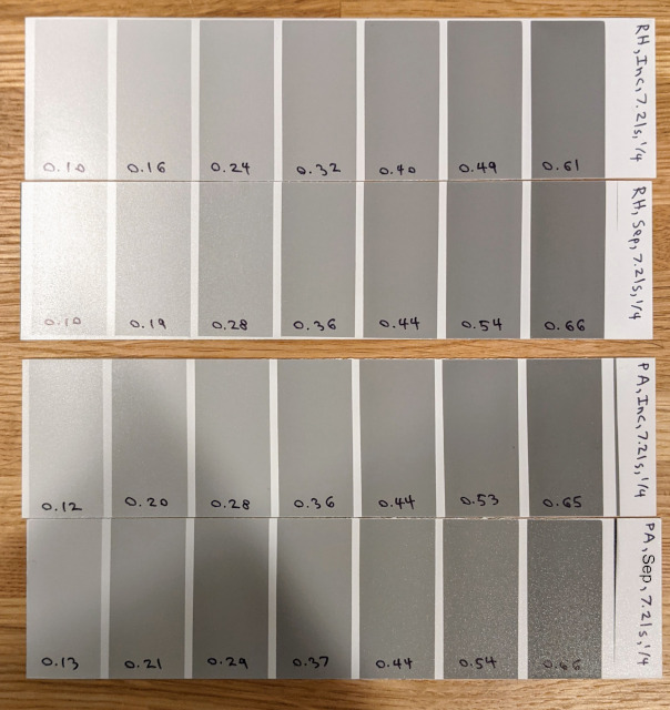

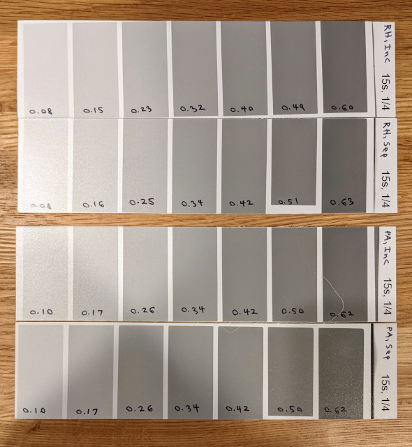

So today I decided to go into the darkroom and do a head-to-head test between my RH Analyser Pro and my Printalyzer prototype, at the task of making a simple test strip. Specifically, I wanted to see if all of my crazy "enlarger calibration" nonsense made a difference.
So my test setup involved building simple test strips in both "incremental exposure" and "separate exposure" modes on both devices, with the identical specified enlarger time, contrast grade, aperture setting, and patch increment. The first test was centered at a 15s exposure, and the second test was centered on a 7.21s Grade 2 exposure.
I then measured all the strips with my densitometer, to see how the two compared. Now you can't really compare the full strip between devices, because RH uses "funny math" to calculate their f-stop timing increments (best explained as a slightly-off attempt at doing fixed-point math on an 8-bit MCU). But what I was really looking for was the comparison between "incremental" and "separate" modes for each device.
With the RH Analyzer, there was a small divergence between the two modes, that seemed to grow a bit the further you got into the strip.
With the Printalizer, the two modes yielded IDENTICAL results at 15s, and almost-identical (within a D=0.01 margin of error) results at 7.21s.
I'm quite happy that my crazy deep-dive into making my device able to profile the rise/fall times of the enlarger was actually good for something. :smile:
The ultimate goal here is that when you say "Expose for 15 seconds," what you actually get is "The equivalent exposure of 15 seconds of full light output." Sure, with a 15 second exposure, this is mostly meaningless. But with a 1-4 second exposure (as you might have with incremental test strips), it does make a measurable difference.
Now I did do a lot of bench-test measurements of the RH Analyser's actual output-toggling behavior, and it does seem to stretch the exposure time by a little bit (40-80ms, and it varies a little depending on the length of the specified exposure), which may help them a little. If not for that, the difference would be even more dramatic. But it does not beat actually calibrating the output timing to the enlarger's behavior.
I don't remember whether you are using the Printalyzer's meter to measure rise/fall times. Normal light is so dim that exposure times would be too long, but placing the meter on the lens with the aperture wide open would be so bright that you could take a few hundred exposures per second. Then transfer-rate would be a problem. I doubt I2C would be fast enough, but SPI might be. Or use an 8-bit MCU to buffer inside the meter itself. I know how much you love 8-bit MCUs. :smile:
