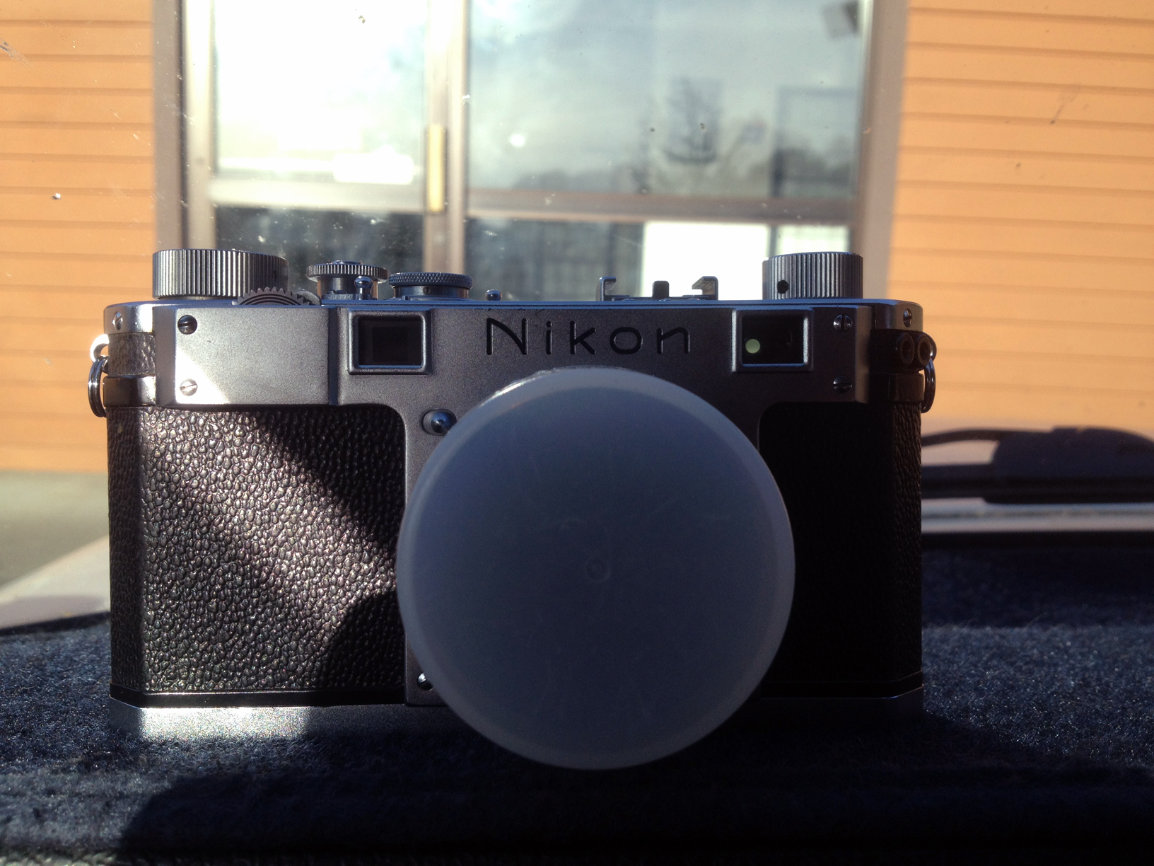

Got your S2's father. In any case, RF patch is bright on my S. One tidbit - you don't have to use the focusing wheel. If you unlock the infinity lock, then hold the lens by the collar just behind the aperture ring and rotate it, it works as a focusing ring. Have a roll of Portra 400 loaded in mine. Should be fine for the somewhat cloudy days forecast for the rest of the week, after Wednesday.
