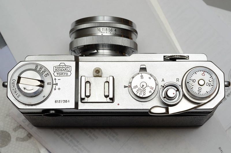

One aspect of this camera that still puzzles me a bit is the dial to the left as you hold it at the rewind knob they call the Syncro-Select dial. I don't intend on using it with flash and wondered where it should be set just to shoot normally without flash bulbs or electronic flash. There is also a + or - dial under that one. I imagine you cold get some screwed up shots if these are not set right. since there can be a time lag in milliseconds depending on how that dial is set.
The manual doesn't seem to indicate where this is set if shooting without flash. If you don't have the high speed dial set to X I don't suppose the Syncro Select dial matters.

If you're not using flash, just set it to X. It really won't make any difference without flash, but that's really 1/50 of a second and the limit of using electronic flash sync with the s2.

From the manual I gleaned it has to be on X and the shutter speed dial to X as well for flash.

X on the shutter speed dial is the max sync speed (1/50), but you are welcome to use slower speeds as well.
It works just like any other flash sync in that you cannot exceed the max speed or your negative will be unevenly illuminated. This is really no issue at all unless you're using a flash that is attached to the shoe (which is not hot, technically) and plugged in to the PC port.

I received the camera today...looks good. The lens looks immaculate as well. First impressions was the rangefinder patch is not near as big or defined as the Leica and makes focusing a bit harder...at least for me since I'm use to the Leica. The infinity lock is a bit aggravating but I'll get use to that. There's a "button" on the front you can move to the side slightly and get it out of locked position.For all practical purposes, the 50mm frame lines are so far left/right and top/bottom you don't really need them.
