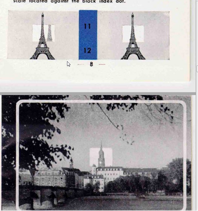

I didn't know that. I need to look over the manual as I'm not sure what the small f-stops on the body's flange is for. I'm still wondering why Nikon made that patch so small and undefined.
The rangefinder patch in mine is quite nice, actually. When mine arrived, I had it looked over by a technician and he verivied that my shutter's timing was excellent. He also cleaned the rangefinder mechanism and it was noticibly brighter than before. Maybe that could help?
According to the seller, a company in Georgia, it was CLA'd back in October by DAG. I've never seen an S2 rangefinder patch so, I don't know what they're suppose to look like. This one looks like a small squarish blob, for lack of a better word. In other words, its not a sharply defined rectangle like Leica.
That was the word I couldn't seem to find..."faded" That's what it reminds me of. If DAG had this camera in for a CLA he should have cleaned the entire camera. I don't think he touched this part of it. It sure doesn't look like the sharply defined square in the manual.

This is a pic of what they show in the manual. Mine looked nothing like this.

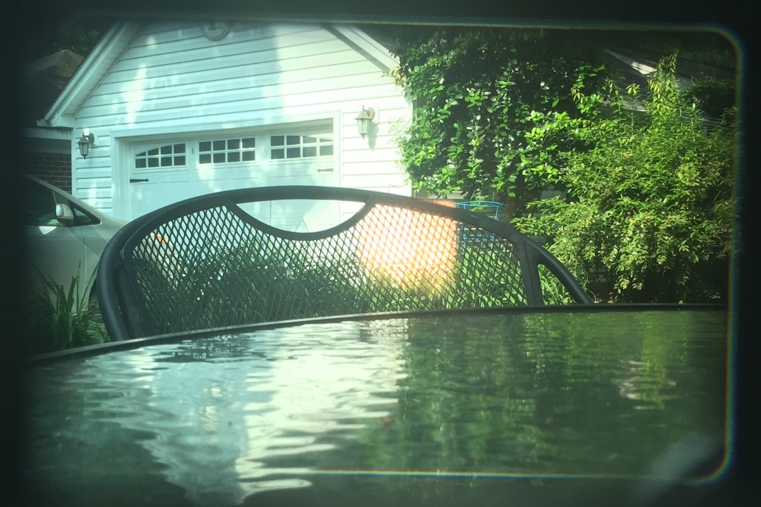

Okay, Theo. Here's the best pic I could get with my phone. As you may be able to see, my rangefinder patch is bright and clear to see, but it is not very well defined around the edges. The frame-lines are also near the edge of the finder window but ai can still see outside of them. I have found the lines to be more than accurate enough. I have no trouble focusing in any light that film can see as long as the subject isn't moving too quickly toward or away from me.
It does make a difference as to what angle you hold your eye to the finder. If you're too high or too low, the patch might appear out of vertical alignment. Because there is no paralax adjustment, the patch stays in the center and the content changes. Does that make sense?
I don't have mine nearby but that is pretty much how it looks. The patch is an overlay, so when in focus 2 images become 1, with 1 image being "yellowish". I do recall the frame lines being sharper, but I don't pay a lot of attention to them.
In real use, the frame-lines are nice and crisp... I just couldn't get my phone close enough to the finder to show that because it's in a case. Dumb iPhone.
Okay, Theo. Here's the best pic I could get with my phone. As you may be able to see, my rangefinder patch is bright and clear to see, but it is not very well defined around the edges.....
Nicely done, thank you! So, that patch is certainly adequate; it's much better than I've seen in other cameras - and it's crisply focused on the chair as well.
