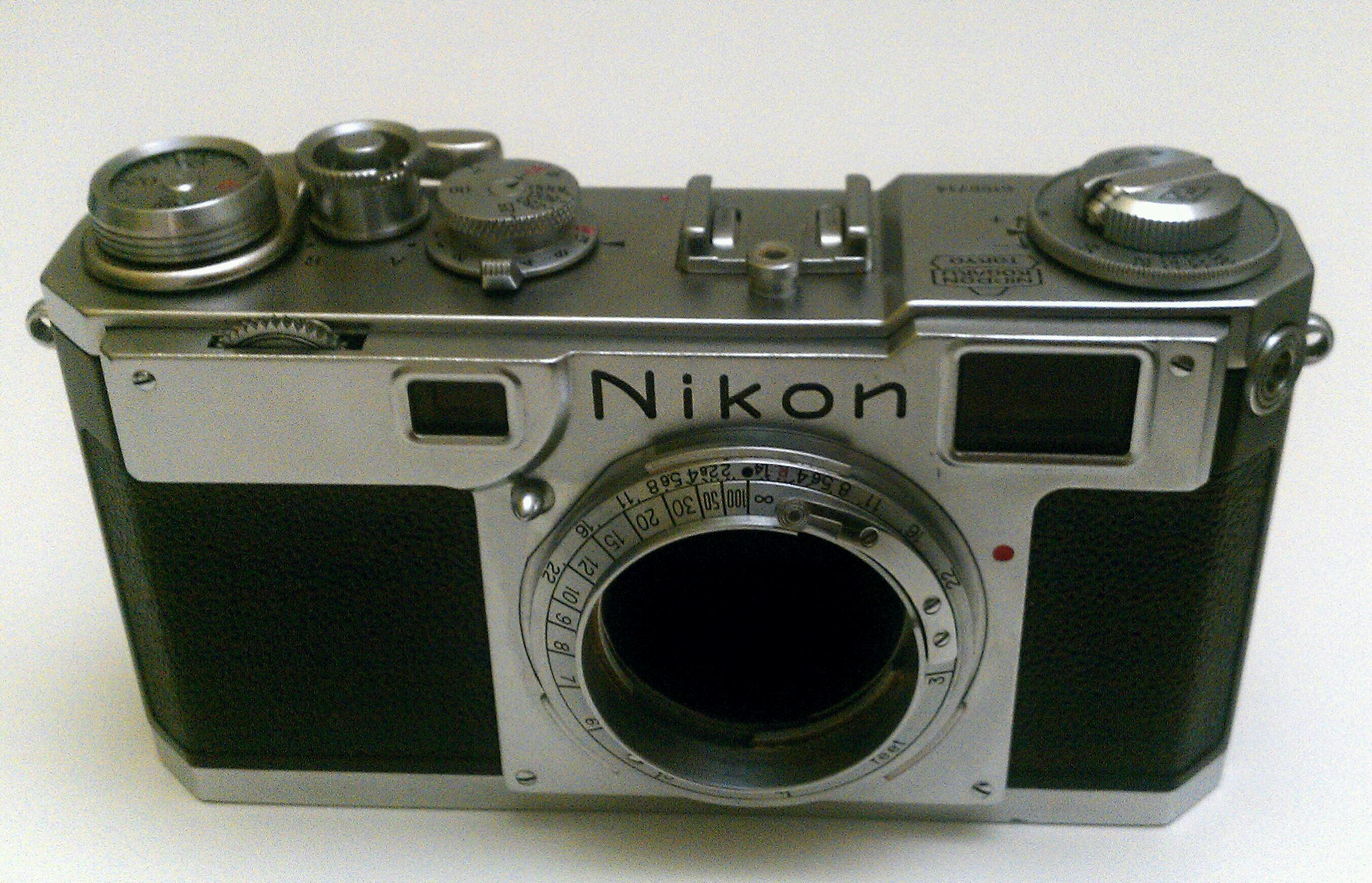

One question, when focused at infinity (see photo), is the black dot supposed to be above the line or above the infinity symbol? Focusing stops at the line.
Beautiful:smile:
The infinity mark is on the line, I think. It also locks in.

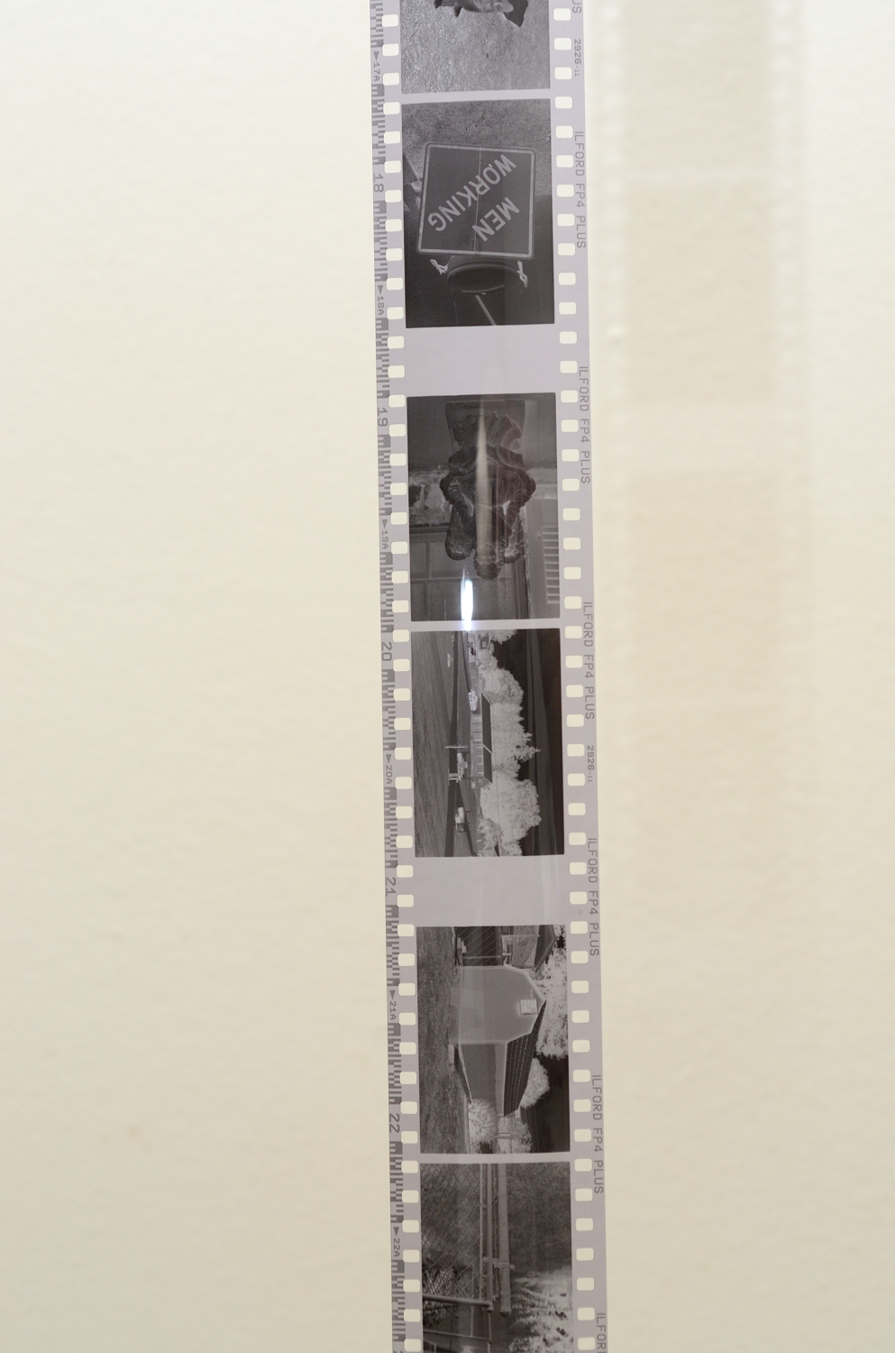

I decided to try a test roll today and shot FP-4 but only got 22 shots instead of 24. After developing I saw why. There's a large gap in the photo in two places and another further up the roll. The bright spot is from the bounce flash I used.
Those familiar with this camera, what could I have done to cause this?
Are you winding with a solid single stroke? Is the A/R knob completely engaged? Here's what I would do: take the back off and wind a full thirty six frames without film and see if you notice anything odd with the takeup mechanism. If you don't notice anything without tension, it might be worth it to put a spool of film in and wnd it through without the back on (keeping your thumb on the canister). I have never had that happen in mine and I consistantly get 37 or 38 frames from a 36 exp roll.

I do recall on 2-3 winds of the lever it sort of felt like it stopped but as I pushed it further it did stop to allow an exposure to be taken. That was probably when the gap happened. This has happened with the FTN Photomic I have but it never left a gap like that. It was sort of like a double stroke needed like in the DS Leica M.I just went through 20 blank shots and it's as smooth as can be.
