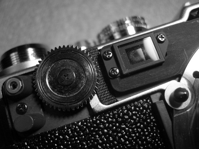

Is it possible to have your rangefinder mirror re-silvered? I think that would help a lot. My S2 is almost as easy to focus as an M3.
That I'm not sure of. I've noticed a tiny black spot just off center if you look at the small rf window from the front. It's super tiny but you can see it. I don't know if that has anything to do with it or not. I saw this on another forum and wondered if you remove those three screws that look like they hold on the rf window if you could get to that speck and brush/blow it off?

... I've noticed a tiny black spot just off center if you look at the small rf window from the front. It's super tiny but you can see it. I don't know if that has anything to do with it or not. ...
I doubt it would help much. You described your rangefinder patch as faded and the finger test earlier seems to imply the mirror has become desilvered.
There has to be someone who can confirm and repair that. If it were my Speed Graphic, it's trivial to pop the top cover off and look at the rangefinder mirror. If it's desilvered, an experiment with aluminum foil behind the mirror would confirm the needed fix.
For a good repair person, these cameras don't seem like they'd be difficult.

That's the problem. It was given a clean bill of healthy by DAG just a couple weeks ago but, I just don't agree with the findings. I know what I see and from what several have said, there's a problem somewhere. I don't know how to work on these cameras and attempting to take it apart to get to a problem area would probably require a total realignment of both horizontal and vertical alignment.
