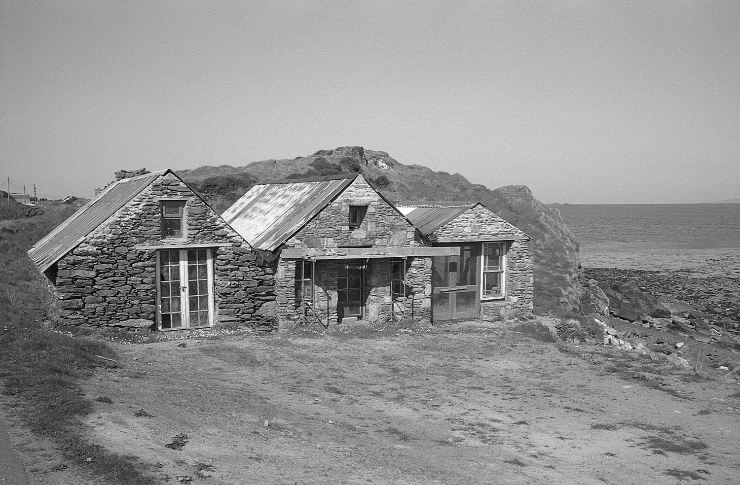

I had taken this as a compliment of my photography and not really a statement about the developer. The developer needs to support whatever artistic expression you are trying to achieve, and to that extent some credit is due, but you could achieve similar results by other means. It's fun with B&W that you have some control over the image produced by messing with chemistry. Finding an expression you like by starting from film and raw materials and getting images out at the end is rewarding, and that is enough for me.
Quite right. The picture is a credit to your metering skills especially. And I completely agree with the rest of what you say here.
Of course, it's very difficult to formulate such a solid all-around developer, and I feel I need to congratulate @relistan on succeeding to do so.
Hear, hear! 👏
I am really enjoying this thread, the information, and your photographs. It seems you've created a great developer. I might actually give it a try. I have all the ingredients. Thank you for sharing your knowledge!
Yes, a very good effort.

I developed a roll of Fomapan 200 shot in my Kiev 4a at box speed with Helios-103 in PC-512 Borax 1+50 for 5.5 mins @ 20C. I need to cut the time, this is over developed. However, it still looks pretty nice, so in the interest of showing how different film stocks look, I'm posting it here.
You say it's overdeveloped, but to me it looks great.
Of course, it's all personal preference, but to me it has the contrast and range of a well exposed cinema B&W negative for making projection prints.
( at least the scan represents this; the actual densities, may be a bit much!)
Very nice!

This is from the roll I just developed, showing some different lighting conditions than the others I posted.
Leica M2 with Summarit-M 2.5/35mm on Ilford Delta 100 at box speed. PC-512 Borax 1+50 for 6.75 mins at 20C.
Dmin on this roll was 0.38 and Dmax was 2.26

Thank you! I really appreciate that. Yeah, I say it's over developed because it's definitely too dense for the exposure, but it doesn't seem to have hurt the output, which is interesting. I do not know what speed I should be shooting it at yet in this developer, it's the first set of photos for this film, but seems to be box speed-ish.

Thanks for the kind words. Regarding the rest, I'm not sure what you are asking. Are you trying to analyze a scan of a particular photo or understand how the developer works? You can see from the test that @aparat posted above that with Delta 100 it delivers box speed and is capable of correct contrast. This is also true in my experience of the other films I have tested. If you see a particular photo you don't like the look of, I suggest to just ignore that since your taste in contrast may differ from mine and scanning of negatives is applying subjective values to the output just like when printing.
There is no reason on any particular scene to not show some full black. All of my scans are adjusted (as you would with prints) to have some full black in the photo. This is validated by showing that there is at least a small amount of clipping. The darkest patch may be small in certain bright photos with not much shadow area, but it is there. But I'm not sure how this is related to the developer.
I mean exactly that and asked for the value of exposure if you remember settings. Some emulsions combined with specific developer may need longer exposure to capture darkest tonality. But our compositions need to have inherent light balance as a first step in order to have it on the negatives and prints that are properly exposed and processed.

I’m sure it was not set to 500, it’s super rare that I would ever use that shutter speed. But that’s not how it works. A negative with correct contrast can print or scan the full scale from white to black. There is no magic to shutter speed until you reach long enough times for reciprocity failure. Otherwise it’s just total amount of light that reaches the film, and that is set with either shutter speed or aperture. Anyway it’s rather irrelevant to the thread. If you don’t like that photo or how I scanned it, that’s fine.
