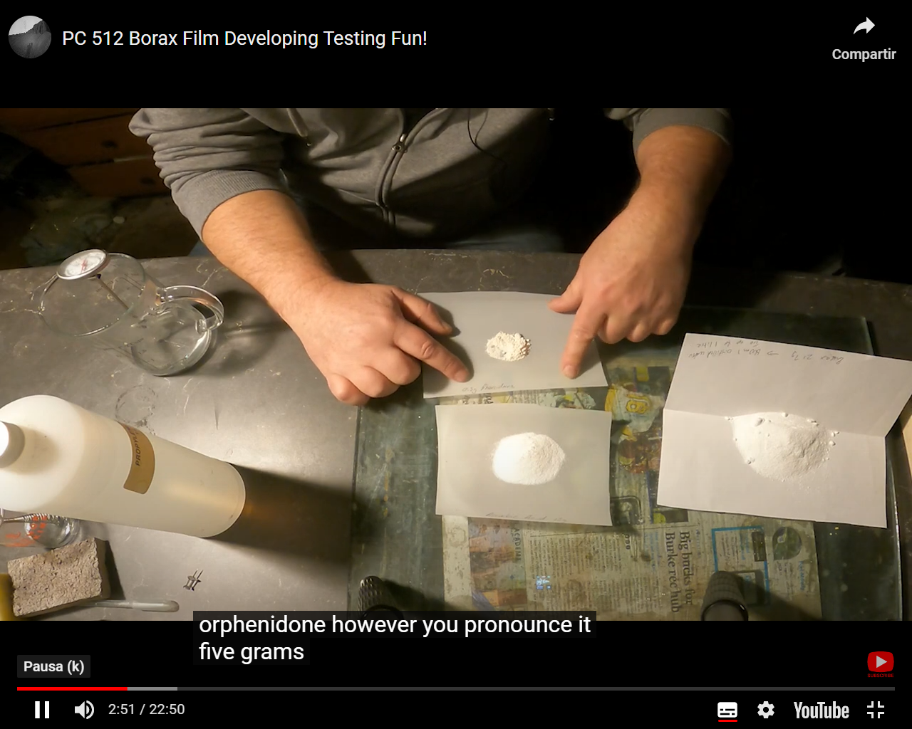

5 grams of phenidone? see 2:52 Is it possible that I have a mistake in the formula?

It's 0.5g of Phenidone. I believe that is what I said.. and measured out 🙂
I will have to keep insisting, in addition to what you say there is a picture and what you see in the picture is not half a gram of Phenidone, it is much more.
0.5 grs is half of 1 gr.
And I will have to keep insisting that what I measured out was HALF a gram... 0.5. I was there. I measured it out 😉
You should see how much Phenidone there is in one gram when I make 500ml stock solution A, Pyrocat-HD 😄

Phenidone is quite a light powder, so 0.5g does look like a lot. My Dimezone-S is in granules, so it's far less bulky.
