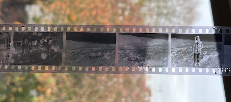

Here are some photos I developed with it (Delta 100)

...the irony of that second photo is delicious.
