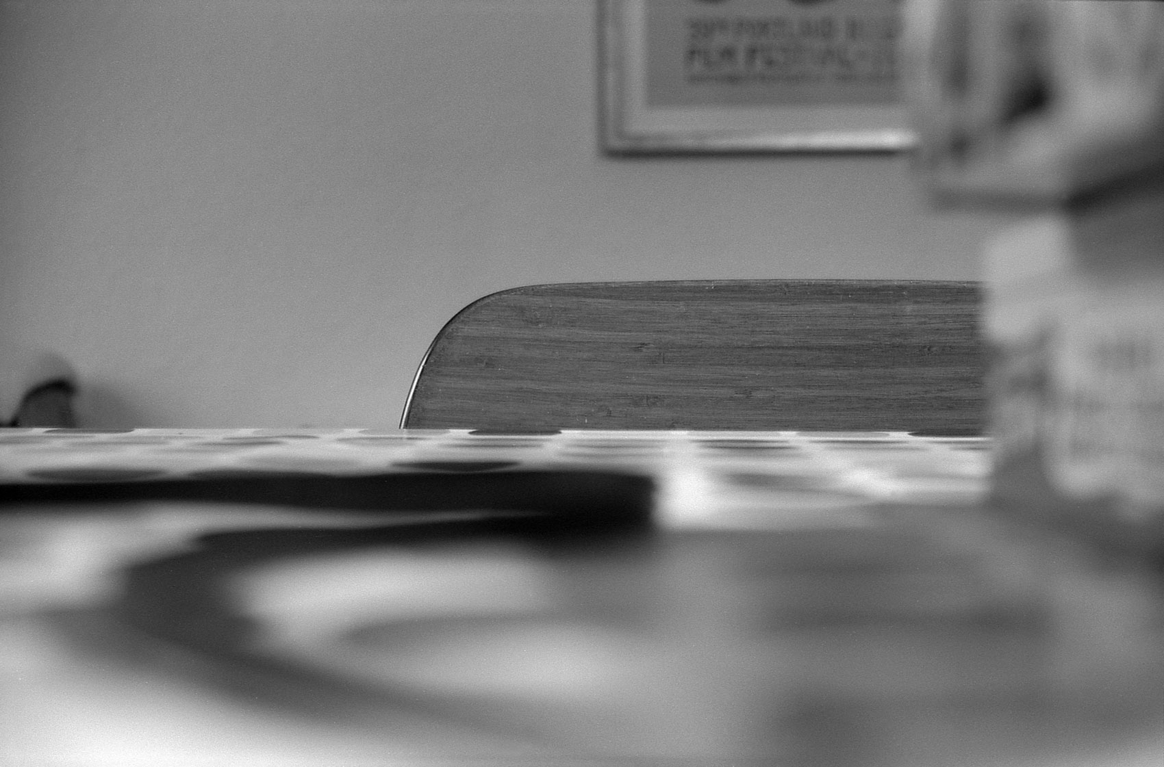

Example shot with the above formulated developer I'll call PC-512 BT v1 just to have something to refer to.
Box speed Ilford Delta 100, Yashica Electro 35 GSN.
Notes:
  • No change in b+f density, remains 0.3 (this is good)
  • Grain is more noticeable, even on Delta 100
  • Negatives are thinner than desired, as mentioned

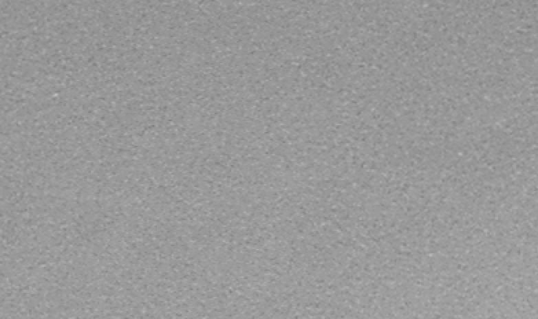

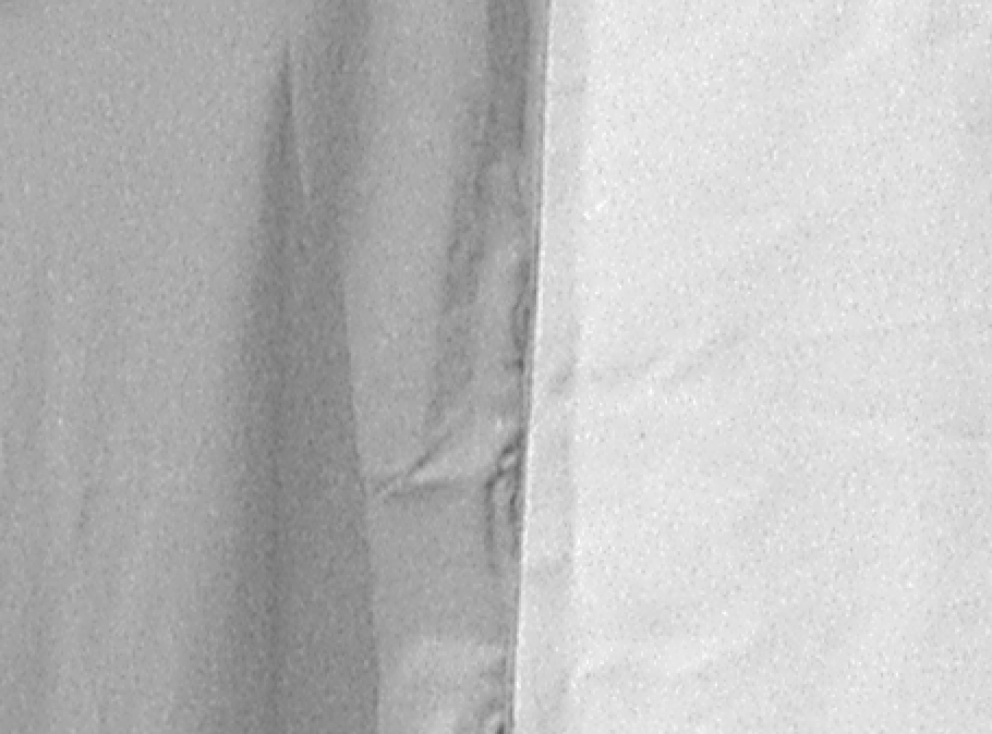

Grain Comparison:
Both clips are 100%, scanned identically. I realize the scanner resolution isn't good enough for Delta 100, but this is still indicative. I would normally expect slightly thin negatives to have reduced grain profile, but it's slightly higher. Of course this could change at final pH.
Grain for BT v1 (thumbnail):
Grain for PC-512 Borax (thumbnail):

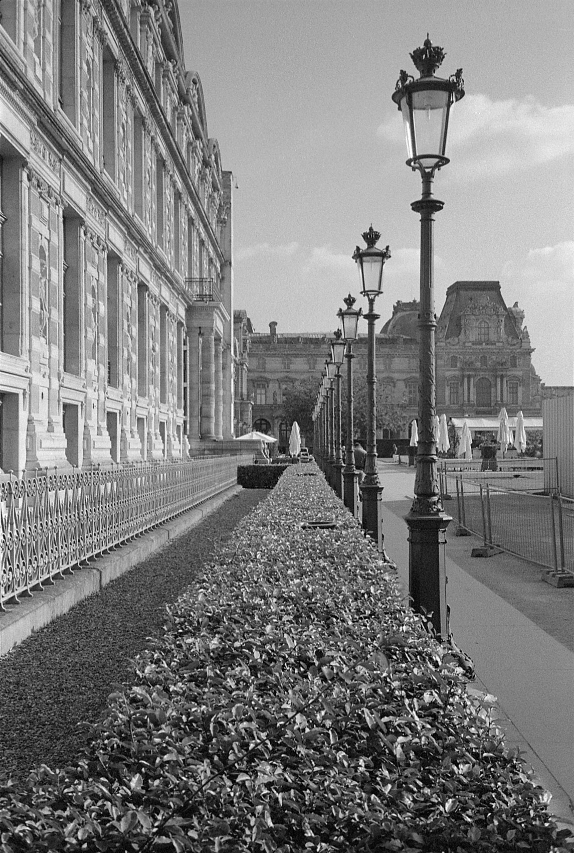

Another shot from the roll of Tri-X from Paris. 1970s Rollei 35S with Rollei Sonnar 2.8/35mm on Kodak Tri-X 400 (Arista Premium, exp 2012) at box speed in my PC-512 Borax developer 1+50 for 6.75 mins @ 20C.
I need to do some testing, but I think I'm seeing a speed boost here with this film. I don't expect to have seen as much shadow detail on the dark parts of the lamp posts. The film is so curly the scans are not perfectly focused. That's the scan, not a camera or developer issue.
You seem to have given the film what I would call "correct exposure."
Film speed is one thing. Use of the exposure meter, placement etc is the other.
Yes, of course. Hence saying it needs more testing. But, I also have a roll from the same camera, exact same film, changed minutes later, similar subjects, same light, developed in XTOL to compare to (same metering with my Gossen meter). Like I said it needs more testing, but I think I am seeing a little bump. I’m lacking time at the moment and have too many projects to focus on this right now though. I’d rather spend time on the possibility for a single concentrate.
