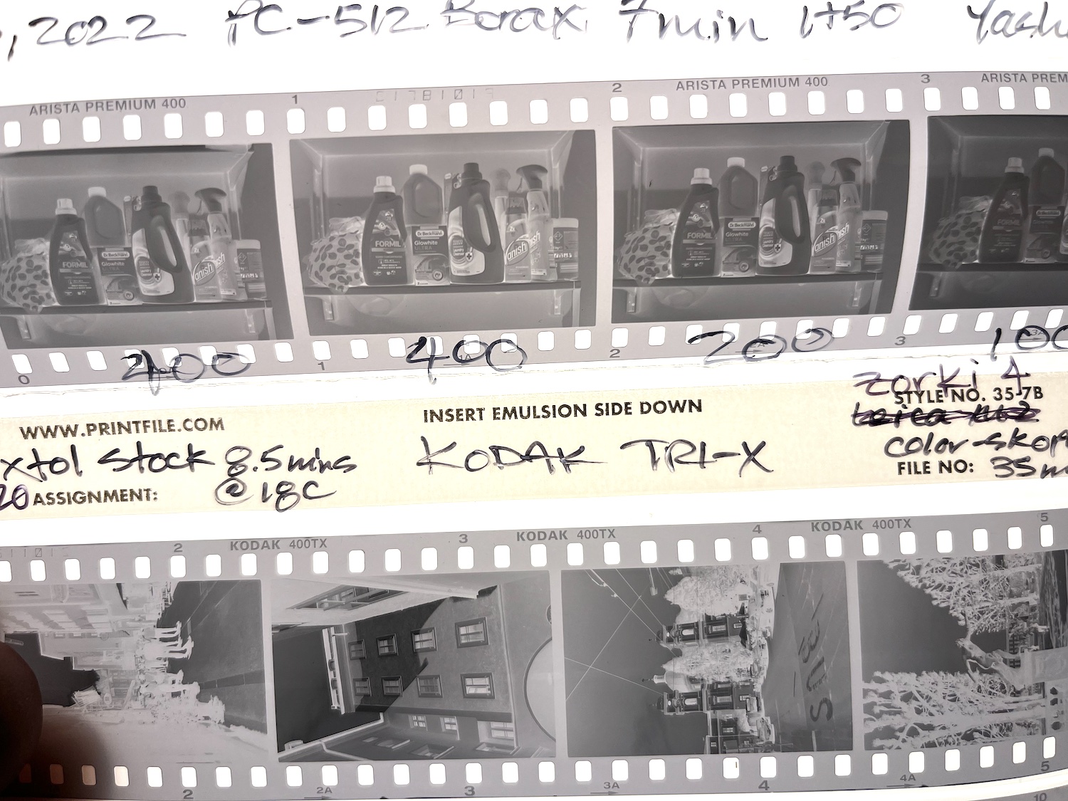

Interesting, Graham, I haven't had low density issues. Fog is a little higher for me than on XTOL (I posted the base+fog densities on Delta 100 are around 0.3). Here are some shots of Tri-X in XTOL stock vs my recent Arista Premium (Tri-X) test in PC-512 Borax. Densities are pretty similar. The PC-512 scene is a bit flat, highest density at 400 is just visible upper left. Sorry I don't have a better example.

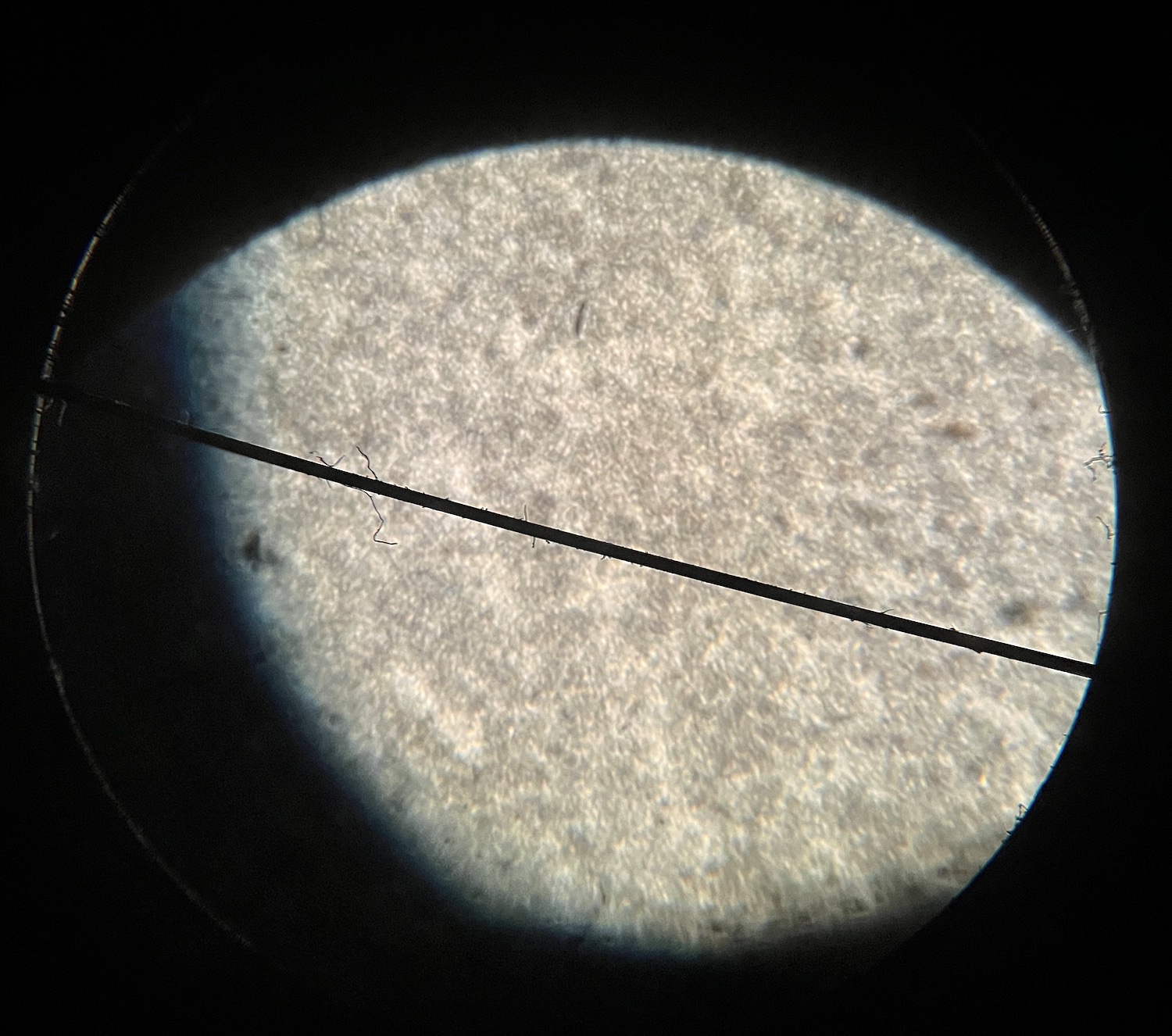

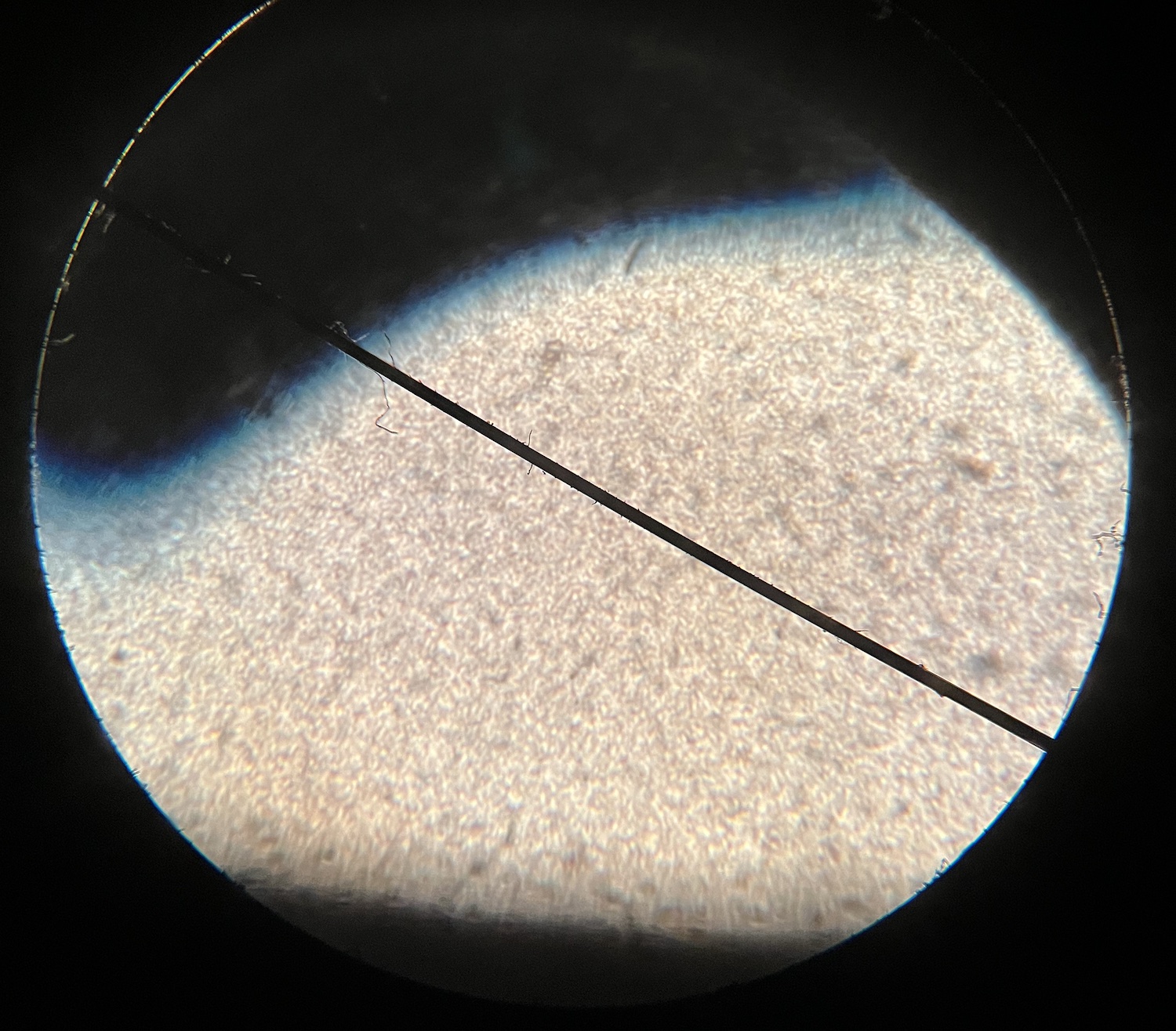

I got the enlarger set up and got two shots of grain through the grain focuser (this is hard!) with my iPhone. Here's grain shots of PC-512 Borax on the left and XTOL Stock on the right. Kodak Tri-X 400 @ 400 in both shots. The enlarger was not adjusted between the shots. The focus here is not perfect, this is super hard with a phone shooting through the grain focuser. I think it does give a pretty good sense of the grain in comparison. The XTOL scene is a bit darker than the fairly flat scene in the PC-512 Borax shot.
CC @albada and @John Wiegerink who were interested
To my completely untrained eye the PC-512 grain looks finer but even if my judgement is correct I have no idea how this translates into grain as it appears in a print
pentaxuser
pentaxuser
To me, it appears that the XTOL shot was of a textured surface whereas the PC-512 shot was of a smooth surface. Texture makes grain difficult for me to assess, but on examining small smooth areas of the XTOL neg, it appears that grain is about the same. If so, that's an exceptional accomplishment.

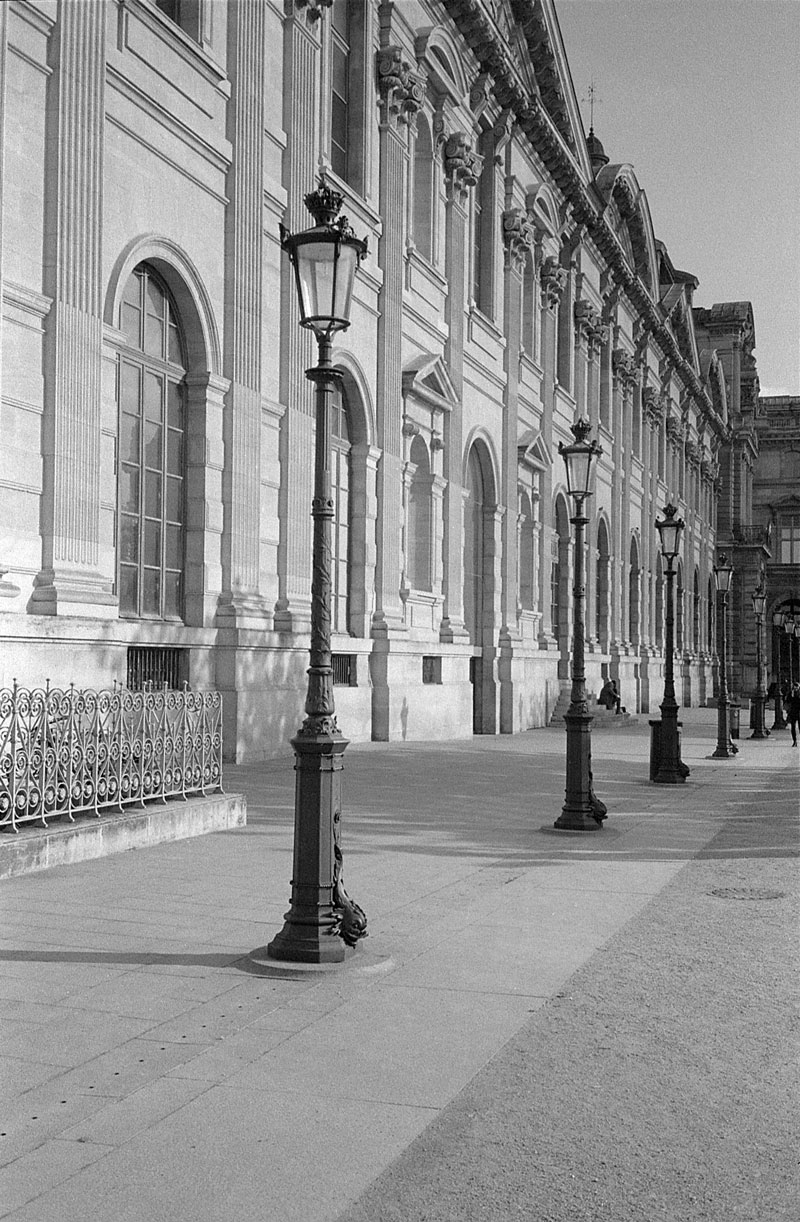

Looking at the sky section, you can see it, but at least it's what I would call "well defined" and sharp. Better than "mushy" type grain anytime, at least I think so anyway. Plus, it doesn't jump right out at you. When grain becomes a problem for me is when I look at a print and can only seem to see or focus on the grain. That's just me and what I perceive to be acceptable grain. Other folks love huge, in-your-face grain. I'm somewhere in between.
Thanks John. I agree, I don’t mind seeing grain if it’s not overrunning the photo. I usually shoot 100 speed films but occasionally reach for Tri-X or HP5. I think this developer does fine here. Well enough that I’ll use it again with faster traditional films.
relistan, the sky in the country road with trees and drystone wall looks pretty grain free to me. Was this a 35mm or 120 negative and is there any way to relate the example to what size of a print this represents?

Yeah with Ilford Delta 100 it is very tiny and smooth grain. That’s 35mm film. That was the film I originally tuned the developer around. I imagine you can take that well past 11x14 though I can’t print bigger than 8x10 right now due to space.
