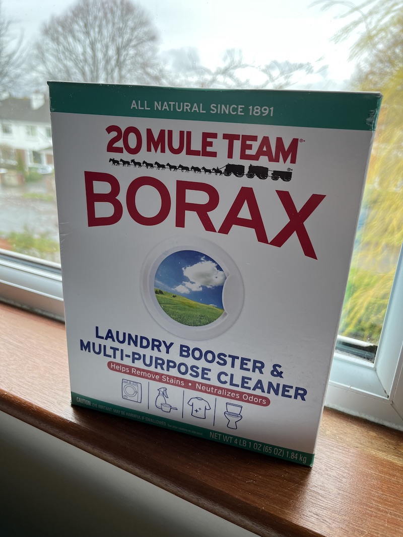

Had a quick business trip to LA and now I'm pretty well set for developer for awhile! Gotta love US prices sometimes—even in expensive California. 1.84kg of borax for about $9. This stuff works perfectly well in this formula. Also brought back 100g of phenidone from Bostick and Sullivan.
While at my second batch of University I worked for a couple of summers as a customs officer.
I guarantee that if I had opened your bag and found this, In would have looked at you and asked something like "You flew all the way from Dublin to LA and back and you are bringing back this!!!!????"
Haha, yeah, you would have found a suitcase full of random shopping: the expat suitcase loaded with all the (non-perishable) stuff that we miss from home.
