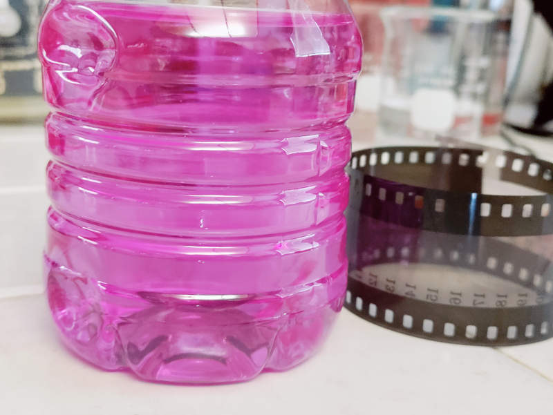

Magenta Mud
A couple of people contributing to this thread are attempting to convert the formula for PC-512 Borax to use sodium metaborate instead of borax. Here's what happened to a developer I formulated using those ingredients:
Pretty, isn't it? And I was developing only 1/8th of a roll in 220 ml of soup, so I hate to imagine what a complete roll would have done. The film strip, shown on right, was very thin. Here's the one-liter formula I used:

This magenta problem occurred in an experiment I tried nine years ago, but I neglected to pursue it. That formula lacked EDTA and carbonate, so they are not the cause.
The good news is that I was able to clear the magenta. Adding ascorbic acid and borax had no effect. But adding only 0.5 g/L of sodium sulfite quickly cleared it. Oxidized phenidone is orange, so I'll guess this magenta is from oxidized ascorbic acid. And that makes me wonder:
Has any of you encountered this?

Weird, Mark. No, I got regular developer and ok negatives, but thinner, from my one experiment above. With the buffer lacking, the pH drifts which I think is the reason it is thin for the same times, even at the same pH. I haven’t messed with it again yet will start a new thread when I do. I used 1.5g of metaborate with the standard PC-512 agents.
I can only guess at the reasons for the color. I assume it is the dye from the film reacting with the developer somehow.

I never had a turn in color like that when I mixed my batch using Kodalk. When I get back home I'm going to play with PC-512 a little more and see what I can get out of it.
