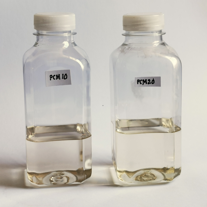

In case PCM20 should crystallise I made up a half strength concentrate PCM10 for storage [pic]:

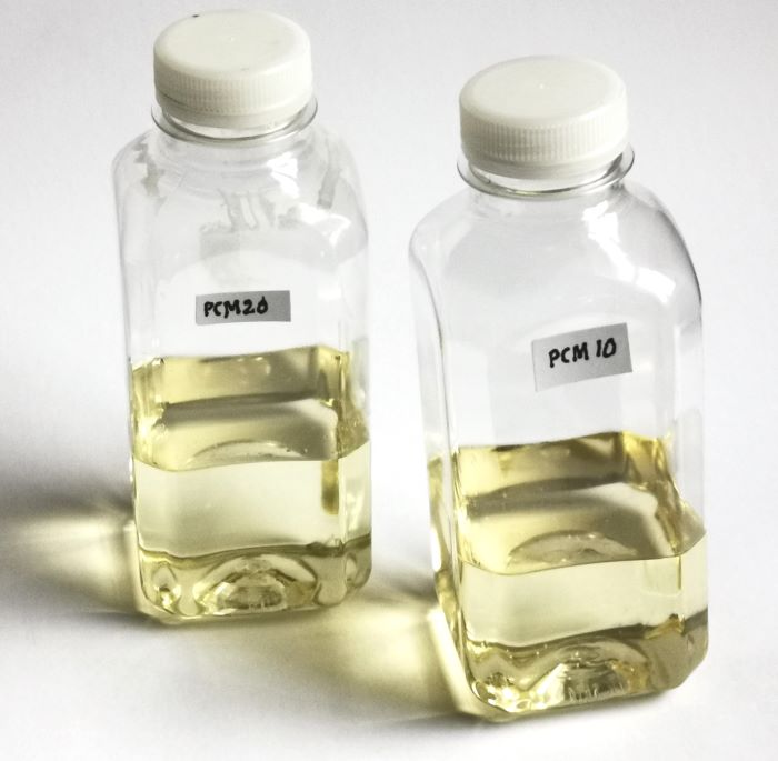

After 6 weeks the color of PCM20 concentrate had a yellow tinge [attachment].
These two illustrated are kept for a shelf life study with occasional opening of the caps to let air in.
The separate sample I use continues to give satisfactory results, eg:

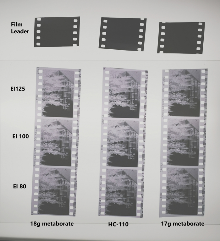

Here are the results of using 17g or 18g sodium metaborate per 100 ml ,all developed 1+50 for 7.5 min 20C to compare with HC-110 1+47 for the specified time 7.5 min in the massive development chart.
The film leader with 17g metaborate is somewhat lacking in density and 18 g metaborate per 100 ml more closely matches HC-110, although it is rather hard to see from the attachment.
All get about EI=100 for this film, Delta 100, with evaluative metering [matrix metering Nikon].
I will make a field test using 18g metaborate to check before posting a formula.
