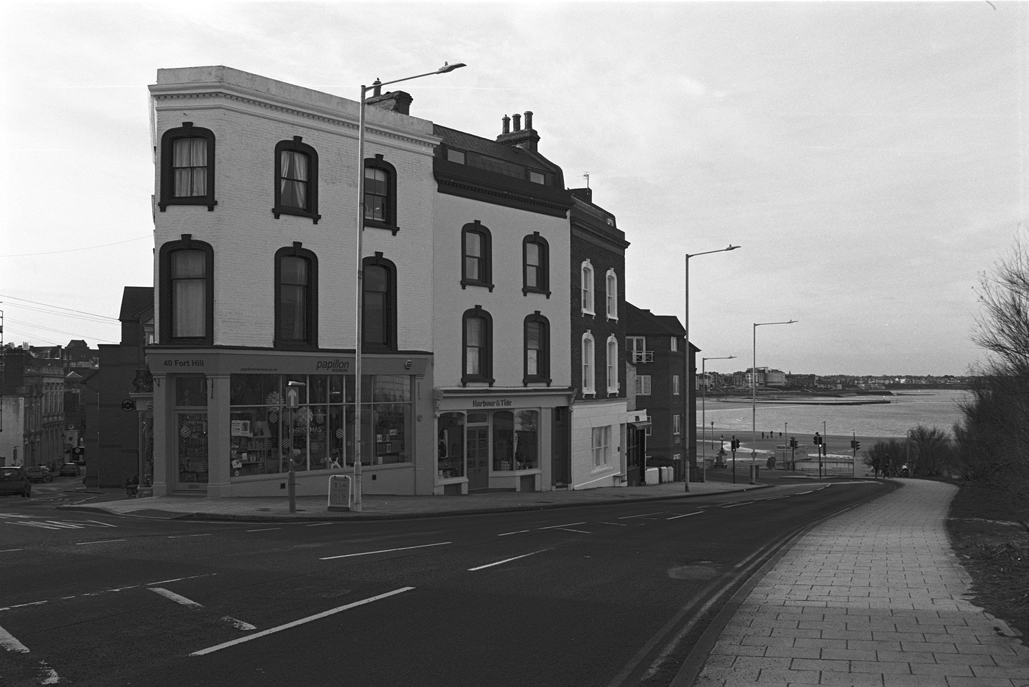

Provisionally, only tested for Delta 100, develop for the time given in the massive development chart for HC-110 or Ilfotec-HC, either diluted 1+47.
Results for a trip on a sunny day are shown, a wide range of subject brightness is captured. I don't have a densitometer.

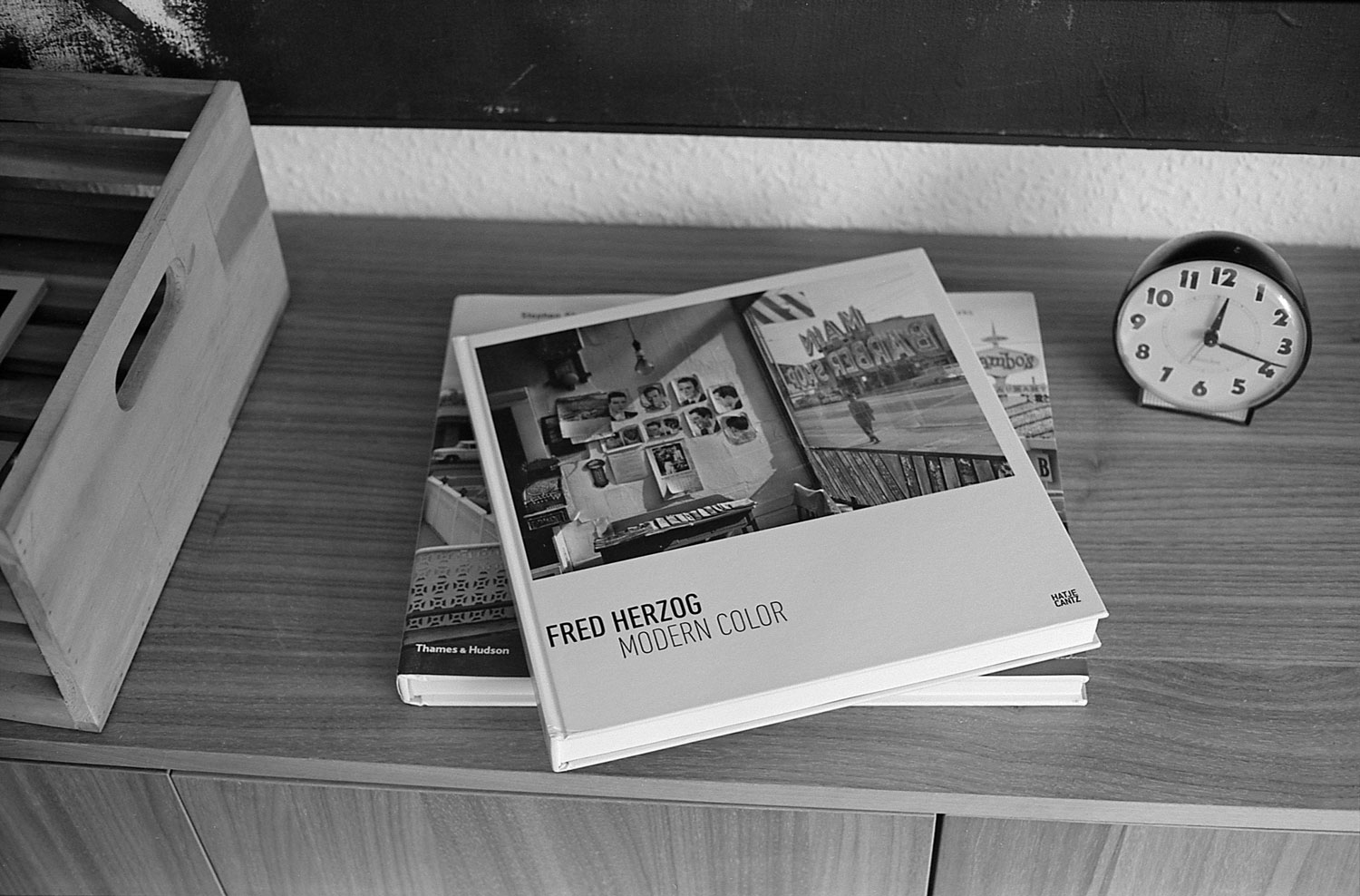

The attachments show pics from DCM18 and PC-512 Borax at 1500 pixels wide.
If zoom in to the grey wall above the shop and the grey book cover it appears that digital jaggies are larger than grain at 1500 pixels wide and the comparison regarding grain is inconclusive.
There is little incentive to make a better test as there appears no intention to change either formula.
