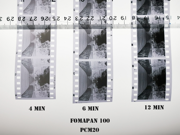

I tried test 1 formula above with 20g/100ml as suggested by @relistan. Call it PCM20.
PCM20 one shot concentrate:
Propylene glycol ..............80ml
Sodium metaborate.........20g
Ascorbic Acid......................12g
Phenidone ...........................0.5g
Propylene glycol to....... 100 ml
It can be made in a container partly immersed in very hot water. The ingredients dissolve with stirring at 60C , with some effervescence around 50C.
For use dilute 1:50 with tapwater.
The viscosity is low and it is easy to syringe and mix.
Results of developing Fomapan 100 @ EI=100 for 4m, 6m and 12m 20C are attached.
Here is a test shot developed for 6m 20C:
I believe @albada found 15g/100ml metaborate in glycol was stable after 4 years [did not crystallise], here using 20g/100ml.
I did try the formula with only 12g/100ml metaborate but at 1:50 the negatives were extremely thin after 12 min development.
It seems that 20g/100ml is a good compromise.
Photoformulary and Fototechnik Suvatlar list sodium metaborate.
