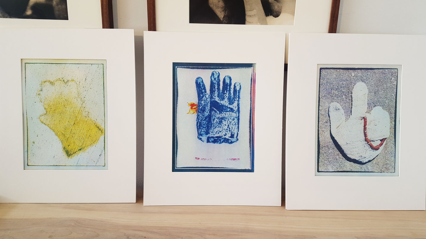

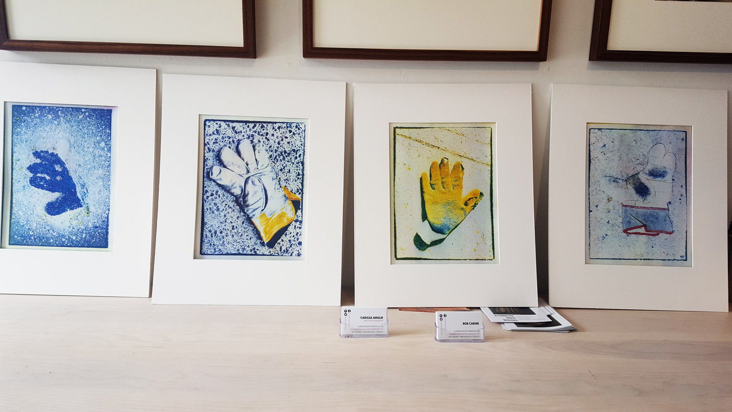

The tri colours in matts, I am particularly happy with these prints.. I feel that the final abstraction, or the final look or the final end point did match my thought process, they are not perfect and they never will be .

Very nice prints, Bob. They are looking very well in matts.

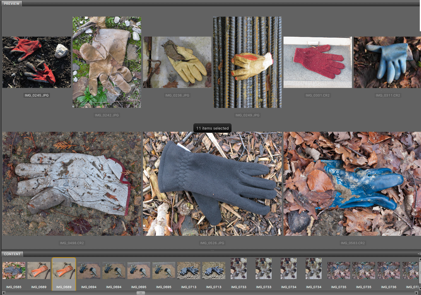

Glad to know now that I am not completely crazy, there was a period when there was a big building site around our town as they were widening the rail lines by two additional tracks.
While the builders were here I started noticing hundreds of abandoned gloves everywhere of all shapes, sizes & colours and began photographing them in situ.
I now have several hundreds including kids mittens etc. Nice to see that they could be put to some useful presentation.
See attached screen grab of a small part.
Interesting... the photographer in question Skip Dean travels on Urban roads day in day out, and has a collection of gloves and crushed objects, oil slicks , potholes you nameit.. his project is called roadworthy art
