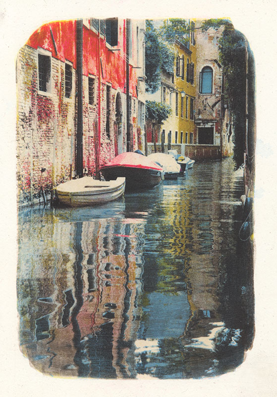

I've followed a different path for multi-layer gum prints in the last 3 month. A lot of trial and error, as well...
I made CMYK separations and applied different adjustment curves for each color. The K layer was the last - a Palladium layer over the gum color layers.
Still a lot to work on this method but, IMO, promising...
My best color balanced result till now (but, well, the layers alignment is a bit off..) is this:
Gelatin sized Fabriano Artistico 600g/m2.

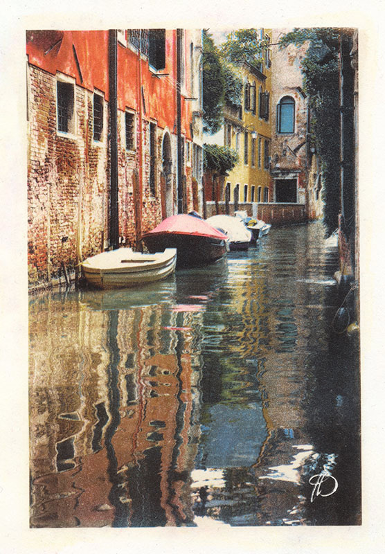

This is an earlier, better aligned test with 2 gum layers/color, 1 layer of Palladium, different exposure times and the same adjustment curves as in the first test.
The color balance and saturation is different with 2 layers/color, of course.

Interesting I would like to try palladium over the gum layers - Curious did you have to do some kind of sizing layer over the gum... if not how did the palladium get into the gum layers ??

Yes, after the gum layers dried I applied a gelatin layer, otherwise the Palladium washes away. Palladium over gelatin needs a longer exposure (~ 2 times longer than usually).

So the palladium soaks into the Gelatine?? this sounds like a great finish of the final print.

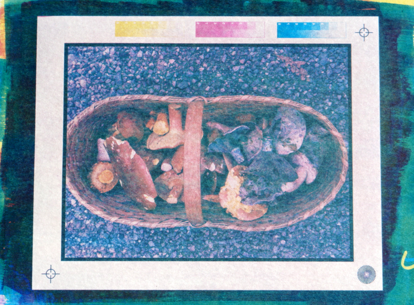

I am reporting my first baby steps in tricolor gum or any gum for that matter. 2 weeks ago I just went to the local art supply store bought some gum and water colors and after doing a few test strips and one totally failed attempt, I got this
Which is too dark and too much magenta... Note these mushrooms do have really striking colors and are all edible and were quite delicious. The picture was taken with an Iphone SE.
The upshot: I encourage folks to try this, it is an economical process and first results are fairly easy to obtain. Now, getting great results may be a whole different game...
Next I will try this print with 1 stop less magenta and 1/2 stop less cyan exposure.

Very nice, fraunhofer. Which pigments are you using? I've noticed huge improvements in my gum prints by switching to better pigments... Daniel Smith.

Thanks. I use student grade Newton & Winsor Cotman, but I got a package today with Daniel Smith colors and some Fabriano paper...
