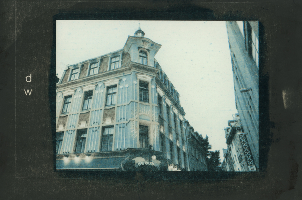

quick update, I've managed to get a cyan layer to stick on a test print (also on sized lith print) by doubling the exposure and washing for longer, and i'm currently exposing the proper image now, so fingers crossed eh.
and so it looks like the gum needs more exposure when layered on top of silver gelatin paper, my guess would be because the gum isn't sinking into the paper as it would on watercolour paper (?).
Post some pictures of your progress, would be nice to see.
will do, I'm happy to say that the latest print has worked, although it's a little uneven, which I think is due to so many attempted coatings and washes. The paper seems pretty tough tho'.
I'm just waiting for it to dry completely and will post an image of the lith + cyan layer in the morning.
Thanks for all the help everyone!
The blue* layer has dried completely now and looks to have worked, but I guess I'll see for sure when I try the next layer.
There isn't a huge amount of detail in it because it's a tiny little print. When I had this idea I only had 1 sheet of transparency left, so all 4 layers had fit on 1 A4 :smile:
Once I get the technique down I'm hoping to make larger prints and hopefully more of the lith texture will stand out.
Other than that, the registration is a bit off, but only on the right side of the image, which would probably be more visible on a larger print. It's a little weird tho', it would seem that the lith image is larger than the other layer's negatives, like as if it's stretched rather than shrunk.
anyway, here it is...
*the blue is Winsor & Newton Prussian Blue

Looks lovely....

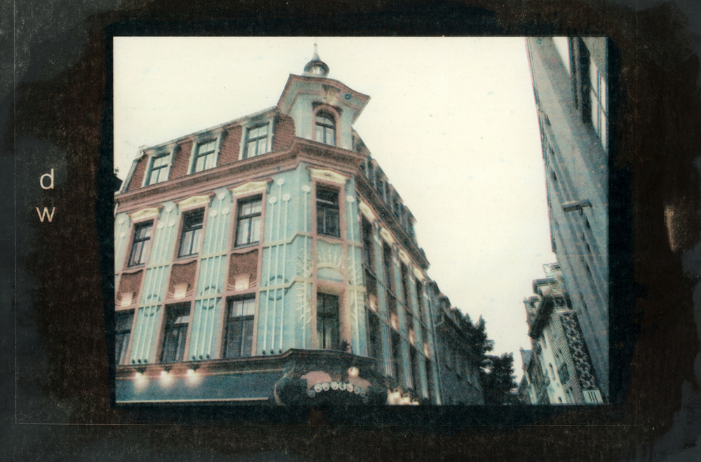

I finally managed to get the other layers on and they went down without any trouble at all. I'm pretty happy with how it turned out and for the moment there's only one layer of each colour, but I'm thinking of adding another layer of yellow to bring it out a bit more.
The only thing left now is to clear a little dichromate staining, however last time I tried that the sodium bisulphate also bleached the lith layer, so if anyone has any alternative suggestions I'm happy to hear them.
So here it is a - tri-colour gum lith
*the building (in Riga) by the way, is those colours... more or less
That looks really good! I'm quite impressed! Just a guess, but maybe toning the print with selenium or something might help with the bleaching.
That's what the guy did above. The problem is getting enough tooth for the gum to stick [...] Though, I've found using a PVA size makes sizing your own paper a lot easier. It's just one step, comes in a bottle as a ready to use liquid, non toxic, goes on smooth with a foam brush, and cleans up with water. It works even better if you heavily dilute it 4:1 with water, and apply it after every layer of gum (after the gum has fully hardened, of course). Plus, it's not staining on the first coat that usually causes me issues. Its staining on the later coats that I usually have to deal with.
thanks, and but since that first one I've been having problems again, so it seems a bit more hit and miss than I'd have hoped. The clearing didn't end up being such a huge problem in the end, the solution *so far* is to simply soak the finished print (once all layers are dry) in clean water over night. It's not perfect, and there's still a little yellow staining on the reverse of the print, but nothing that shows through. How it will change over time we'll see : )

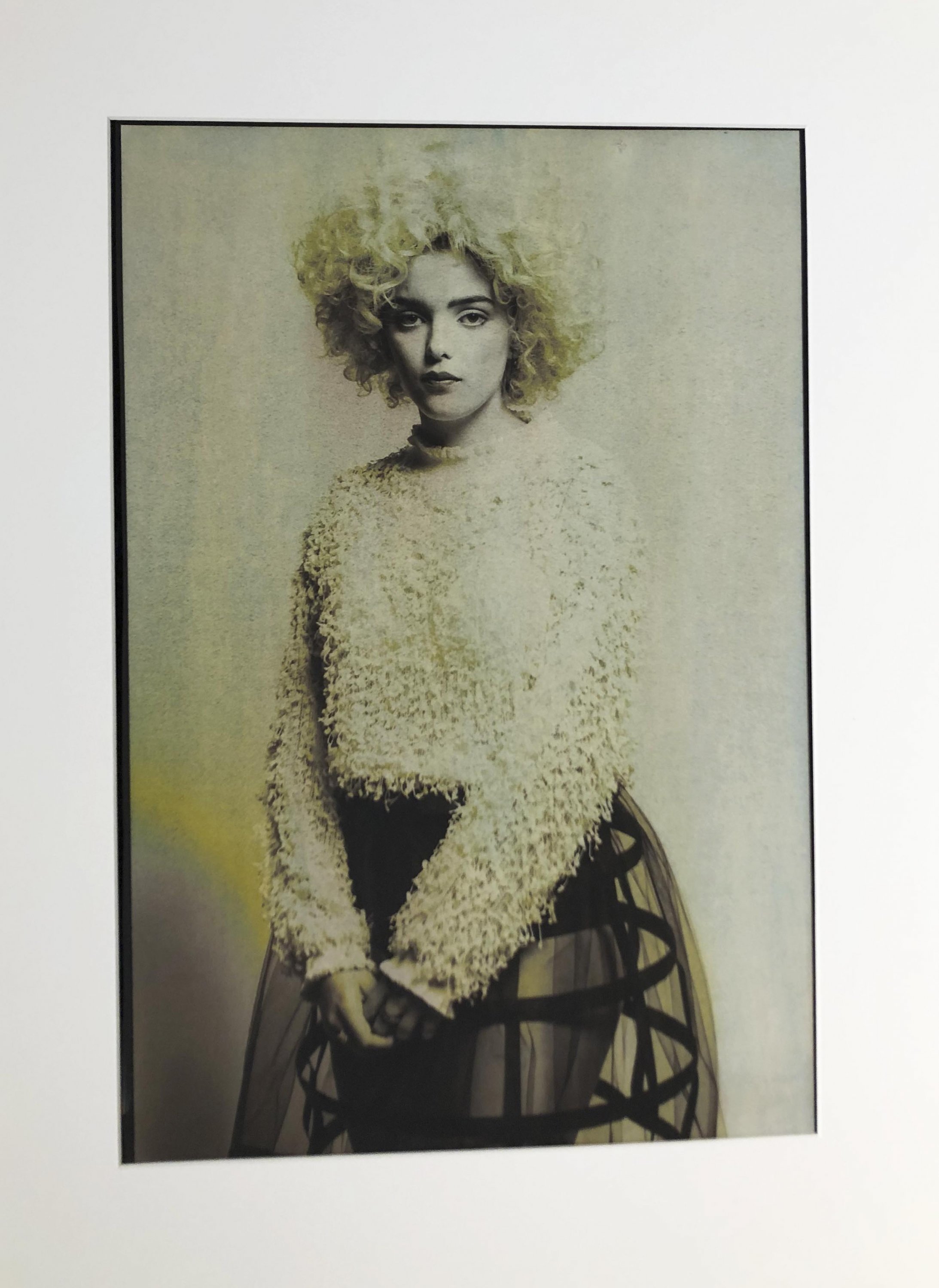

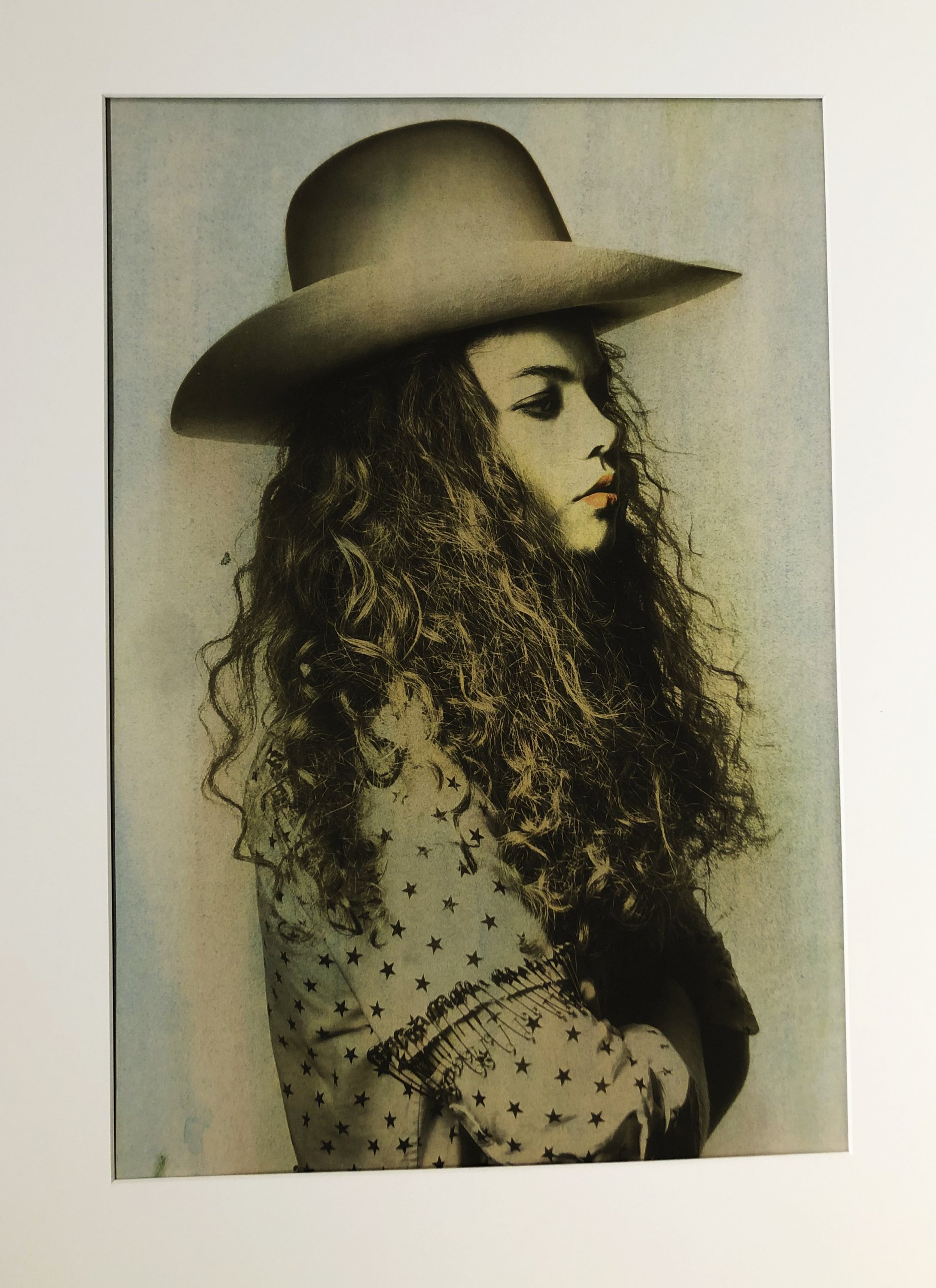

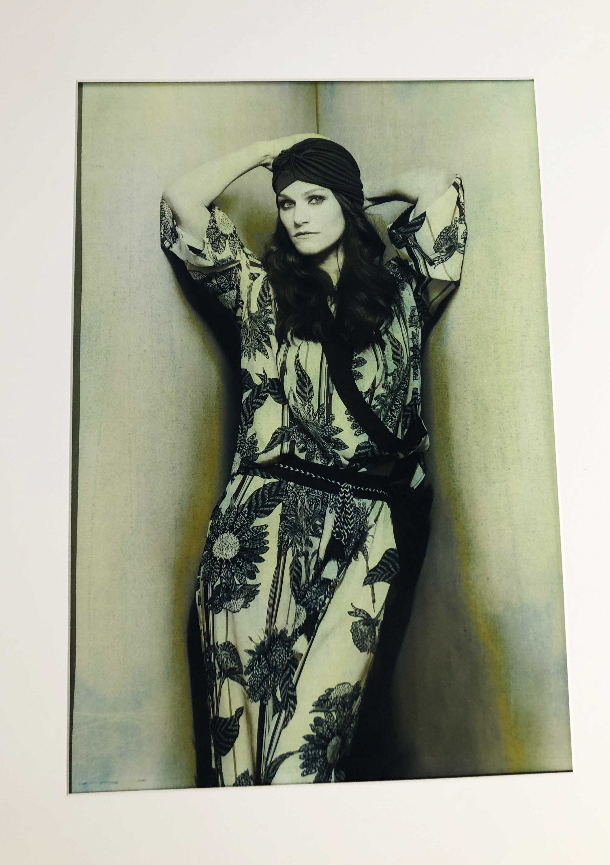

IMG_5210.jpg IMG_5214.jpg IMG_5211.jpg these three images are by Brendan Meadows and are heading to Photo LA later this month.... tri and duo gum over palladium, some have extra hits to build up colour and some brush work is used to keep the original palladium tone intact.
Have been playing around with colour saturation for the past 6 months and this is probably the best one so far. Through trial and error... lots of error... I increased yellow exposure by 3%, layed down magenta twice (both same exposure), and finally increasing the blue exposure by 10%. The Red of the coke machine really comes forward now.
