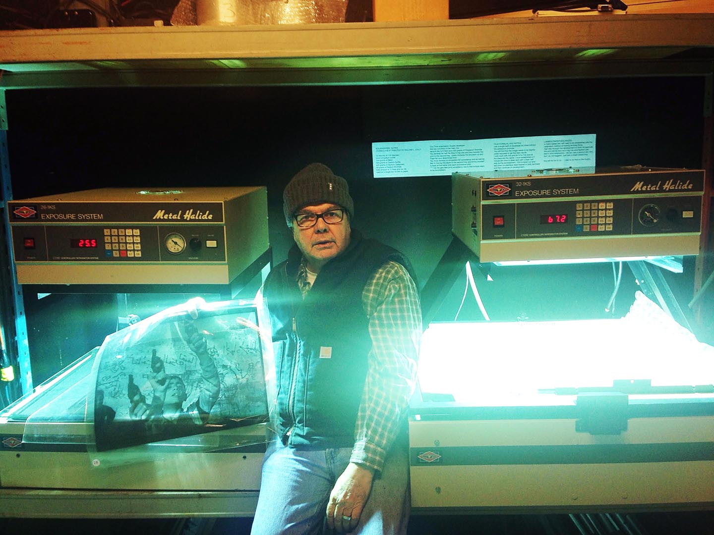

bobs friends.jpg Just added my new plate burner and set them together, really excited to balance in the new machine.

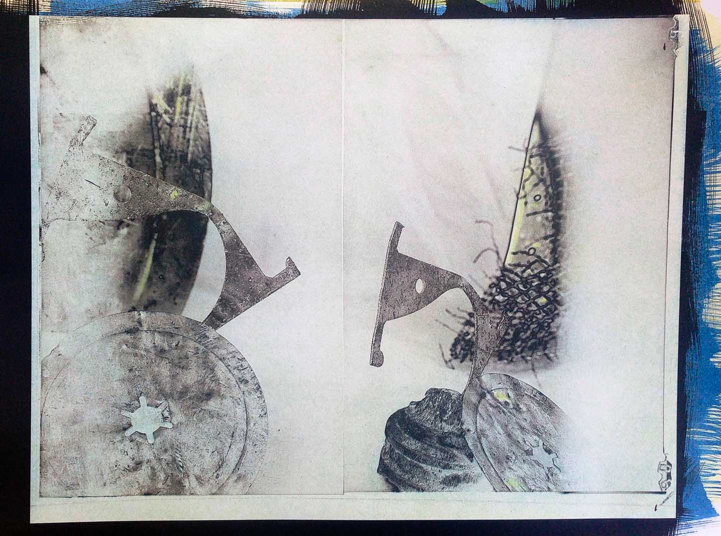

Dragons.jpg I would like some feedback on this type of image, I am working on a new series and would like to hear negative and positive comments.. I have a thick skin.
View attachment 192918 I would like some feedback on this type of image, I am working on a new series and would like to hear negative and positive comments.. I have a thick skin.
Overall, it's quite nice. The faded edges to the objects within the hard borders bother me a bit. It feels a bit claustrophobic and unfinished to me because of that. I think if there was more depth within the photo, or the border wasn't so defined, it wouldn't have bothered me so much, because fade might have suggested an infinite space. But with the shallow background, fairly uncluttered composition, and a hard border around the edge, it feels as though as only a small area within the normal frame of view is being withheld, which makes it feel unfinished to me. It's especially jarring in the wire mesh object in the background of the right side, which leaves a large portion on the right bare and unbalanced. I think the left side works better, because the fade out isn't so drastic and abrupt. It can be made to work if it feels more deliberate, like how Francis Bacon did with his screaming Popes or in Frank Eugene's "Adam and Eve". That's my only real complaint.
The textures are great! I think gum was an excellent choice as gum's natural texture really compliments the texture of the subjects you chose! I love the subtle use of color as well! Initially it feels rather duo chromatic, black with a splash of yellow, but the yellow invites you to dig deeper revealing the blue and soft red. It gives it a nice depth that encourage you to explore the picture on a micro scale, further enhancing the textures. The composition, especially on the left side, is really nice to! There's good overall balance of light and dark with plenty of negative space. And I don't know if it was intentional, but I really like the clips on the top and bottom of the far right side border. They're fun little geometric shapes that are just waiting to be found and inspire you to seek out more colors and textures beyond the picture itself! They feel like tiny ambassadors between the picture itself and the real world!
Thank you Jim.. I should point out that when I actually show this I am getting the matt to cover the border crap, but I do keep the clips in as I like them as well.
I kept the borders in to get opinions on this aspect. personally I do not like seeing the brushstrokes or rebate, whereas many like them so I left them in for conversation.
Bob
The colors are amazing. Even on the screen they make me feel like the image has texture and the look is almost 3 dimensional. I have no idea what I'm looking at which also really grabs my interest as a viewer. Especially those twisted metal bits or whatever they are.
When I cover up one side or the other of the image I really don't find that it works as well, I really like the way they are paired. But I find the line down the middle jarring. I would like to see how these look presented with a two-window matt that covers that line up.
I see two strong images - side by side.
Have you tried that?
the idea on this series is that the lighting , the object positioning is in the exact same spot for each separate exposure, All I did was move the position of the camera, refocus and expose. I was using a old jury rigged passport camera designed to take to images on a single film for clients.. I used the lens caps for covering each side, I like the way the split up the middle comes off as it is really retro first year college photo merge...
In this series I do have singular images when the piece of metal is strong enough to hold by itself , the duo image is for sure the way I want to go with this.
thanks for the tips you all.
this whole series is based on recycled or used materials, food, dresses, bikes , cameras , in this case aluminum, which gets reused time and time again,and we take for granted. With the metal I tried to create fantasy images, this particular one reminds me of Hobbit dragon Smaug. Or something out of Harry Potter.
I would install some more plate burners and keep them running if it is that cold in your lab :D
PS love the dragons and yes get rid of the gap in the middle and surrounds, maybe faded (vignette)
