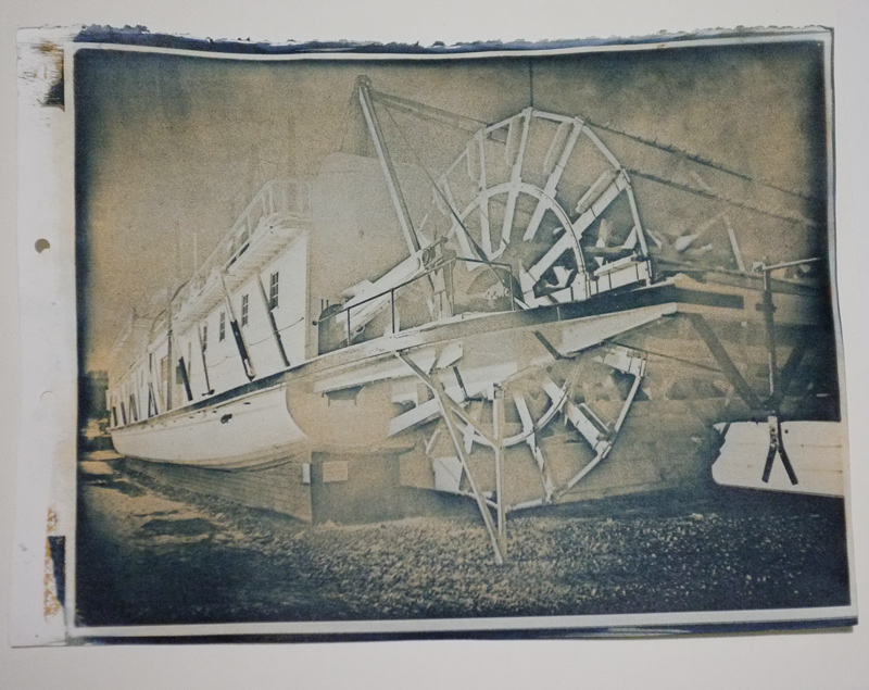

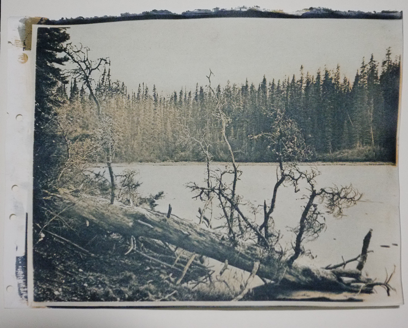

I dug up some old cyanotype solutions I was given in a box of stuff from another photographer. No clue how old they are but for sure more than five years. Anyways they still seem to work fine so I made a couple of prints.
These are from 4x5 negatives enlarged to 11x14 on Arista lith film. This is the largest size paper I can use in my contact frame. Next time I'll print the negatives smaller to allow for more of a border on the film as this caused some issues. Also at this size I have more problems with registration vs 8x10, my little two-hole punch isn't enough.
I deliberately made the negatives with a lot of contrast. The cyanotypes had good deep shadows and clear highlights. I put a layer of brown gum on top and then a blue-gray on top of that. Lots of brush work on the boat to try to keep it fairly white. (Also note: Some of the foggy looking areas in the print of the boat are ice fog, it's on the negative.)
Sorry for the poor photographs but this is too big for my scanner.

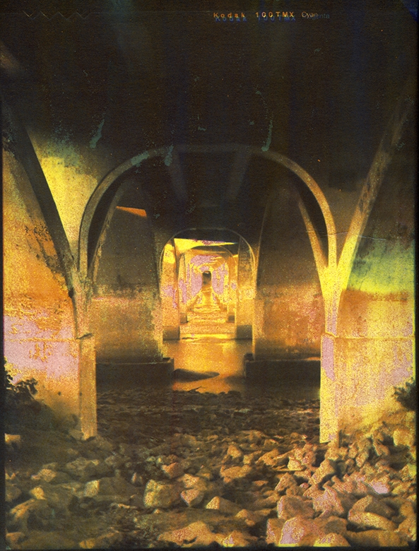

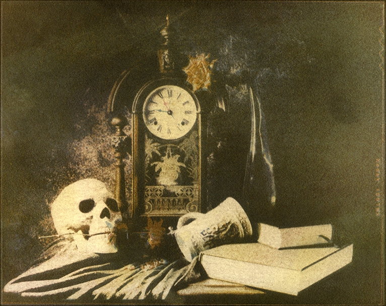

These only slightly belong here because they weren't digitally altered, other than scanning, enlarging, and printing larger negatives. They are 8x10's printed from 4x5 negatives. They are both a cyanotype base with gum bichromate red, yellow, and black layers. I photographed them with TMX 100 using RGB filters to get the color separations which introduced the element of time into the compositions. The shot under the bridge was taken in a matter of 30 minutes while the still life was taken over the course of a week. I underexposed and overdeveloped the RGB shots to get more contrast, and exposed the black separation normally and without a filter. They took a lot of tries to get the exposures right (or good enough) for each layer, so I have quite a few that didn't turn out so well (I actually have one of each that came out better, but those are mounted and more difficult to scan). The bridge was especially difficult, as I had to manipulate the highlights with a water hose, which explains all of the flaking. I won the best alternative photo contest in the Oklahoma State fair with each, the bridge in 2016 and the still life this year! I think I'm going to start moving into digitally manipulating prints with curves off a single color photo from here on out, as that would make printing a whole lot easier and more consistent.

You went old school In camera separations , then re registered on multiple coatings and exposures.. I like the bottom skull image more than the bridge but quite haunting and good work.

Thanks! Yeah I did! I work at a print shop and was curious as to how they made printing plates back before computers and stumbled across this process. I thought it would be fun to try out. The bridge took me 24 exposures (6 different attempts) to get right, and the still life took me 5 (I loaded one of my darkslides in backwards, so I wasn't sure if there was film in there or not, hence I took one extra as a safety). I also printed the bridge probably 20 times and the still life 8 times trying to figure it all out. So there was a LOT of trial and error involved. But I think for my next few attempts I'm going to go the single color negative with Photoshop curves and see how that goes. This method is just too expensive and time consuming.

Why is this so difficult? Three shots should have been enough...
The red filter shot is made and using the filter factors to get the correct exposures bang on for the others...
Do I miss something here?
Well, I did 4 color, not 3, so the black layer didn’t use a filter. But the reason it took me so many exposures to get it right is because I didn’t use photoshop curves to make my enlarged negatives. So I had to underexposed each shot and then over develop the negatives to give me more more contrast to make the negatives print well with the gum bichromate. Also, I used a cyanotype which didn’t need as much contrast, and the black layer didn’t need as much exposure or development since it wasn’t going to print at 100%, or it would make the final print too dark. So basically unlike a normal silver print, I had to make a bunch of negatives that look pretty horrible on their own, but work well together in the final print. I also had to vary the print times, development times and methods, and formula concentrations to get these to work. And even after all of that, they didn’t turn out much like how the actual scene looked.

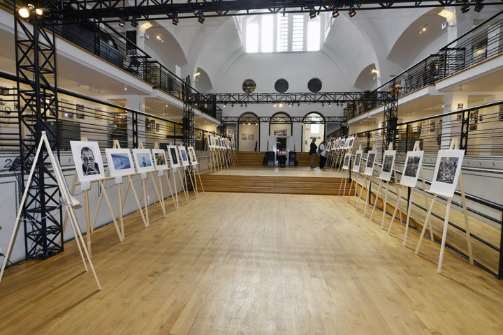

These are some images from our Kindred show in Montreal at The Ecomusee Du Fier Monde gallery space. We popped up for an evening and day and the show will move
to our space in Toronto, Included in this show were over 36 alternative photographs from photographers in Ontario, Quebec and one of our own APUGErs from Yukon.
working in Silver, Lith, Gum TRi and Duotone and Pt Pd is a challenging experience for me but I really enjoy the experience.

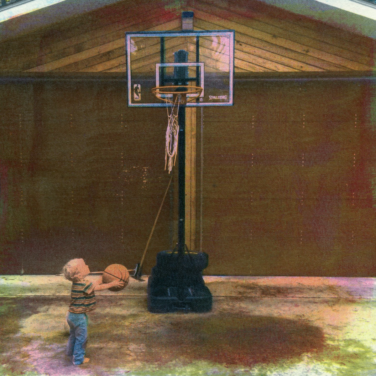

Please ignore the poor quality of the print as this was more of an experiment. I was just registering negatives by eye and taking little care with coating and washing so it ain't pretty.
This is three colors of gum (CMY) coated onto a silver gelatin print on Ilford Multigrade Art 300 (K layer). The original source was an iPhone image, I printed the color separation negatives on transparencies at Staples.
I couldn't find any information online that someone had tried this combination so I figured I would give it a go. The yellow layer went on somewhat blotchy and to a lesser extent so did the magenta. The final cyan layer coated quite nicely, which leads me to believe that if I sized the paper on top of the silver gelatin image I could get quite good results. Will keep playing around.
