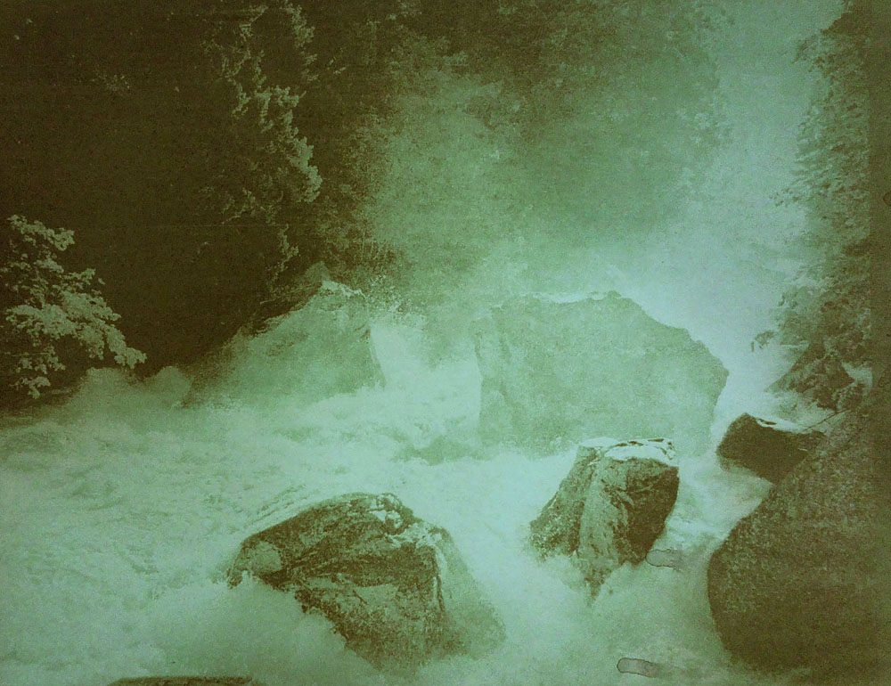

These images are from a Fun with Gum workshop we just had over the weekend..
Over thirty images made with all kinds of success from excellent to lousy.
I attribute lots of the lousy prints due to Operator Error.

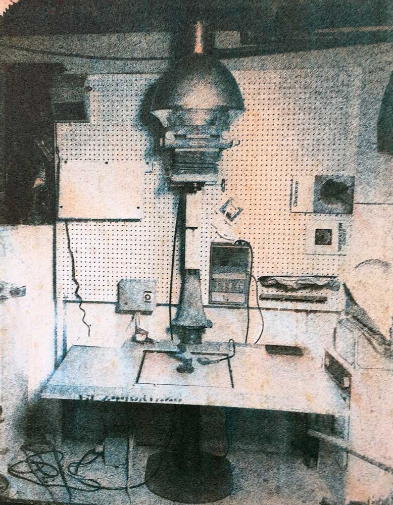

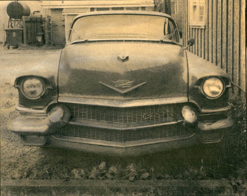

Images courtesy Len Middleton - a member here- from the weekend workshop.
He says that he did colour printing on this old enlarger , I think Len is crazy

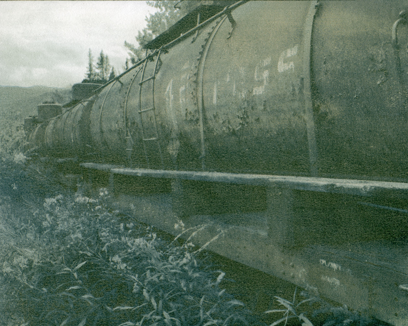

Images courtesy Stephen Chen from the same workshop
two different versions of the same image - this image was difficult to make.

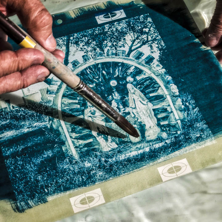

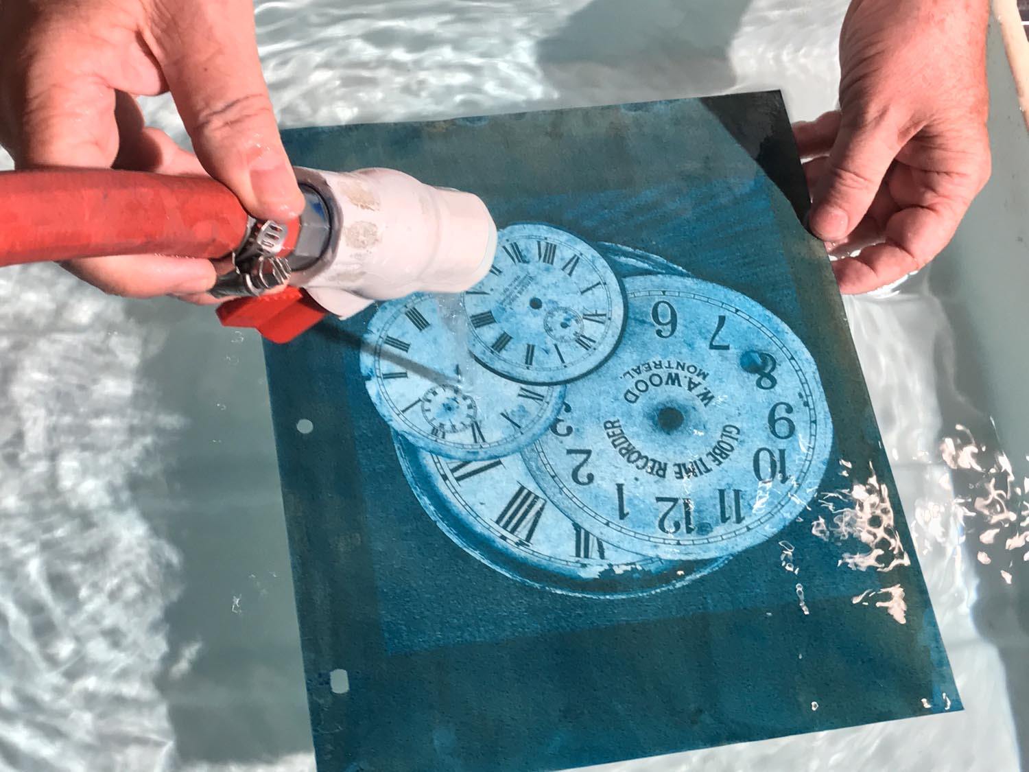

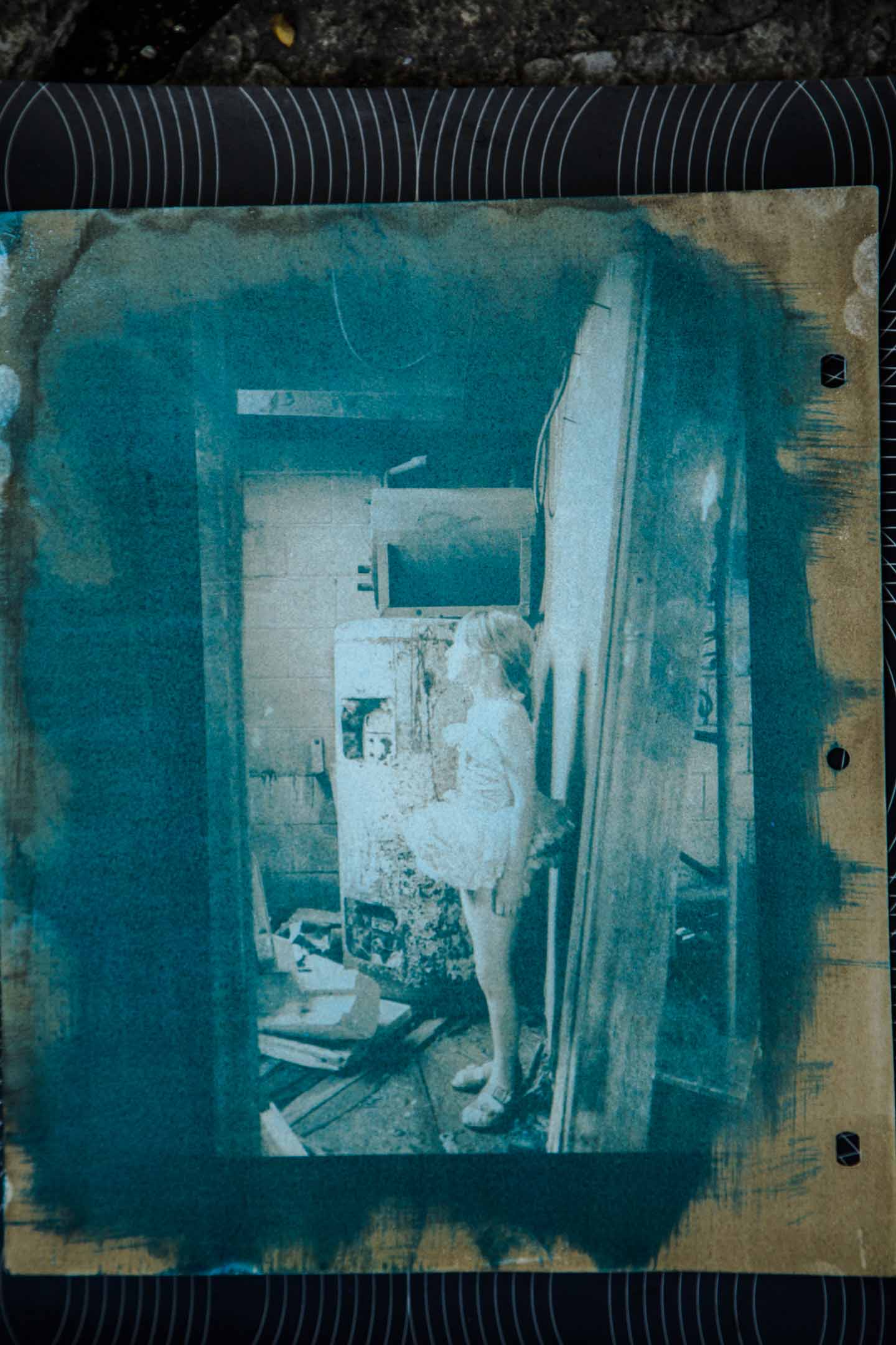

Bob 1.jpg Coating open room.jpg Thomas Brasch 3.jpg Thomas Brasch 6.jpg Thomas Brasch 1.jpg Thomas Brasch 7.jpg

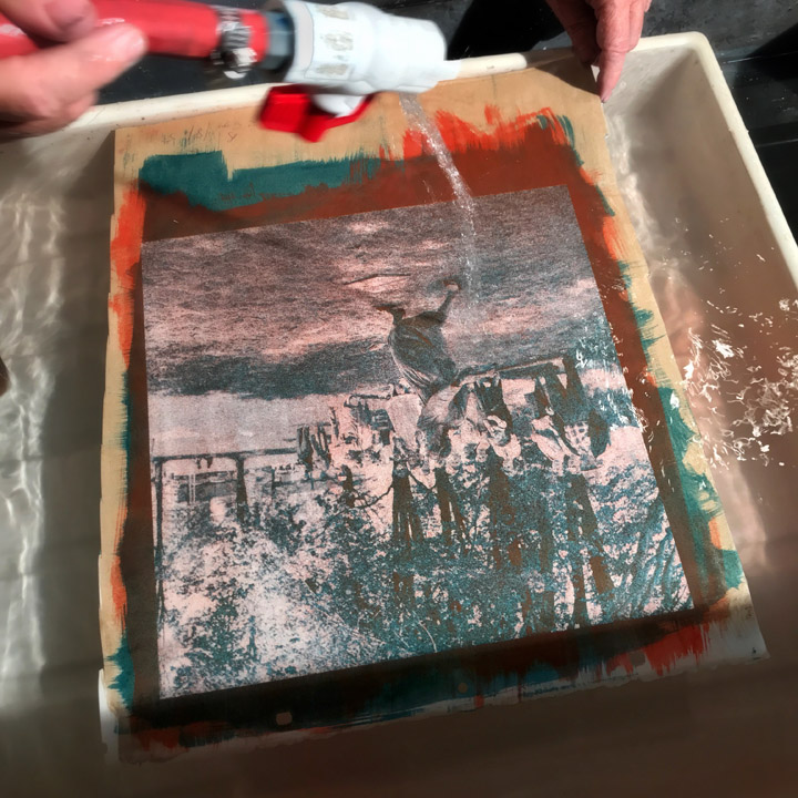

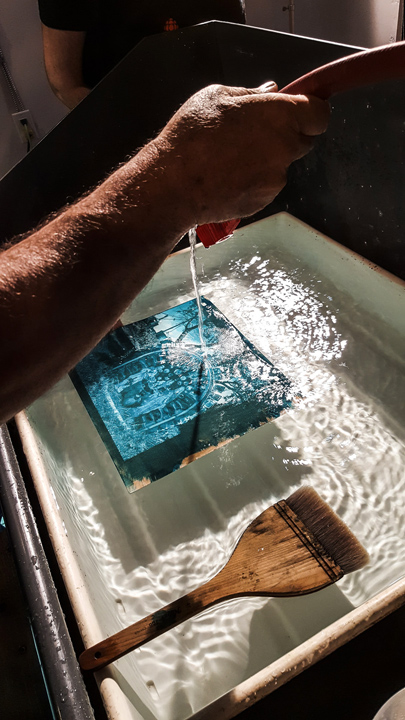

All Images courtesy of Thomas Brasch ...
As you can see for this workshop we worked upstairs in my gallery for coating paper under the gallery tungsten lights, and we did employ some brush work this weekend
as we were concentrating on Duo Tones primarily and for this type of work water hose and brushes reveal the first layer quite nicely.

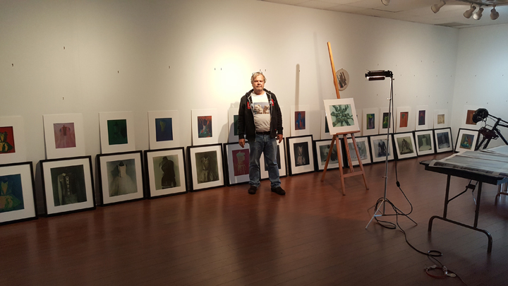

Here I am getting ready to select the show going to Propeller Gallery opening Sept 21.
All these prints, even the frogs(not mine but Thomas Brash) are Multiple layer Gum Prints... the bottom row already framed are Duotones from Black and White Solarized film and the smaller
Matted prints on top are tri tone from colour solarized neg .
This is a lot of work preparing for a show, but as a printer I feel it is necessary for me to stretch myself and do shows so I can relate to the experiences my clients have.

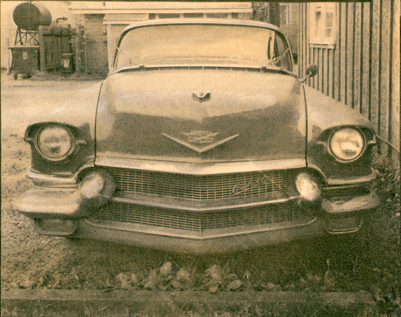

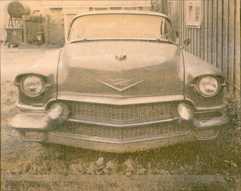

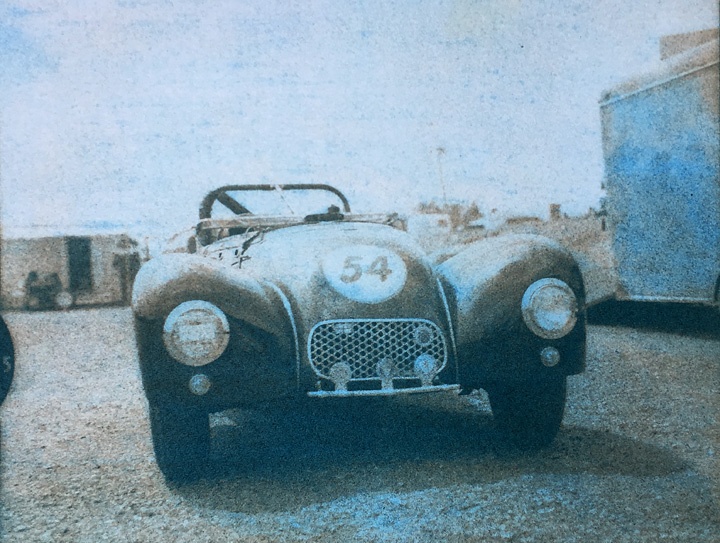

I'm excited to join this thread. A visit to Bob's gallery last month was enough to convince me that I need to try gum printing. I started fooling around a bit this weekend, so far I have made a half dozen prints with one that has made it to acceptable status.
This is from an 8x10 Ilford FP4+ negative that has normal contrast. I'm finding that using a full contrast negative works better than lower contrast ones. Maybe because I'm trying to hit the highlights and shadows with different pigment layers and exposure times it helps to have more separation of tones. The paper is Rising Stonehenge that has been sized with PVA. I'm using a two-hole office punch for registration. 10% ammonium dichromate sensitizer and using Opus brand pigments.
This started with a burnt umber layer, then a payne's gray, then two layers of payne's gray darkened with extra black pigment. For the last two layers I doubled the gum/pigment ratio and halved the exposure time. I didn't scan after the first layer but here are the next three layers. The scans are somewhat close to what the prints look like but I can't get the colors exactly right.
The streaks on the front are from when I accidentally dropped a piece of paper into the tray while the print was developing. Looking at it now I should have done a bit of brushwork on the left headlight and on the fenders to pop those highlights...
Bob Carnie
Bob Carnie
Apr 18, 2004
7,735
toronto
Med. Format RF
Really nice... I have found that mixing pigments are sometimes good for example thaylo blue green shade with a Magenta .. goes against thinking but the contrast of the blue comes out better..
I try to keep all my mixtures the same so that over time if there is problems I am one error away from the problem. Pre shrink the paper and use distilled water as your first bath is what I have found good in my dim room, as well really
shake the pigment first, then the pigment gum dichromate before coating.
Bob Carnie
Bob Carnie
Apr 18, 2004
7,735
toronto
Med. Format RF
Thanks Bob! I have been pre-shrinking paper and doing lots of shaking when I mix. Have only used tap water for the first bath so far, what was the difference you found with distilled?
Not sure but it solved some fisheye problems , Toronto water at different times of the year can be really different.. Also I agitate face down and flip a couple of times to avoid air pockets that leave big circular patterns if you do not catch it in the first wash.

Opus Art Supplies in Vancouver. I can't buy gum arabic anywhere in town so I ordered my gum from them. They sell their own house-brand pigments that are a bit cheaper than the others so I figured I'd try them out. They are a good outfit I order from them from time to time.
I bought my ammonium dichromate through Westlab also in Vancouver. I've also used them in the past for chems and lab supplues. I got 500g of dichromate and it was quite a bit cheaper than Formulary prices, plus of course Formulary won't ship it to Canada anyways.
adelorenzo
Mar 10, 2012
1,420
Whitehorse, Yukon
D'oh!!!! When I was making the last post I noticed that the Opus pigments I bought came in 8 ml tubes and that most other brands come in 15 ml tubes. Which means all my solutions are mixed at half the strength I thought they were! That explains why it seemed like I was not getting deep enough colors.

Anthony, I love the gum print of the truck it looks like you are well on your way!
