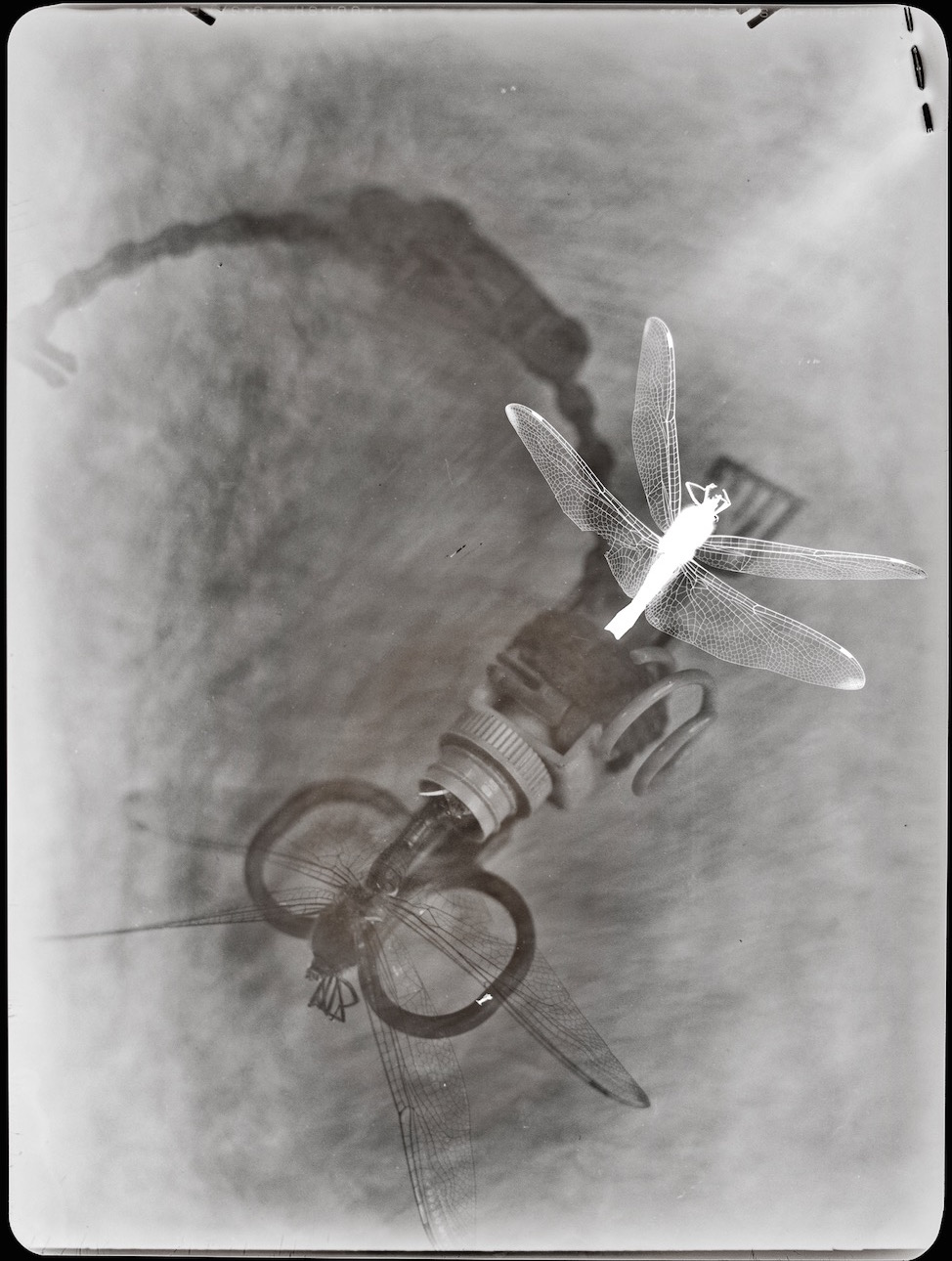

Century Graphic 2x3, Kodak Min-R, Rodinal 1:100 7 minutes.
The film got jammed in the holder and the darkslide handle broke off on this sheet. I changed up my agitation method for my next batch of sheets which I have yet to scan.
I'm curious however as to how this would do in a stand development. There's less of a chance of scratches if I don't agitate.
Is it single-sided film? I've done semi-stand with Ektascan, which is single-sided. The film was stood vertically in tubes. Double-sided was done with hangers. Full on stand was very risky. I had better luck with semi-stand, 10sec agitation every 15 min. in Pyrocat-HD. I found Rodinal useless for stand compared to Pyrocat-HD.
Yep. Single sided.
I figured out that in some of the photos there's a shadow, you can see it on the photo I posted on the left half of photo. Those are the posts that the film is sitting in in the developer. I need to give the tank a better shake next time I think.

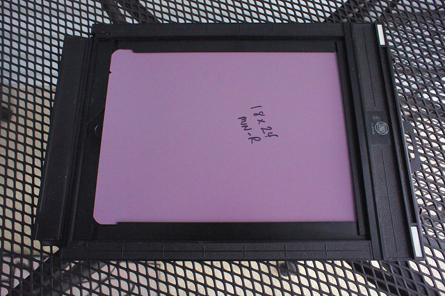

Sinar Norma 18x24 Lisco Holders by Nokton48, on Flickr
Three additional original Sinar Norma era 18x24cm Lisco holders. They came from Germany good deal but no dark slides. Catlabs has replacements at what I thought was a fair price so now cleaning these up to use.
These will hold 18x24 Kodak single sided Mammography film. I have about 500 sheets in stock so set for a while. The 8x10 Norma grounglass is very accurately marked for use with these holders.
Sinar Norma 18x24 Lisco Holders XRAY by Nokton48, on Flickr
As you can see the 18x24cm Mammo XRAY stock fits perfectly in the Norma holder. This will make nice size contact prints. I envision split printing these negs. I got the idea for a contact printing light source that works with the big Multigrade filters. I got the idea from Tim Layton and followed his lead. These negs could benefit from being split-filtered to really nail the tonality.

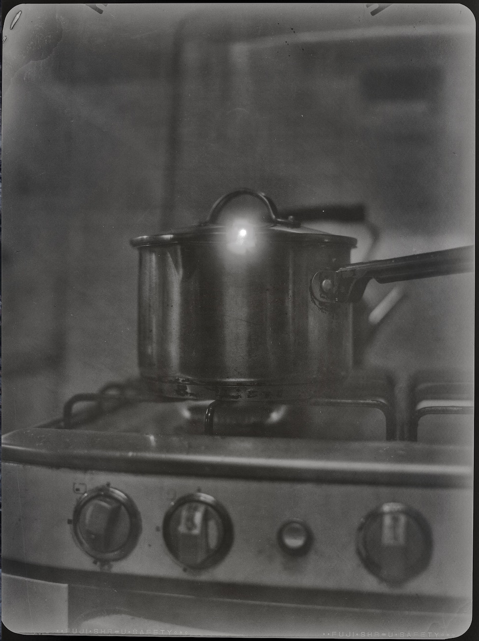

Here's some shots out of my newly CLA'd Crown Graphic.
Kodak Min-R, Rodinal 1:100 7min.
I have a stock of normal film for now, I'll keep shooting Xray for testing or walk around. It got me to where I need to be via loading the holders and handling the sheets for development and general use of large format. I think I'm ready to move to something with some more dynamic range (and less scratching).

More shots from the Crown Graphic.
f/10, 1/100. I just realized that I used HC-110 instead of Rodinal. I was wondering why the image was so soft looking to me.
