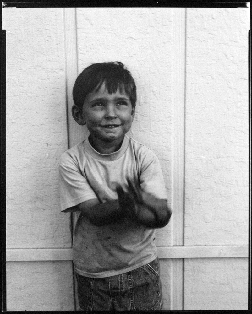

8x10 x-ray film developed at the hospital. Platinum/palladium prints.
The boys were playing in the dirt and I had them come over one at a time.

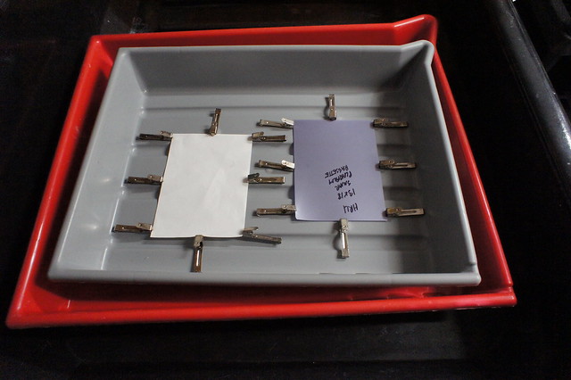

With the Fuji HRU double sided (twice as likely to scratch two sides!) I'm not getting any scratches at all while loading and cutting. Zero. With the Graphmatics I even cycle the back through a couple of times looking for scratches and dust. There are none of either, but in case of dust I carefully blow it off the plate. No scratches at all ever.
As soon as it is wet, it's a different ball game. I have decided I don't want to touch it with anything, I mean anything. So I use the cheap dental clips and smooth bottomed Cesco trays, the dental clips elevate the sheets -slightly- above the bottom of the tray, so it -never- contacts the bottom. If you touch it at all with anything it's game over.
HRU Fixing Step Dental Clips 1 by Nokton48, on Flickr
HRU Wash Step Dental Clips 2 by Nokton48, on Flickr
Paterson made nice plastic print forceps and I bought a bunch of them for moving the XRay film around. Everybody works differently but I'm not changing anything with this process, I am not getting any scratches at all if I am diligent. Scratches are rare but can still happen. This is super delicate uber delicate emulsion when wet. Tanks haven't worked for me it scratches coming in and out

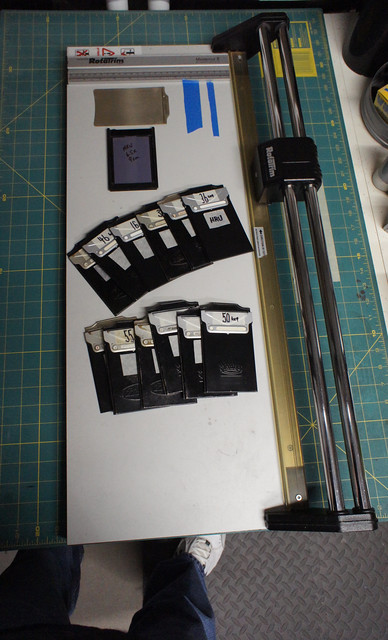

Loading 13 6.5x9 Makina Holders HRU by Nokton48, on Flickr
I have a lot of old sheets of 6.5cmx9cm sheet film in a variety of flavors. I used a sheet of this vintage stuff to set up a "fence" for cutting the Fuji HRU XRAY with my Rototrim cutter. After I cut down a scrap sheet of HRU and test fit it, it is easy to load these dinky Makina holders. I'm doing thirteen to start and that's a good amount to carry around with my Makina II, my favorite Makina. Cool thing is I can shoot handheld, about 1/100 at f6.0 in full sun with yellow Makina filter. Plaubel used to call the Makina "The World's smallest Large Format Camera". I will agree with that :smile:

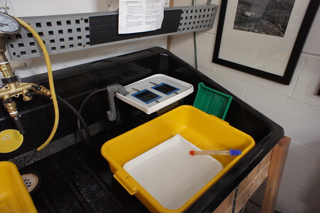

Two 13x18cm HRU in 11x14 Tray by Nokton48, on Flickr
Presently the largest size HRU i have attempted has been 4x5 which I enlarge to 8x10. Now I am getting started with 13x18cm for several reasons. I have a number of original 13x18cm Sinar Norma film holders, and cutting down an 8x10 sheet, I can get one 13x18cm, and three 6.5x9 sheets with just a small amount of scrap left. So I get all that for 32 cents a sheet which to me is a great deal. Presently I have loaded six 13x18cm holders and it is pretty easy to do for me. Never any scratches yet while the film is dry. When it is wet that is another story.
So now I have ordered four 11x14 Cesco trays from B&H cause I am moving up in film size. Extra XRay dental clips are required as you can see. The purpose is twofold; A) Keep the sheet completely off the bottom of the tray where is will smudge or abrade during agitation. B) Keep the sheets from moving around when agitating, bumping into each other which causes major scratching. Touch this stuff when it is wet, and it's game over. With a bit of due diligence and extra care you can produce perfect sheets without any scratching whatsoever. Yes I scratch sheets but that's my fault not the film.
I can fit 16x20 trays in my Delta Sink but there is no room for washing and big is very cumbersome. Large Deep tanks are in my future but not quite yet. Cesco trays are great for small film runs.
I'm using Paterson trays to mock up and to see how the sink fills up. I think I have enough room for this including washing.
