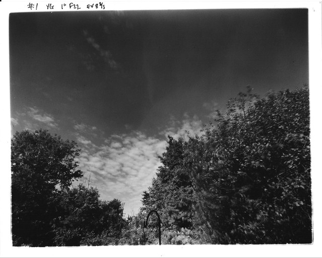

HRU Filter test 1 YG 103mm Norma by Nokton48, on Flickr
Procession of Clouds Filter Test #1
Sinar Norma Handy tripod mounted, 65mm F8 Super Angulon with Schneider 65mm F8 Center Filter. Fuji HRU XRay film 8x10 cut down to 4x5 in Graphmatic back. EV 8 2/3 ZIII Sinar Norma 103mm Yellow Green Glass Disc. F22 2/3 at 1 second EI 50. Tray developed by inspection under red safelight straight Microdol-X 12 minutes at 68F
Arista 8x10 RC print Omega DII Omegalite Diffusion Head Multigrade developer
