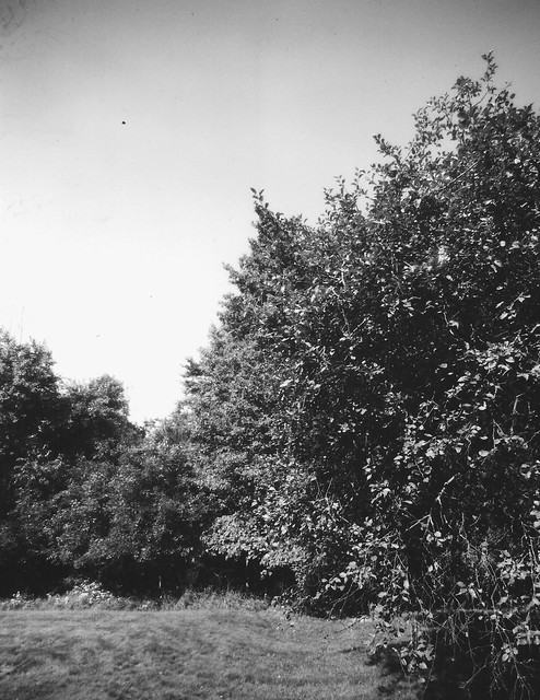

HRU test Norma Handy Sinarsix MicX by Nokton48, on Flickr
Nothing artistic but a superwide view off of my back deck, on a VERY windy clear sun key day.
Fuji 4x5 HRU XRay test key day Sinar 4x5 Norma Handy 65mm F8 chrome Schneider Super Angulon lens, with Schneider 65mm F8 Center Filter. Norma Sinarsix TTL meter F11 reads green grass EV 7 2/3 equates to 1/15 at F11. Very windy day lots of tree movement. Camera mounted on a Star D tripod to allow slower shutter speeds. Microdol-X straight replenished 12 mins at ambient. Development by inspection red safelight Omega DII Omegalite diffusion head Arista #2 RC paper mulitgrade dev Scratches! Used Paterson trays, should have used smooth Cesco trays. This is a wide scale subject, Microdol-X has done a pretty good job once again :smile:

What EI did you use? Just going by the print, it looks like the film could have used a lower EI, to bump up the shadows... Happy to see that Microdol-X works seemingly well!

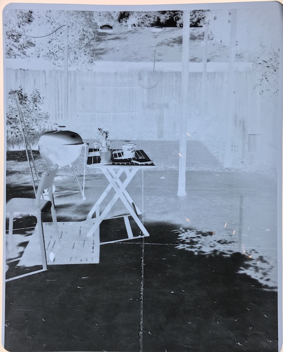

EI of 400? I always thought for continuous tones, it was closer to EI 80-100 (unfiltered)? Especially in POTA. I've shot Ektascan B/RA, as well as CXS Green Latitude, at EI 40 in POTA. I'd be curious to see your results! :smile:
Here it is! It's 6 min at 68° with constant agitation. I based the ASA 400 test placing shadows in Zone III. It looks like it has good shadow detail. I really like POTA. It's a a pretty simple recipe and easy to mix. I shot it at 1/15’ f 32 1/2. I processed the film Friday and I didn't get a chance to get densitometer readings yet.

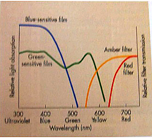

I remember looking at the spectral sensitivity for CXS Green Latitude, and I'm pretty sure the curve dropped at around 575 nm, about where the amber filter starts to become sensitive. I use an amber filter, and I have never had any fogging issues... loading/unloading, as well as during development. My light is a proper darkroom light, with the two baffles on top. It sits on the ceiling, about two metres from the development tray.
