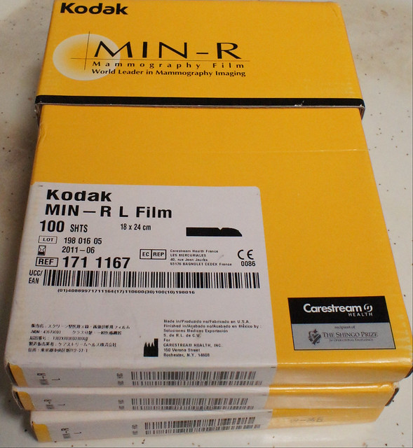

Kodak Min-R Single Sided Mammography 18x24cm by Nokton48, on Flickr
This is single sided 18x24cm Mammography XRay I found a while back. I do have one Sinar Norma 18x24 film holder, so this will make nice sized contact prints.
The big bonus is that I can cut it into four 9x12cm to fit my European holders and cameras.
25 cents a sheet for single sided 18x24. Looks like these came from France.

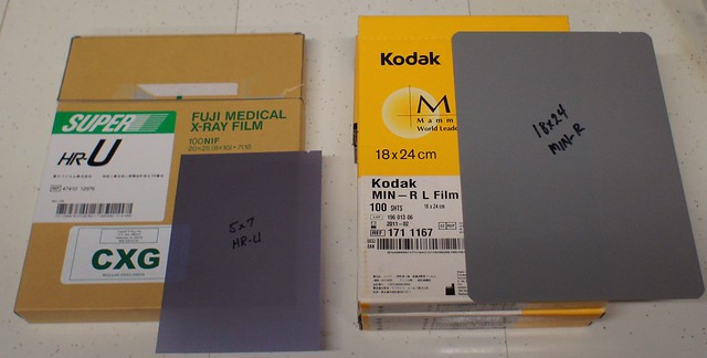

Loading Up The Truck Fuji XRay by Nokton48, on Flickr
OK HR-U is going to work for me in the larger formats. So I am loading up the truck as I have no idea how long it is going to be available. Not bad at $28 a box.
400 8x10 sheets of HR-U plus the hundred I already have. Hopefully a lifetime supply. While I was at it I grabbed a hundred sheets of RX-N, which is the blue two sided high speed Fuji XRay film.
