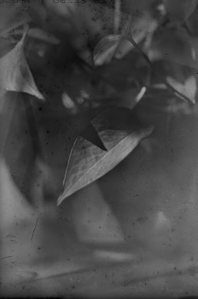

The film sheaths in my Zeiss Ikon Ideal plate holders are nice and smooth, and quite black; I might have to get a box of the 18x24 x-ray film just to have cheap stock for those cameras...
So actually I know this test is plenty of deffects but even so I do like it.
Shooting with my Zeiss Ikon Maximar 207/7 and MXG Carestream, box of the18 x24 , cutted in 4 parts ( 0,7 cents for shoot, not bad at all)
F5,6- 1/50
Dev. HC-110 (Dil H). Developed by inspection
