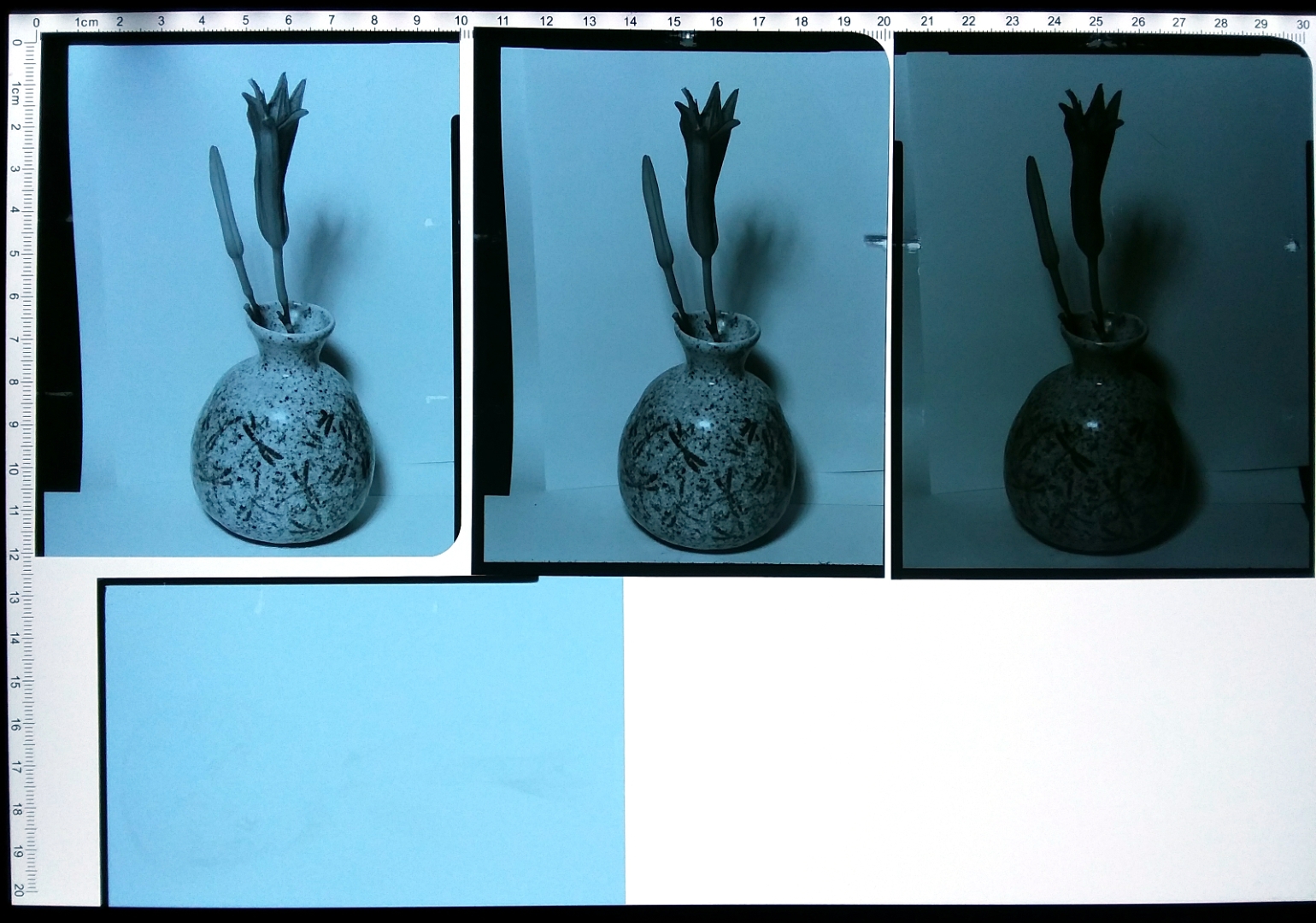

Fuji HR-U (Expired 2020-9-30) @ ISO 100, 1/60s, f64 under a single strobe with 0, -1, and -2 stops of flash compensation, respectively.
Parodinal 1+100 @ 28C 12', water stop, R9 bleach, re-exposure, re-develop in 1st dev.
Plus a blown frame to give an idea of the dmin/dmax.
These were hastily shot & developed in a tank with no particular care taken to to harden the emulsion, so there are some processing marks but the emulsion is still intact.

Really cool results, Bronson !
The blue base makes it quite unique, but as a positive it looks fantastic.
Would you recommend adding a hardener (like potassium alum) to the final water wash, or maybe in the stop bath ?
Bronson Dugnutt
Dec 29, 2018
982
USA
Traditional
The tank marks are from the development step so you'd need a hardening pre-bath and/or a pyro developer. Or, better yet, get good at processing in a flat-bottom tray.

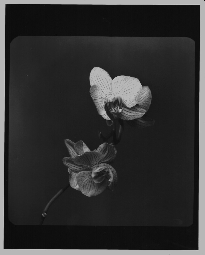

18x24cm Mammo Norma 121mm F45 18 pops C171 Beauty Light Grid by Nokton48, on Flickr
  • Testing Kodak Mammography 18x24cm in HC-110 "H" 6.5 mins at ambient. 8x10 Sinar Norma 121mm F8 Sinar Norma Schneider Super Angulon on Norma Vertical Copy Arrangement. Shooting straight down at F45. Broncolor C171 Monolight with Broncolor Blue Pulso Beauty Dish, popped eighteen times with shutter on "B" to build up the density. Contact printed Omega DII with Omega;ite Arista RC #2 Matte paper Multigrade developer. Digital background shot by Tim Layton and was blown up by me at Costco. It was dark red so I guess I should have expected a lack of density on the right. Live and learn. Highlight tonality looks decent to me. 18x24 XRay film is easy and fun to shoot

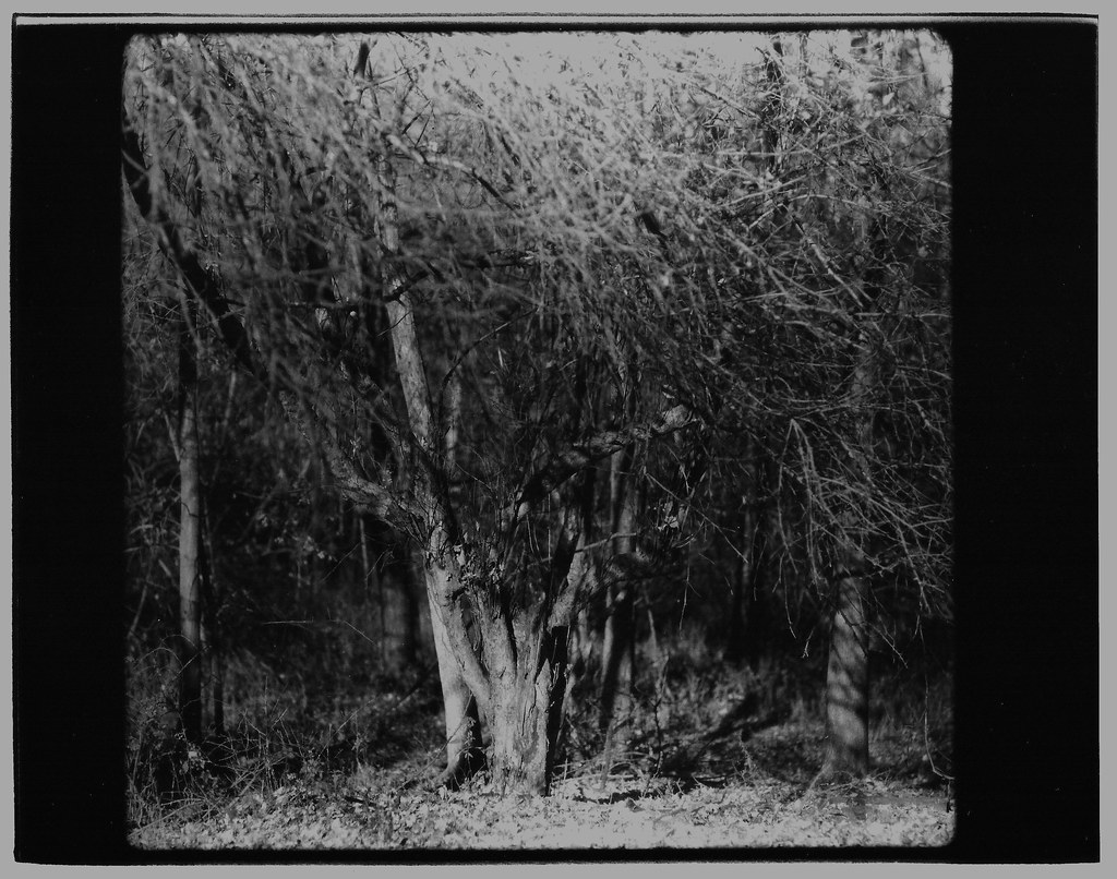

Abandoned Orchard Apple Tree HRU Maki 210 Heliar by Nokton48, on Flickr
In my neighborhood there are remnants of the apple orchard that stretched for a good distance many decades ago. At the back of my property is one of the original trees, now gone wild. Plaubel Makiflex Standard, 210mm Makiflex Auto Iris Heliar, Fuji XRAY HRU 4x5" cut from 8x10. Grafmatic Film Back, Sinar 103mm Glass Disc Yellow Green. 1/15 at F5.6 Legacy Mic-X 18 minutes at 60C. Aristo #2 8x10 Omega DII Omegalite Diffusion Head Multigrade dev

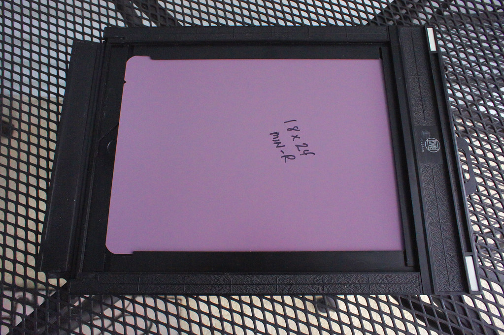

Sinar Norma 18x24 Lisco Holders XRAY by Nokton48, on Flickr
He also how it has a notch indicating film side. All of mine has been manufactured in France. Good stuff IMO! Like it
