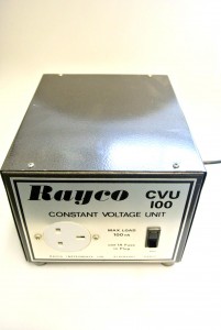

Hi, does anyone know anything about this? Seen one for sale but not sure if it's a stabilizer and theres not much info online.
Thanks

Thank you for the help peoplemerge but I think I read somewhere that the company went under some years ago. Who knows though. Thank you anyway

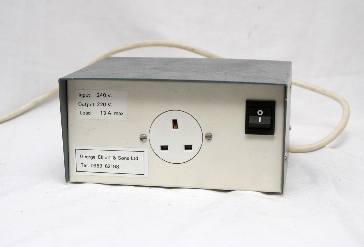

Also came across this one if anyone knows anything about it? These things look pretty ancient by todays standards haha. Might try call them tomorrow but that number looks too short and I'm not going to get my hopes up.

Is this not "Rayco Electronics" ? I found their website saying they are a pioneer and innovator of magnetics products since 1941. Well, they didn't reply to my email, but they are answering the phone. You might try them at 1.310.329.2660.
What you can also do is simply plug in a voltmeter like the one you took a picture of. If you already have a voltmeter, make sure it's on "V~" for AC or you'll kill it. If it changes over time, you don't have a voltage regulator. Though if I had to guess, either would work well. 6A is more than you need to pull if my enlarger power math works out.

Oh thanks for the help peoplemerge I'll give the number a try. Good idea about plugging in the voltmeter into it too. The voltmeter should be here tomorrow so I'll see what my voltage is like first before I order one of these potential stabilizers.
How does the amp rating work? One of them is. 6A and the other is 13A max but I think UK mains sockets work at 13A. Would the 6A one be alright running off that or is that too high for it? I never paid much attention in physics lessons unfortunately

Amperage in this context just describes the maximum current you can pull off the power supply. If you look on your circuit breaker box, the breaker for your plug is a 20A, at least that's household in the USA which is 110. Intuitively, 6A is really a lot of current (it's 30% of what a 10A breaker can sustain). Most timers are rated about 500W but let's see, you mentioned you have a Durst M370... googling http://www.davidutrilla.com/cajon/durst_M_370.pdf (this is a good read for you btw). Let's assume your enlarger is equipped with the 100W halogen bulb... how many 100W lights can you turn on in one room without tripping your breaker? 20? Googling https://www.thespruce.com/calculate-safe-electrical-load-capacities-1152361 "20-amp 240-volt circuit: 20 amps x 240 volts = 4,800 watts" yes that's the power formula. So 6A x 240 volts = 1440 watts. So it will work but is 3-10x overkill for your needs.

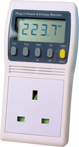

Just learned that a 5V change can lead to a 14% change in light intensity. This might help someone in the future. Im exposing at 11s and a 14% change is 12.5s and this is a noticeable difference in density for me. I'm regularly getting shifts of around 5V everyday and I feel like my line is fairly stable.
Just something to consider for anyone having difficulty with consistency. I bought one of those 'kill-a-watt' devices for £10 and it helps monitoring when and when not to print. It's still early days but I'm going to aim for a 1.5 voltage difference when printing to get best consistency and that seems fairly possible.
Hope this helps someone because it can be frustrating and not all enlargers have stabilization built in

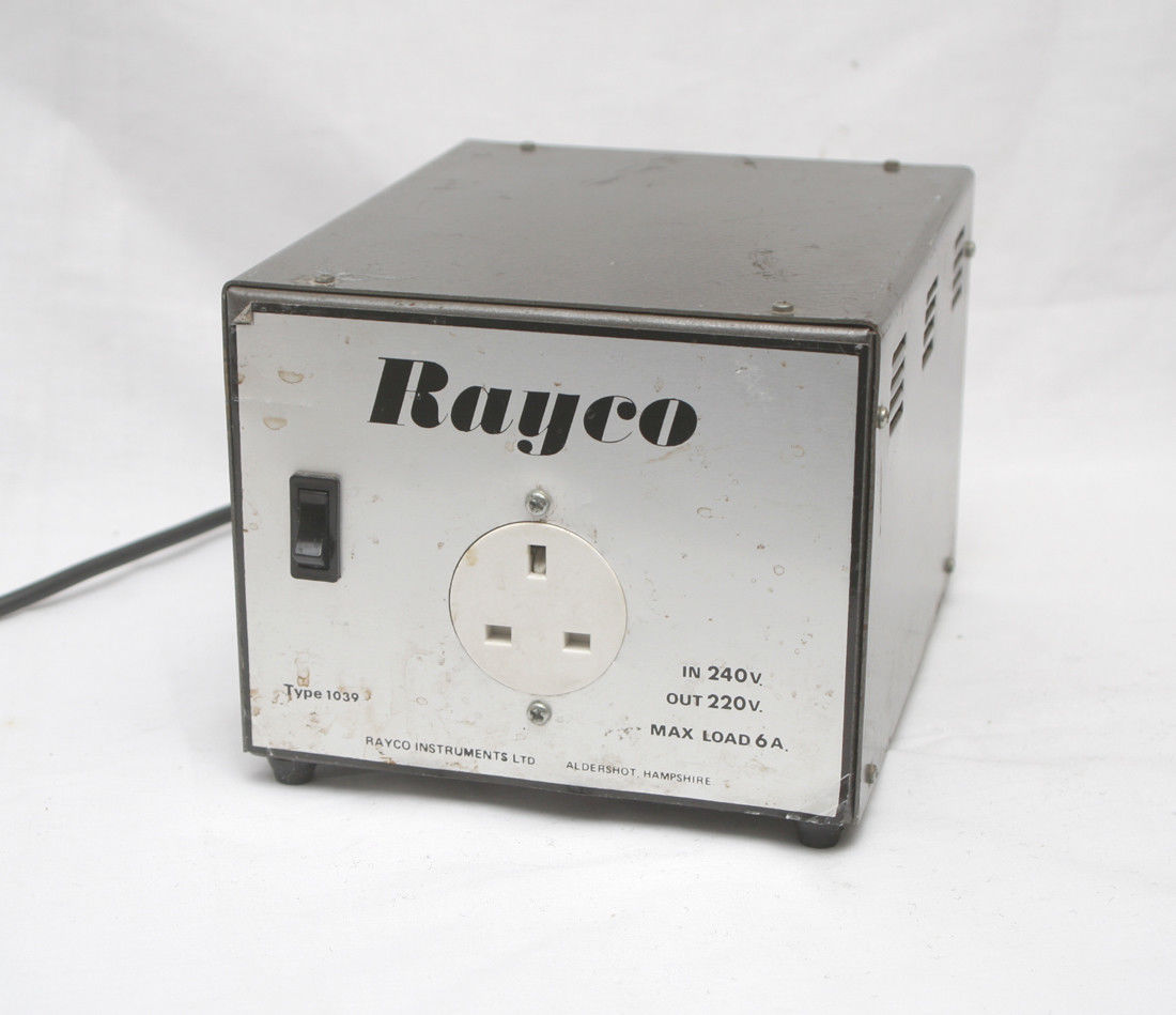

Okay the stabilizer I ended up buying was the one above. It's specs are input: 240v, output 220v, max load 6a.
My enlarger transformer requires 240v and 120va so 0.5a. It then outputs 12v at 100va.
Is the stabilizer a bit too much for my transformer or should it work? Will the circuit only draw the 0.5a the transformer requires or the 6a that's the max load?
I'm so confused. I just wanted to print some photos
One more thing I just realised. The max load of the stabilizer above was 100va and the enlarger transformer outputs 12v at 100va so I'm assuming this would also work too but only just.

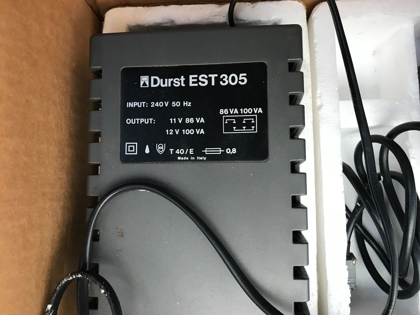

Right guys, I've come across a Durst EST305 for sale which should work for me but I need to rewire the fitting in it. Does anyone have any experience with it? I've read they're quite prone to failure and what sort of stability should I expect from it?
Thanks

Also is this a stabilizer or just a transformer? It's the Rayco one from above. The out 220v one
