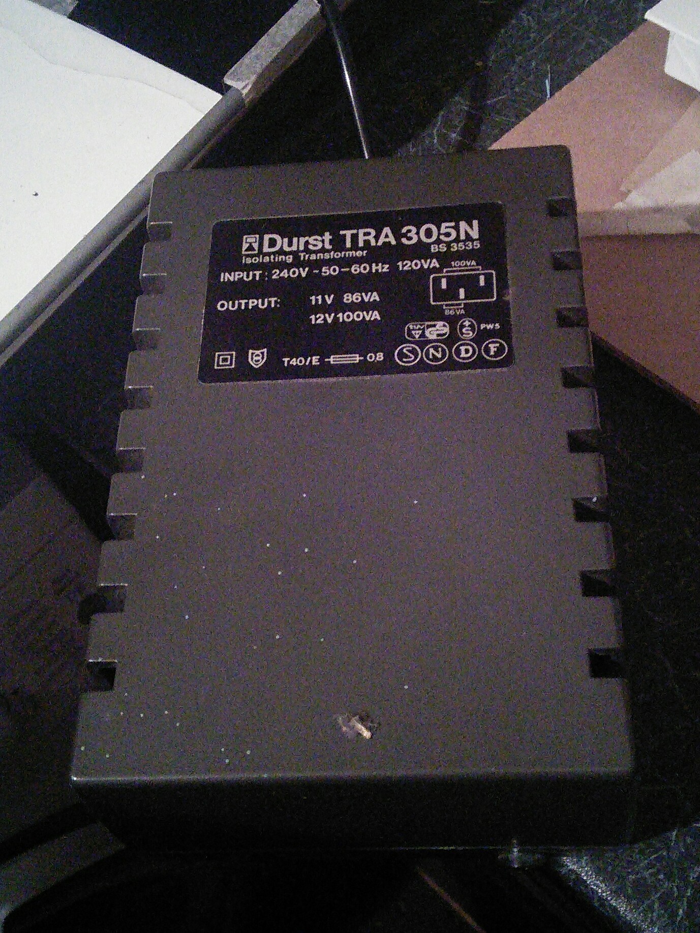

My enlarger is a Durst M370 colour enlarger and it has a box inside that diffuses the light. Not sure if it's dichroic though. It's connected to a Durst TRA transformer then into an electro magnetic timer (Durst TIM 60). I had a conversation with someone about using a voltage stabilizer also but I think that'll be a last resort for me. A google search said that the voltage in the UK is 230v +6% or -10%.
It takes a 12v bulb so I guess the transformer steps it down to that.

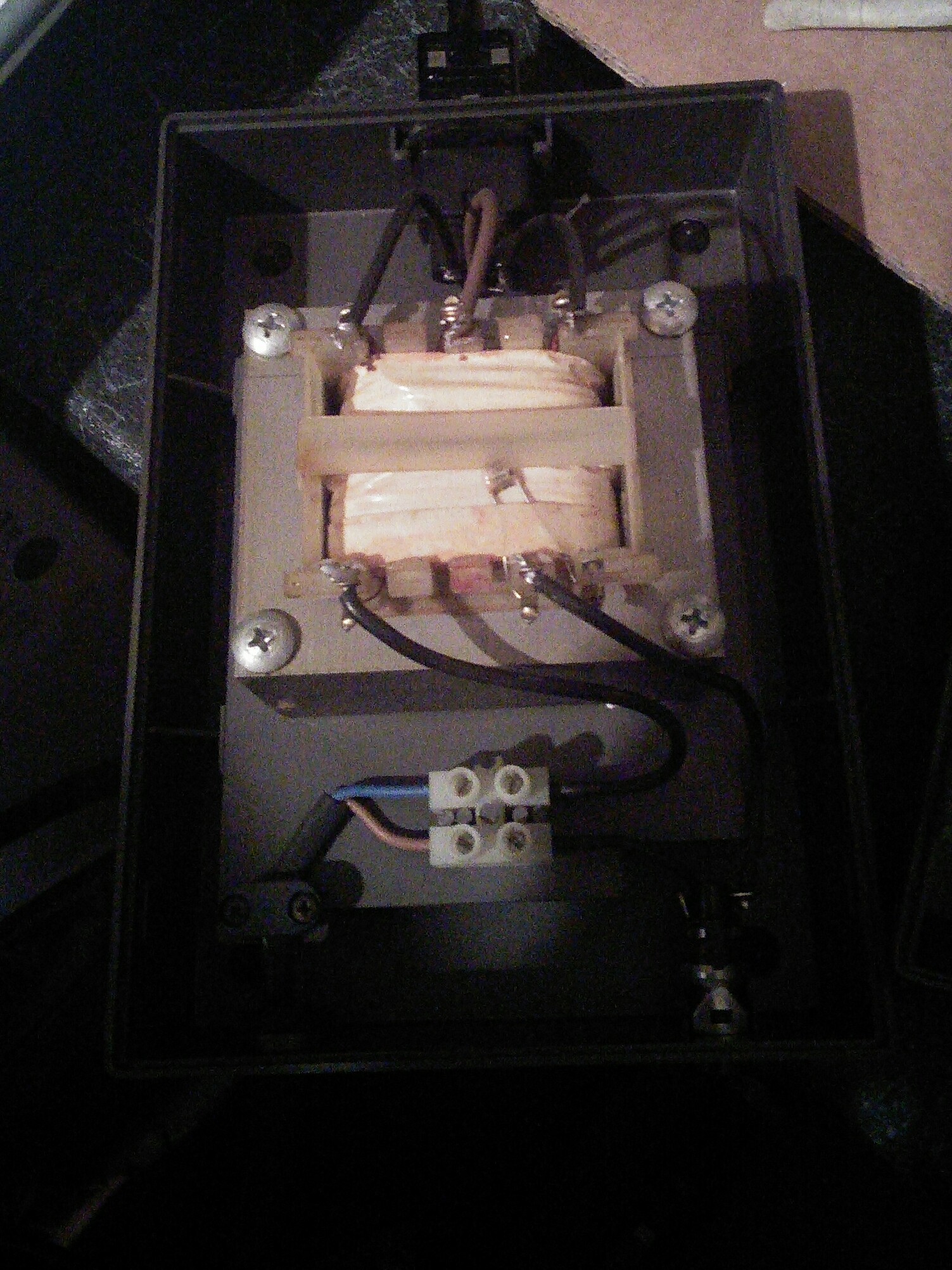

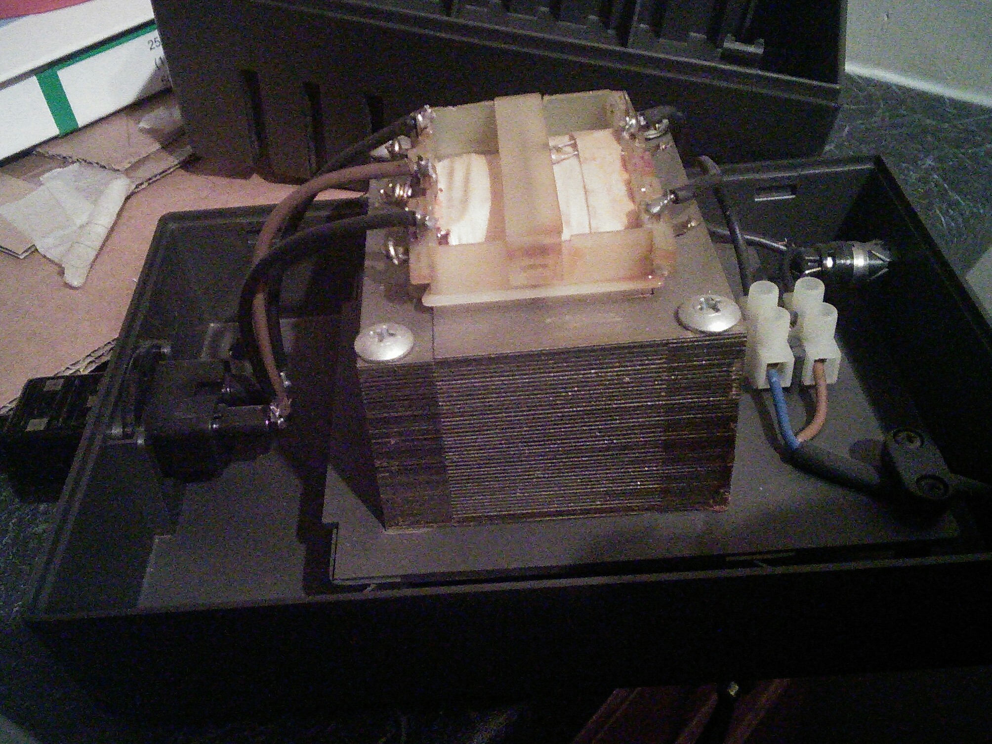

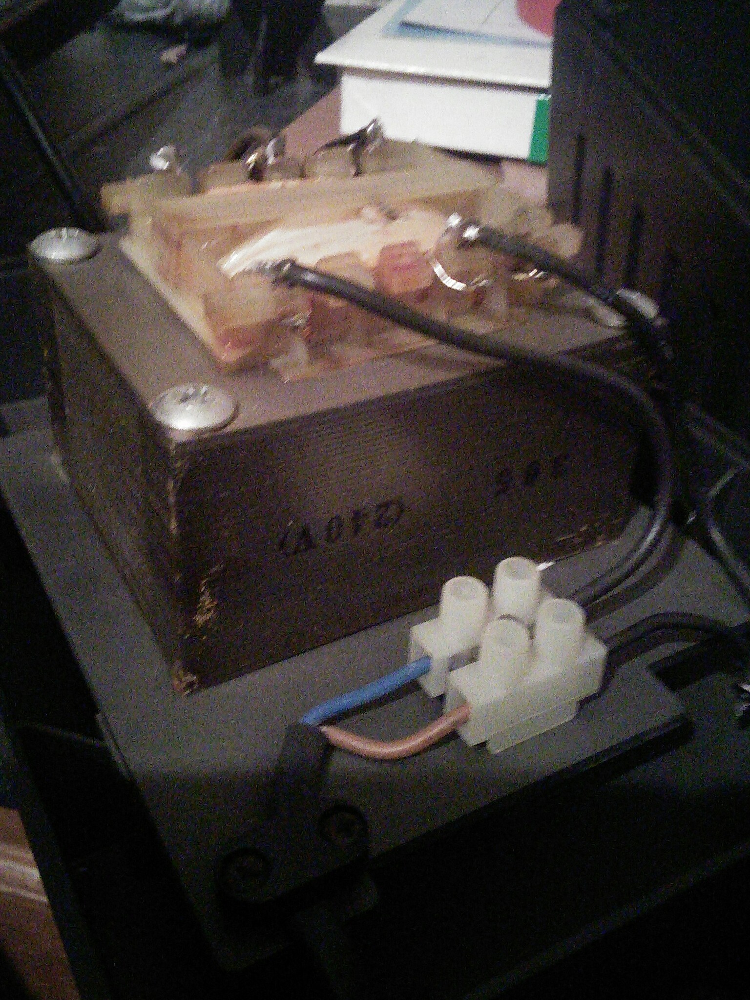

Just out of curiousity, would the transformer on the Durst also stabilise the voltage?
koraks
Nov 29, 2018
24,583
Europe
I never opened it up, but it didn't look like there was much in the box besides a transformer. If you really want to know, see if you can open it and snap and few pics of the inside; that'll most likely clarify it.
Bumba
Mar 10, 2018
122
Wolverhampton
Not too problematic because 2 of the latches are broke on it so I've only got the top taped down.
