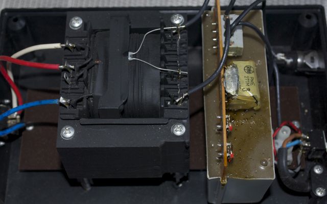

Hey Koraks. I think you're thinking of the TRA transformer for Durst enlargers. The one I've found is the EST which is actually a stabilized version of this transformer. They look identical but are different inside
Yeah you're right, I had a TRA.
In the photo I see not signs of any stabilizing circuitry. You could ask the seller to snap some more pics of the inside to be sure. But it's possible someone stripped the part out that you're actually looking for.
Unfortunately it's one I've already purchased thinking it was a stabilizer. There wasn't much information about it as it's an older bit of equipment. I found a photo of the internals of the EST stabilized transformer. I suppose the tower on the right is the stabilizing part of it. From what I've read the yellow capacitor on the right is prone to blowing so not sure if I'm prepared to take on the risk of having to replace it in such event. Could be an easy job though.

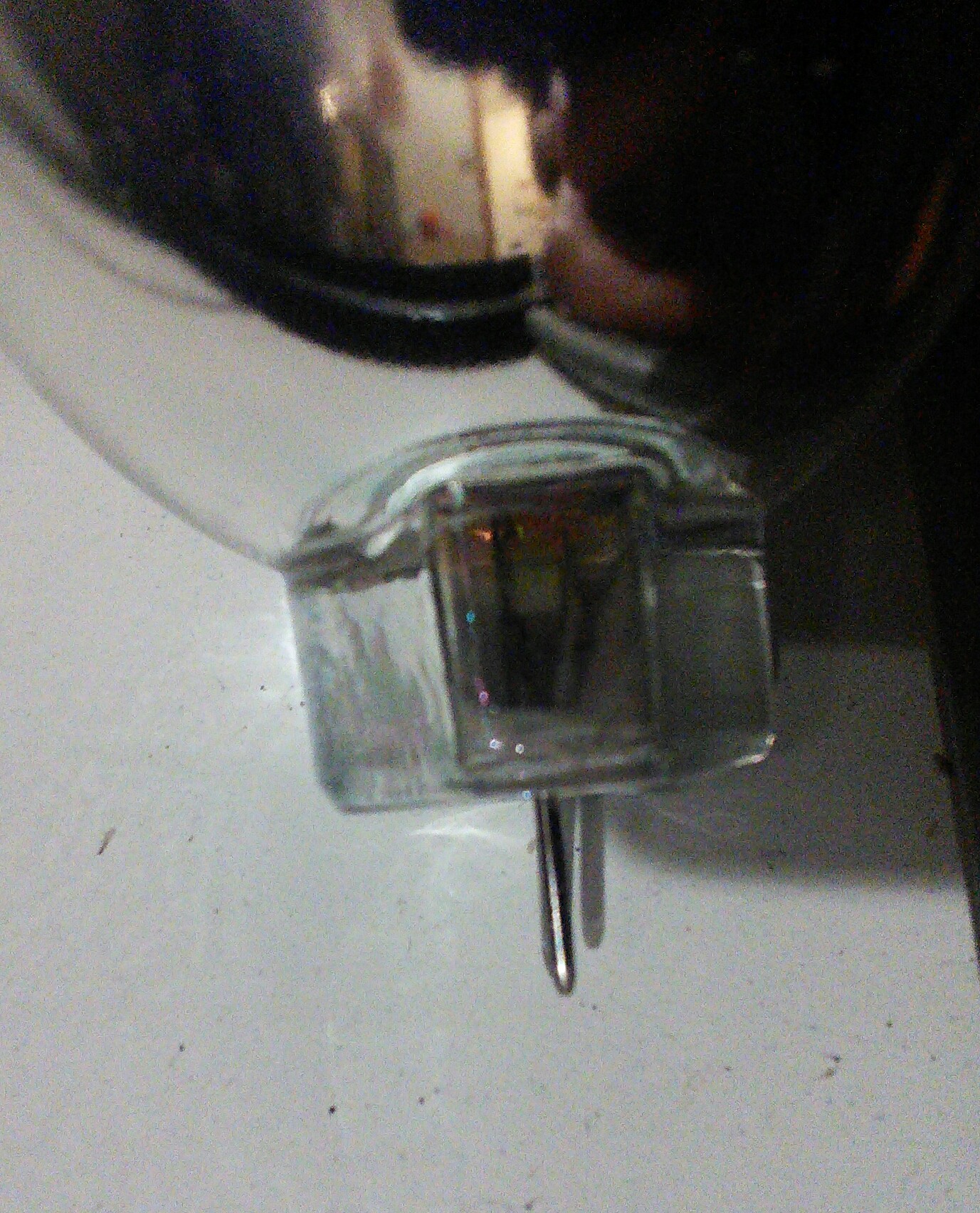

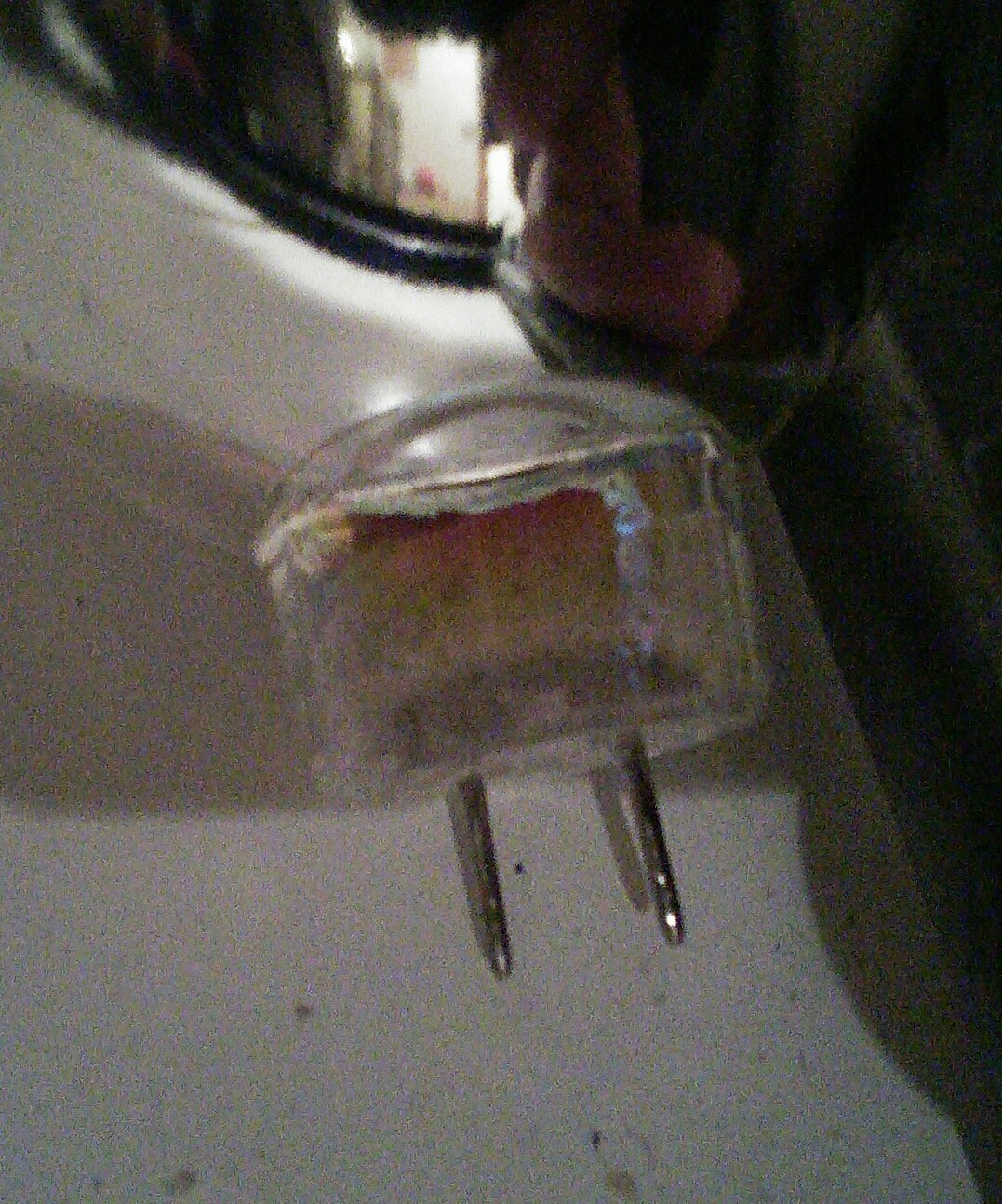

Update - I noticed that the display on the device that gives a voltage display fades over time. I just thought it was because it was cheap but I found out that it only fades when the enlarger is turned on.
I think that's the cause somehow so I'll try putting it on a different circuit and see if that helps
I'm back and have had limited success. Anyway, I changed my bulb holder and that made a massive difference and helped with a bunch of problems I was experiencing. My new bulb was used in my old holder and the ceramic has browned off and the ceramic is also very thin and missing on one edge and the terminals have gone black inside. Im not sure if this is giving me problems too. Is this blackening normal on bulbs. It's fairly new.
I've also flipped my bulb round and the colour went really green which doesn't seem good.
