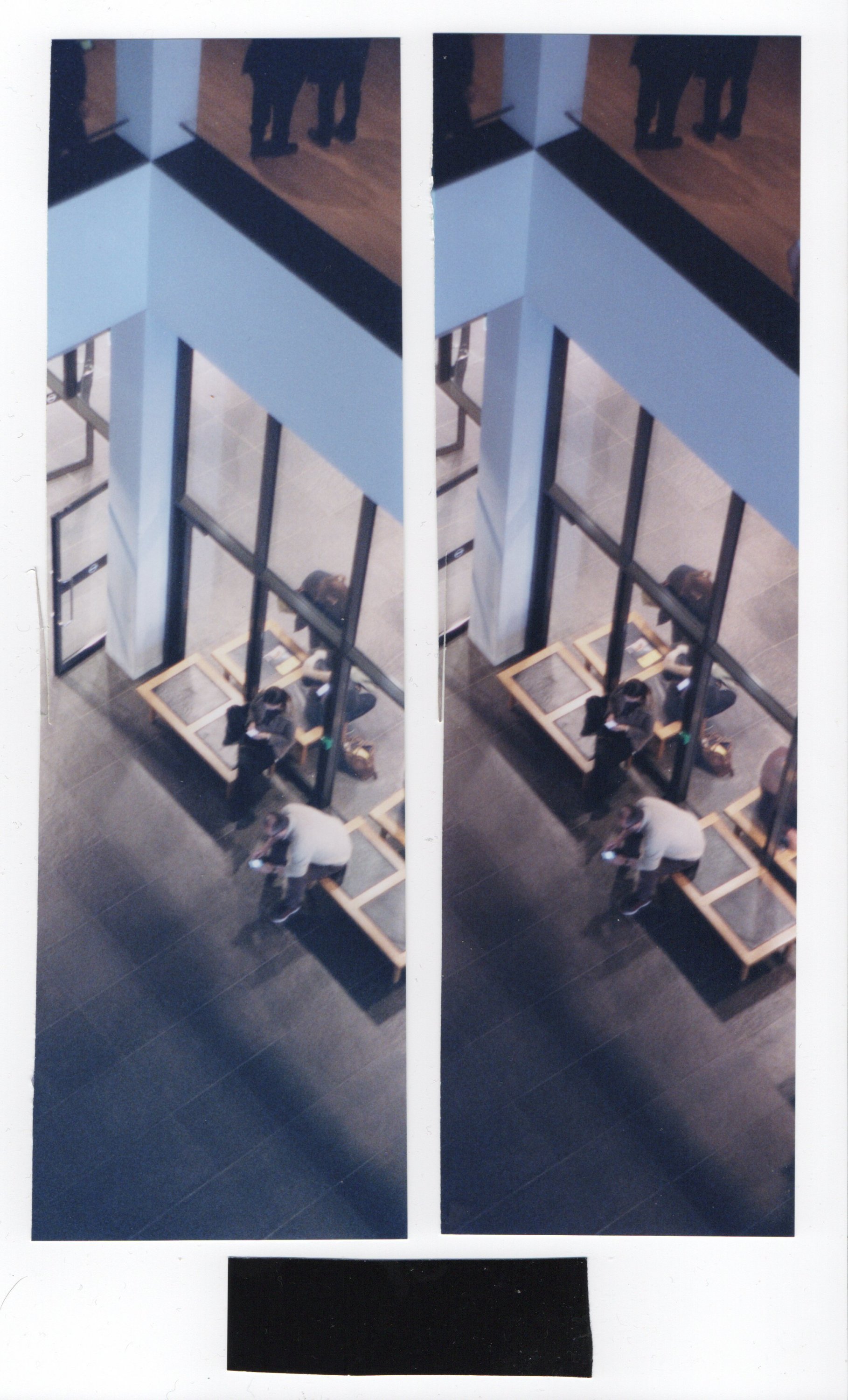

Ok people this is what I've come back with from today and thanks for the past advice.
Both tests made with the same chemicals, filtration, time, f stop etc. They're identical apart from the processing. The one on the left was processed at 2 mins @ just under 20°c. The one on the right was processed at 45s @ 35°c (went in 35°c, came out at 31°c). The strip at the bottom was exposed to room light then developed at 20°c @ 2 mins and it took 20-25s to turn full black.
It doesn't show the difference between the two so well on the scan but it's more pronounced in real life. The density of the room temp one is lacking and the image lacks the punch and vibrance of the 35°c.
What do you guys think? Should I process longer at room temp or do a longer exposure of the test strip.

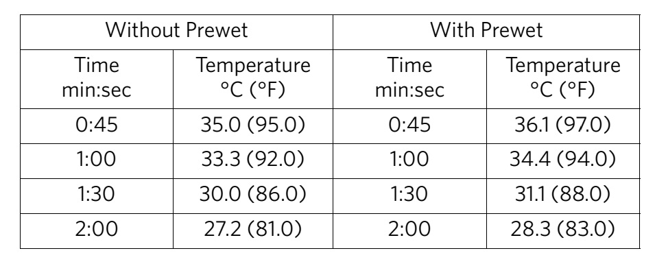

Just looked at the Kodak datasheet. I might try a 3 min dev time at 20°c with intermittent agitation and see if that gives me better density

You can't "over develop" RA4, but you can under develop. I would use warmer chemistry. It's faster. I run everything at 100°F. Pre wet won't hurt anything. What I did with the Ilfochrome (Cibachrome) was semi one shot. I would use 120 mL for an 11 X14 tube, I would save the used developer, and for the next print I would use 60mL of fresh developer and 60mL of the used from the previous run. Worked great. I think this would work with any tube processor.
I used a 12 liter plastic bin with a aquarium heater, I would float the 1 liter bottles of chemistry in the bath to keep warm. (Start with really hot water 45°C, this will warm your bottles fast) your times will drop dramatically even at 85F.
The old P122 process was 12 minutes 1st developer @75F, 6 minutes @85F.
There are tray warmers if you want to use a tray. Still if you are not in a hurry 20°C will work fine.

@Bumba the left strip is indeed underdeveloped. I'm surprised at this as I get full development in 1m30s with fuji developer at less than 20C.

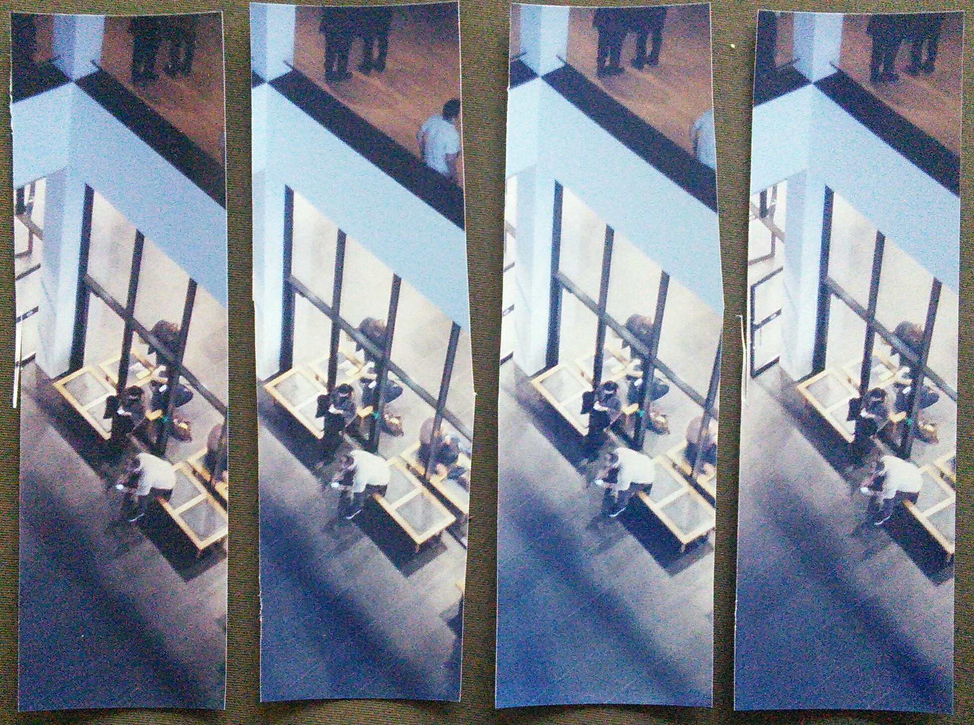

Little update from today. Made two new identical test strips. One I processed for 3 mins at room temp and the other I used 60ml (usually use 40ml) for 2 mins at room temp. Neither of these had very good density and I can't get close to the heated chemical density.
I am using drums so maybe this kit is better for trays. I may have to work out an easy system of heating up chemicals without a jobo.
1) Chemicals at 35°c
2) 60ml/20°c/2 mins
3) 20°c/3 mins
4) 20°c/2 mins

Yeah, that doesn't look too good. I can't comment on a Jobo situation, but 60ml sounds like a rather small amount for a print drum. Then again, it works for you at 35C. Do you currently replenish the developer? So that the 60ml volume you use is in fact a small bit taken from a larger vessel containing the replenished developer and you return the 60ml to the rest after developing a strip/print?
In my room temperature setup I use 500-600ml in a tray. The tray holds up to 24x30cm prints but a larger and flatter tray would easily develop larger prints with the same chemistry volume. I find working with small/minimal amounts of chemistry to be tricky as there's very little capacity to protect against any variations such as oxidation etc. I'd rather have a bit more volume to buffer with. But I'm kind of addicted to trays, I have to confess. Didn't like the hassle print drums brought along, but that's rather personal.
For keeping your developer up to temperature you could consider one of them nifty sous-vide cooker thingies. I hear good things about them.

Yeah I'm a bit stumped because these were all made with fresh chemistry. Only put 3/4 of a sheet through. I'm going to take a few days to do some research on chemical heating ideas. It wouldn't be such a problem but I process in the bathroom and there are no plugs in there.
I've tried 35°c before but the short times made it too difficult by hand. I may have to find a temp that has longer times and less drift than higher temps.
