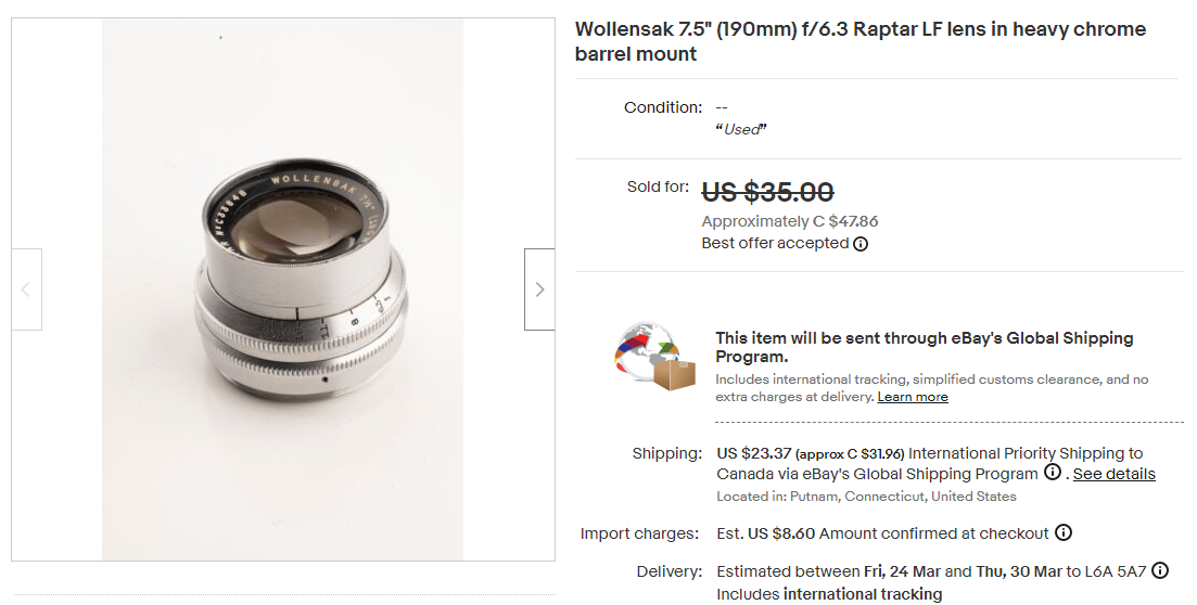

I have these two guys in transit:
View attachment 332646 View attachment 332647
and a 4-element
Not sure you'll get to use the 190 and 210 without an added 2-3 inches on your cone.

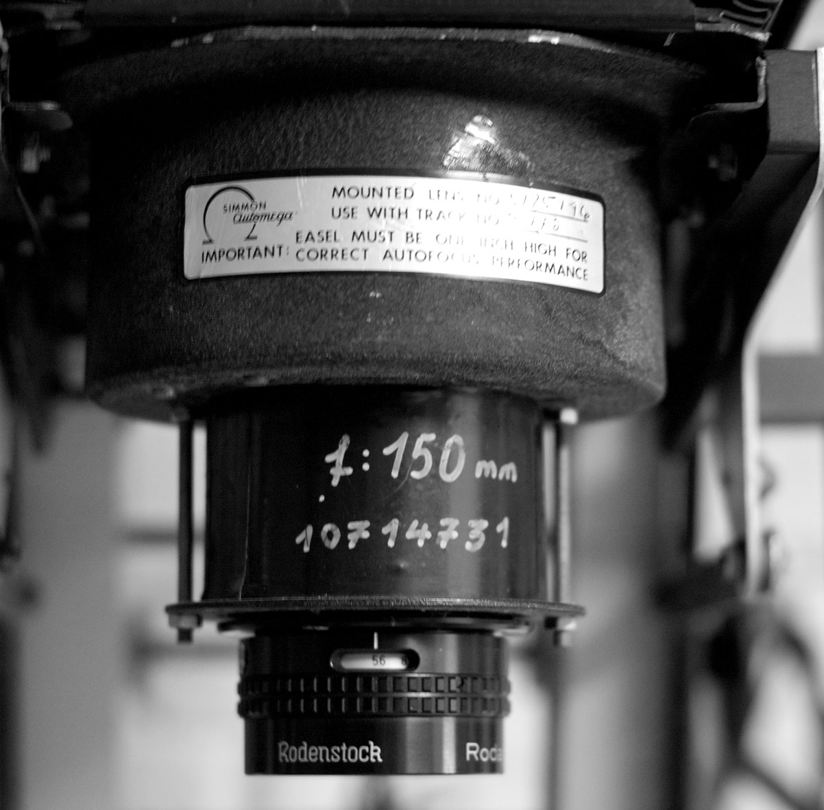

See what I had to do to fit the 150mm, this was a cone for a 105mm...
Yes, did you manage to keep the lens alignment this way? It's a homebuilt modification, with carbon fiber or what is it? I now have a couple of lens cones, one of them is quite long, so hopefully I won't need this for my 190/210mm.
I now have one of these long cones you showed earlier, lets see if it works. I think my lens arrived at home today, just got a notification.

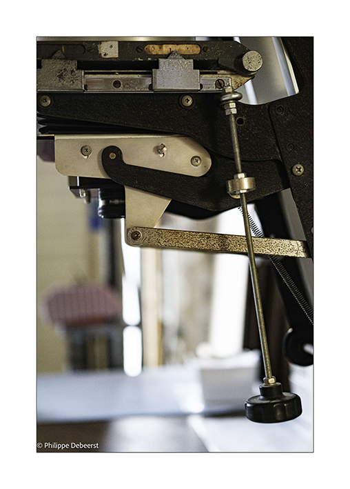

also can you share some details of that focusing know mod? I have to put my face near the easel on the grain finder while holding up my arm if the weirdest manner. It makes for a good stretching exercise but not for fine darkroom work.

As you can see, for the 150mm, I used a threaded rod to mount the lens flange on the cone, by this I could carefully trim the distance by less than a mm.
Then I cut a pice of PVC evacuation tube, trimmed it with sand paper, blackened, and put is in between the flange and the cone...

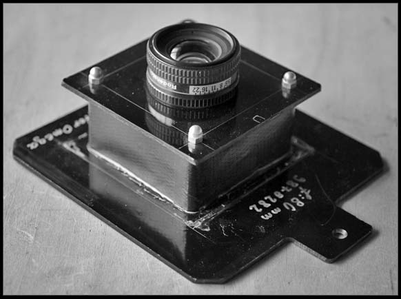

The other one, for the 80mm, is made of black Acrylic glass, because it was what I had at hand and is so easy to be worked on, and is sturdy enough!
The lens flange is mounted with threaded rods too, to keep it simple...

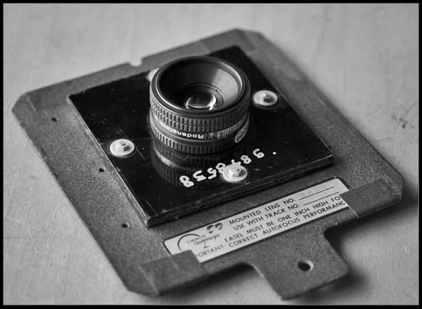

I had to put something in between the 50mm lens and the plate as that lens stack out too far and so I couldn't slide it in the lens holder. Again I used Acrylic glass, a threaded rod and some washers to trim...
Be aware: a caliper comes in very handy, actually, it's paramount!

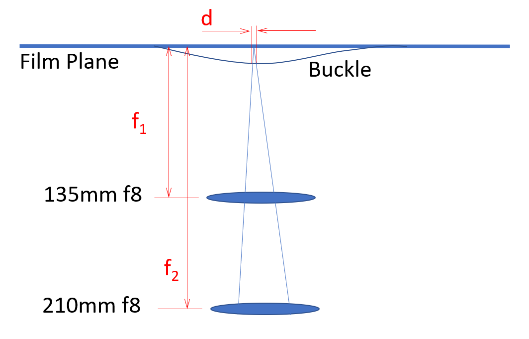

35mm was never mentioned, this seems to have become just a theoretical discussion for the sake of it. And please explain why a 135mm lens would be more sensitive to the effects of film buckling than a much longer 210mm? Are you sure you will be able to make an 8x10 enlargement using a 210mm lens that the enlarger was never designed to be equipped with?
Regarding the film buckling, I came up with this little diagram just now. For 135mm lens (f/8 lets say) the ratio d/f1 is larger than d/f2 for 210mm lens with same f-number. This is just a schematic. I am thinking that for the shorter focal length the effect of film shifting out of the focal plane has a greater relative blurring effect than for longer focal length lenses when all are enlarged to 8x10 paper. Also I didn't take into account that 210mm lens has to be positioned a lot farther from the negative than 135mm lens, possibly making this effect stronger. This is just a theory, needs to be tested still.

Film buckling is just as significant with any focal length. If you set up the enlarger with any lens and focus a negative, you will find the slightest adjustment to the focus makes the grain blurry. Stopping down the lens can will deepen the field of focus a little.
Glass negative carriers are the way to deal with potential film buckling.
