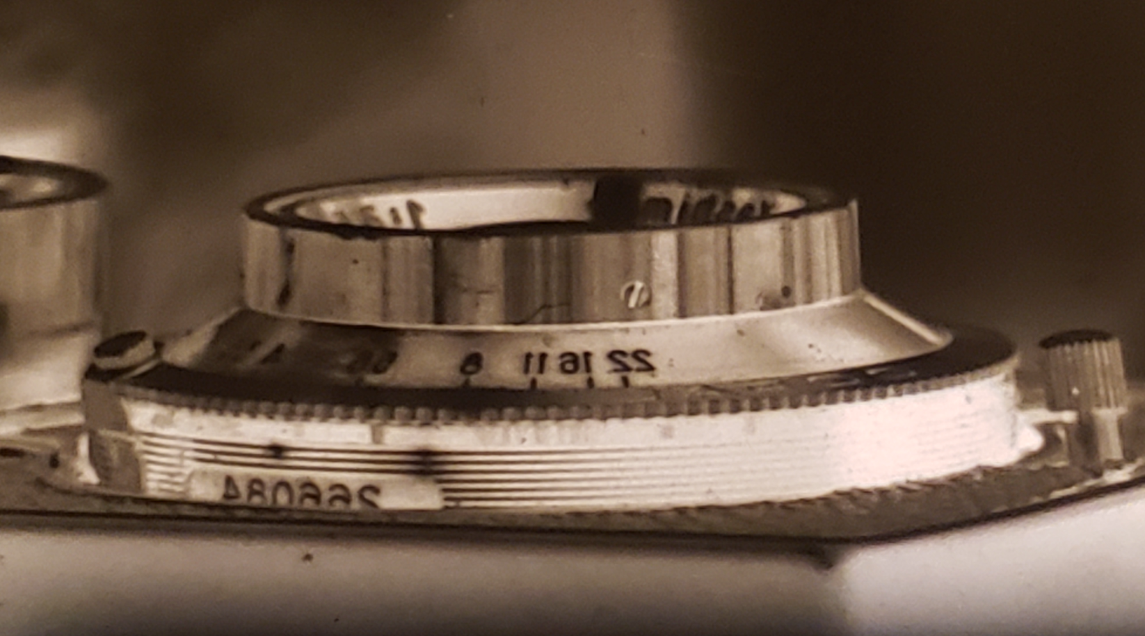

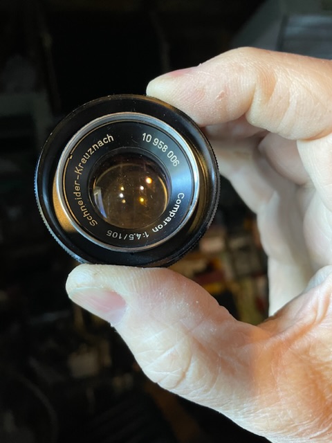

I went to the Kaufmann’s Camera and picked up this 105mm and this is the lens I use for medium format now.
I don’t know… do reflections hint at how many elements a lens has? Or is it inconclusive because some are in groups.
(Looked it up this is a 4 element lens 3 groups.)

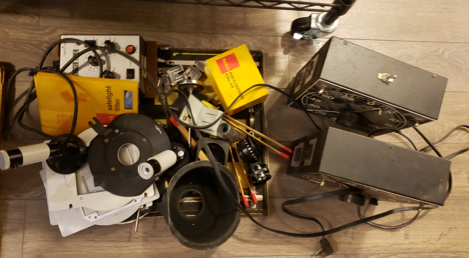

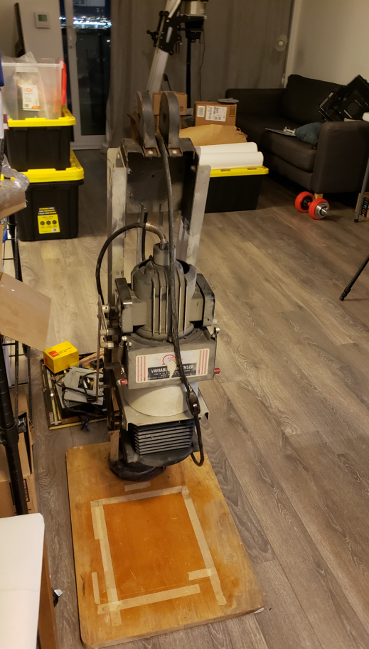

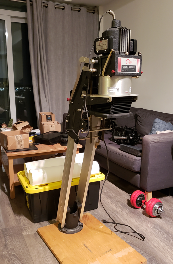

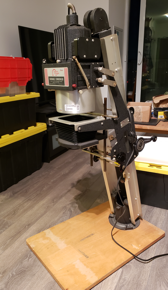

speaking of lenses again, I picked up a bundle of darkroom stuff for about $150 USD yesterday. Including 4x5 negative carrier, 2 lenses, a cone, 3 timers, 11x14 easel, etc.
thought it was a good deal, as it also included an omega D2 enlarger, though not in a good shape, so now I have 2 of them.

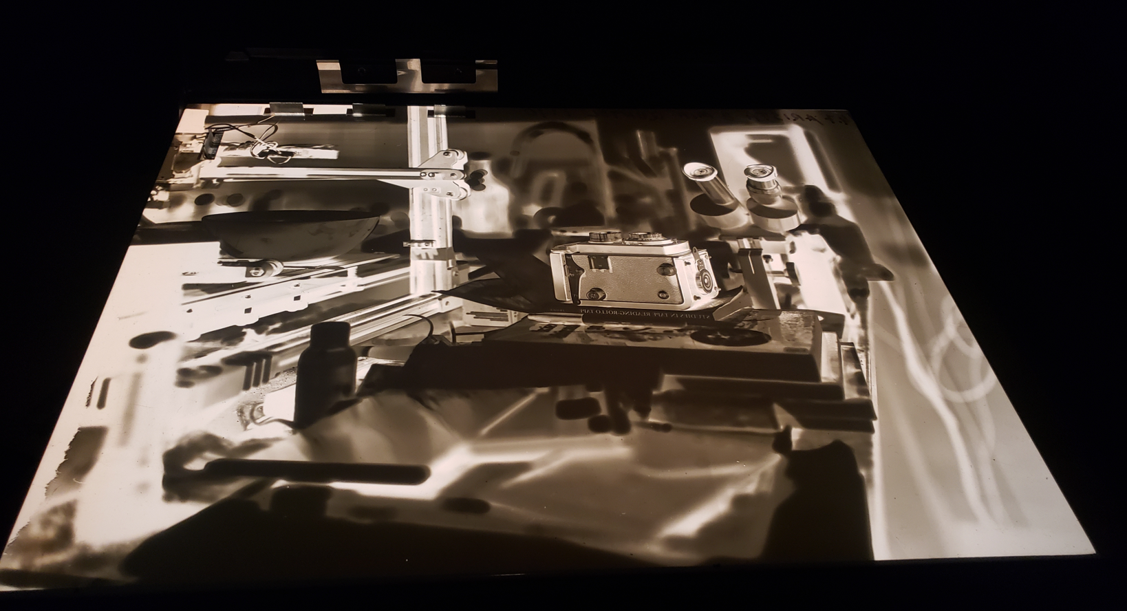

the 135mm lens that came with the bundle provides a pretty good coverage for a 4x5 neg, in terms of light intensity
the 135 lens appears to be sharp throughout for a 4x5 negative; Rodenstock Omegaron 135mm f4.5
But I will need a 4x5 negative that is more sharp all across for a proper evaluation of the 135mm lens.

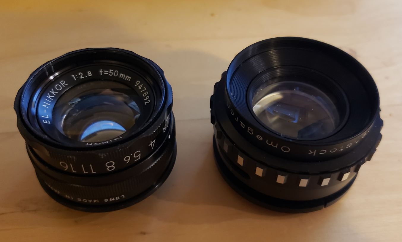

What is clear for sure is that for a 35m negative, 80mm and 135mm lenses produce a sharper image across the field compared to 50mm lens.
The 50mm lens is more sensitive to enlarger misalignment and film buckling

Before I found an APO Rodagon 50mm lens for five bucks at a flea market, my favorite 50mm lens was an Omegaron.

The 50mm lens I had on the Besseler23 was difficult to get sharp enlargements with, so it was a bit disappointing to be honest.

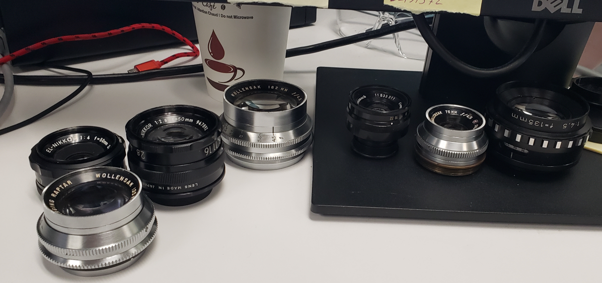

With all the stuff I bought recently I now have a bunch of lenses spanning from 50 to 162mm. Also a 190mm coming and couple of soviet ones.
A bit too many, but I will test and keep what I like and Ebay-out the rest of them.

Thanks for the link. Looks like all the lenses I have are of the 3-4 element type. Wonder what a 6 element can do in terms of sharpness. One of the reasons I want to get the best lens is to do a YouTube video on the resolution limits of a 35mm film vs. full frame digital camera. I estimated that with a 35mm camera and a document/line film, you can get at least 100Megapixel digital-equivalent image resolution. The lens I had on the Besseler would not produce this detail on the enlarger, but when the negative was viewed in a backlit microscope, it showed all the details I wanted to see. But the Besseler enlarger blurred it out.

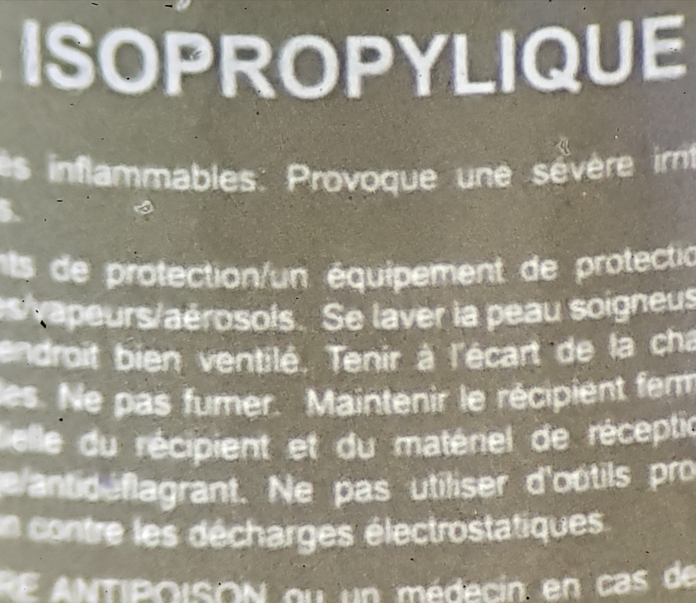

Line film under microscope, its a view of a text on an isopropyl alcohol bottle, sitting on my kitchen counter.

View of the bottle from that 35mm negative on a sheet of expired 8x10 paper.
The film is very fine grain but also very high-contrast and difficult to control. But with post-flashing and a low contrast developer it can behave somewhat like regular ortho film.
The shot below had no post-flashing, only low contrast developer. With flashing it would have showed more detail in the shadows.
Zoomed view of the bottle text. The view is a bit blurry I think because the film was bucking from the heat. I was turning the enlarger (Besseler, not Omega) on/off when focusing and placing paper. The film had time to cool down and it popped/buckled on a different side when the lamp was turned on again for exposure.
