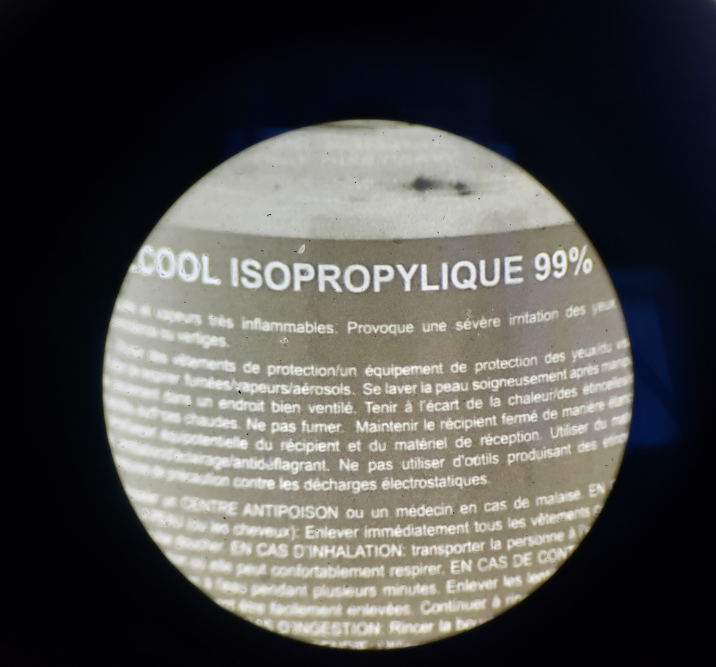

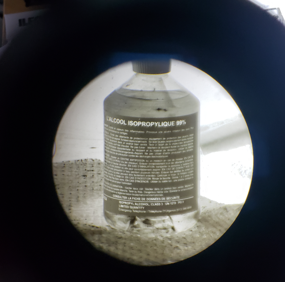

Bottle in the eye-loupe (35mm negative)
bottle in the microscope eyepiece
"35mm" negative. Actually I cut it out from 4x5 sheet and shoved it in the back of an old Leica.
You can see the bottle on the counter, in the negative, the text is on that bottle.

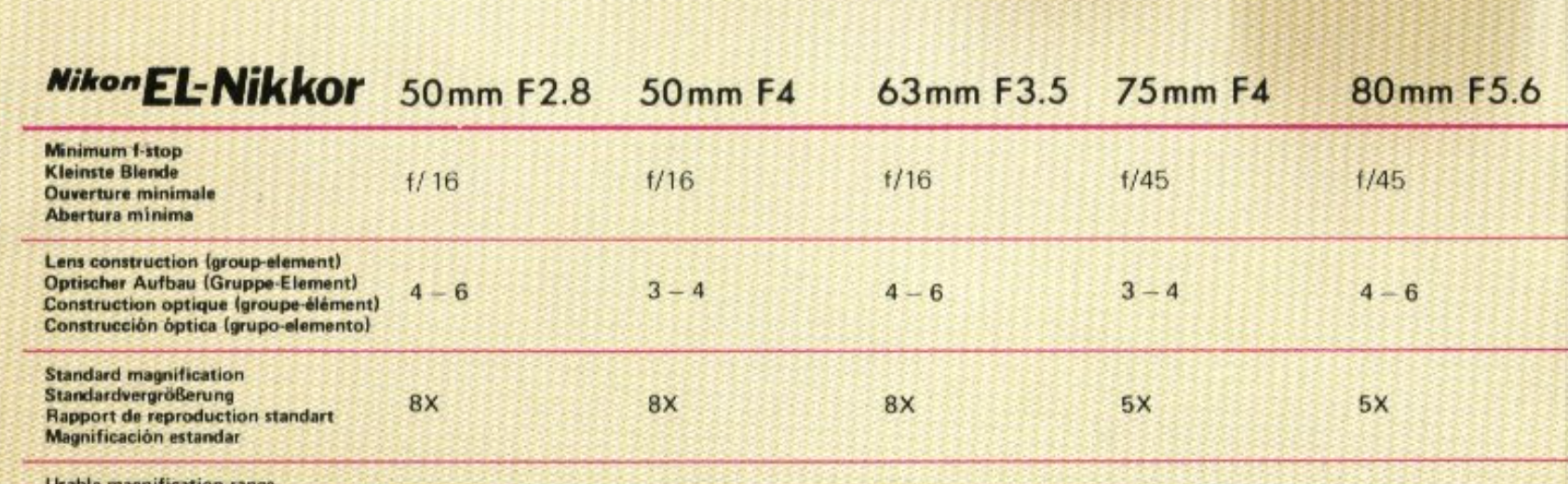

El-Nikkor (name does not distinguish 6-element lenses) see below. Note how the 6 element lenses can give higher magnification as mentioned in my prior post:

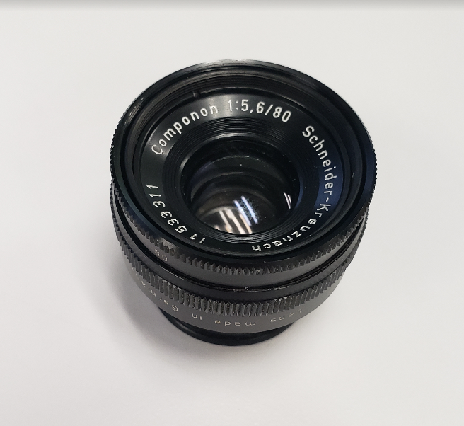

the small 80mm lens that came with Omega D is Componon.
Much better image than my Nikon 50mm, but part of this could be due to focal length.

EL-Nikkor 50/2.8 is rated up to 8x and they are correct. It is challenging making a 16x20 from 35mm, the lens has to be centered perfectly and negative held flat in glass.

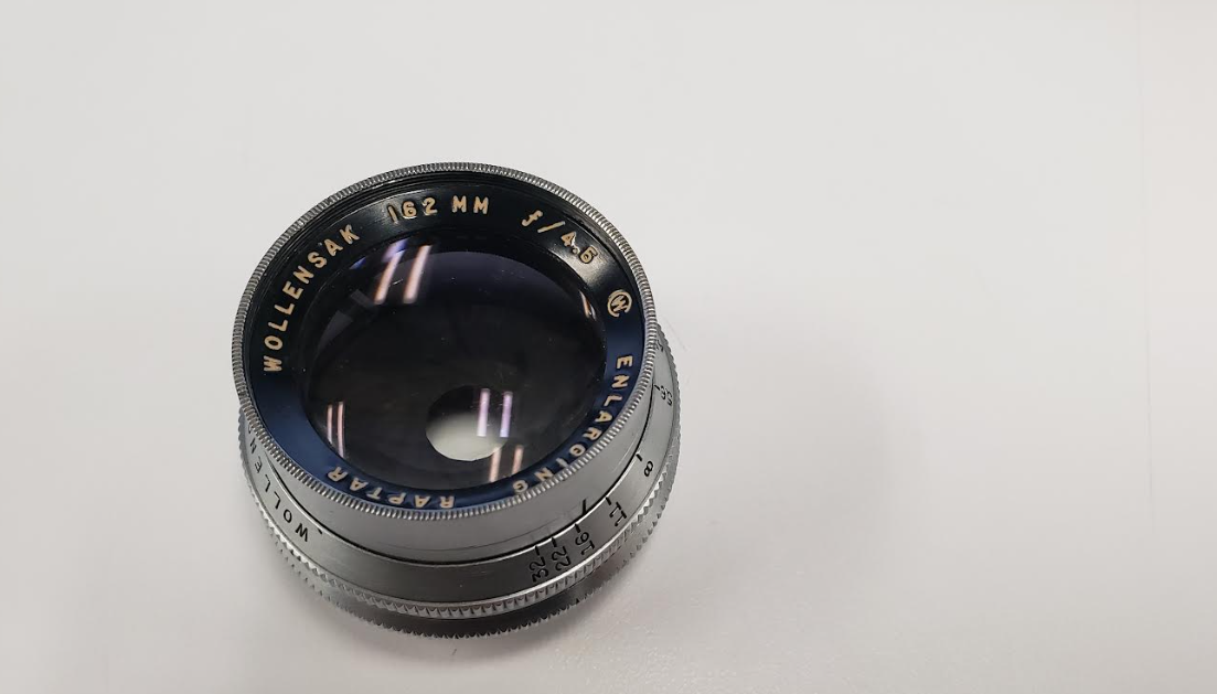

What brands do you guys use? Yesterday tried the 80mm Componon on a 4x5, and the illumination appeared even, not sure about the focus. The 75mm 4-element Wollensak started to produce distortion. No I will not use 80mm Componon for 4x5, but just as a demonstration I think because it's a 6 element design, it can do more than 4-element.

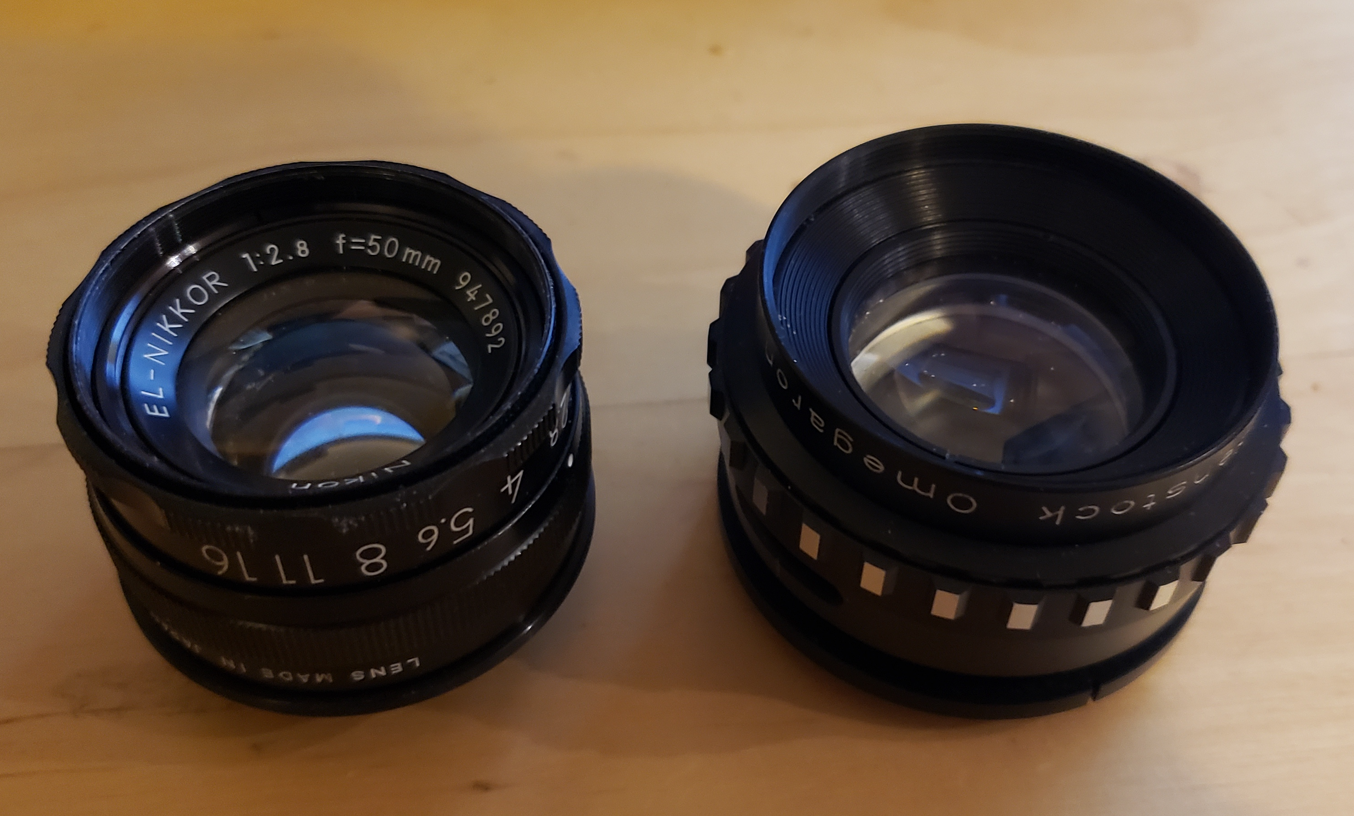

I have these two guys in transit:
and a 4-element
the 135 lens appears to be sharp throughout for a 4x5 negative; Rodenstock Omegaron 135mm f4.5
But I will need a 4x5 negative that is more sharp all across for a proper evaluation of the 135mm lens.
What is clear for sure is that for a 35m negative, 80mm and 135mm lenses produce a sharper image across the field compared to 50mm lens.
The 50mm lens is more sensitive to enlarger misalignment and film buckling
